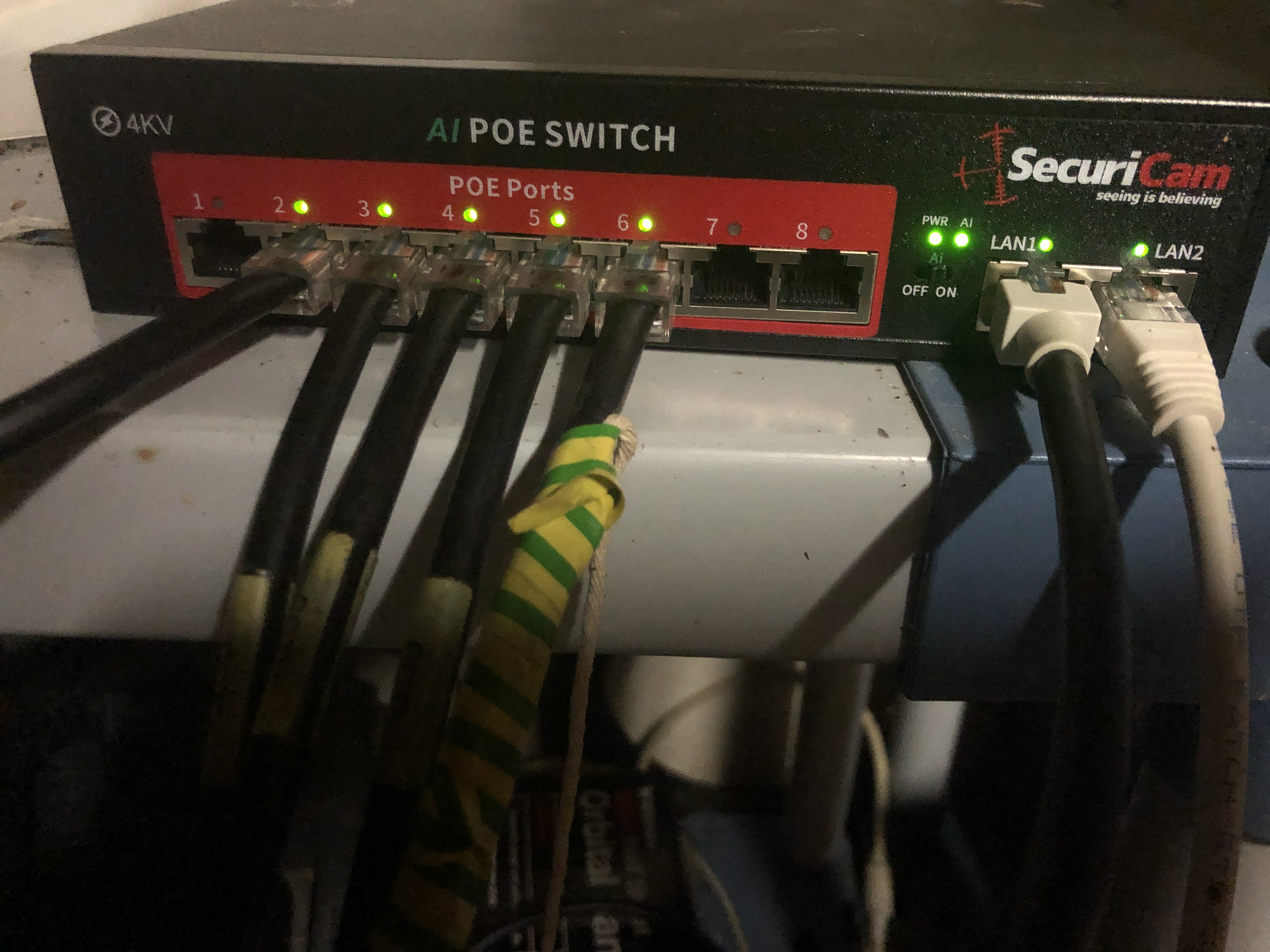

Thanks for your reply! If I swap one of the directly plugged in cameras into the port which isn’t working / lighting up for the PoE one, it works fine. So that would suggest it’s not the port itself.
The network cable, I believe, runs direct to the PoE switch. Into that switch there is a TP Link Deco router / extender which is “broadcasting” wifi fine, so that would imply there’s no issue with a connection down to the garage.
Attached photo is of the switch showing all the ports lighting up

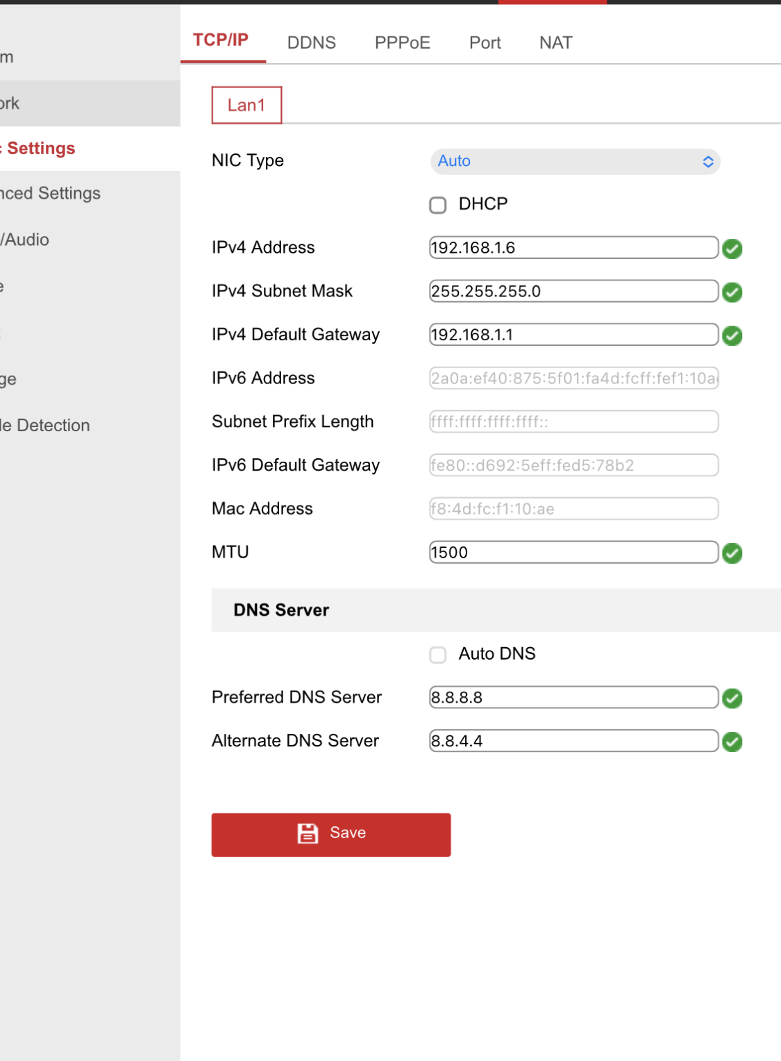

Can you please share a screenshot/photo of the NVR network settings?
Hi @Chip
Cheers, Dan. Please see attached (I’m never sure what I should / shouldn’t share or blank out, so let me know if I need to redact anything!)

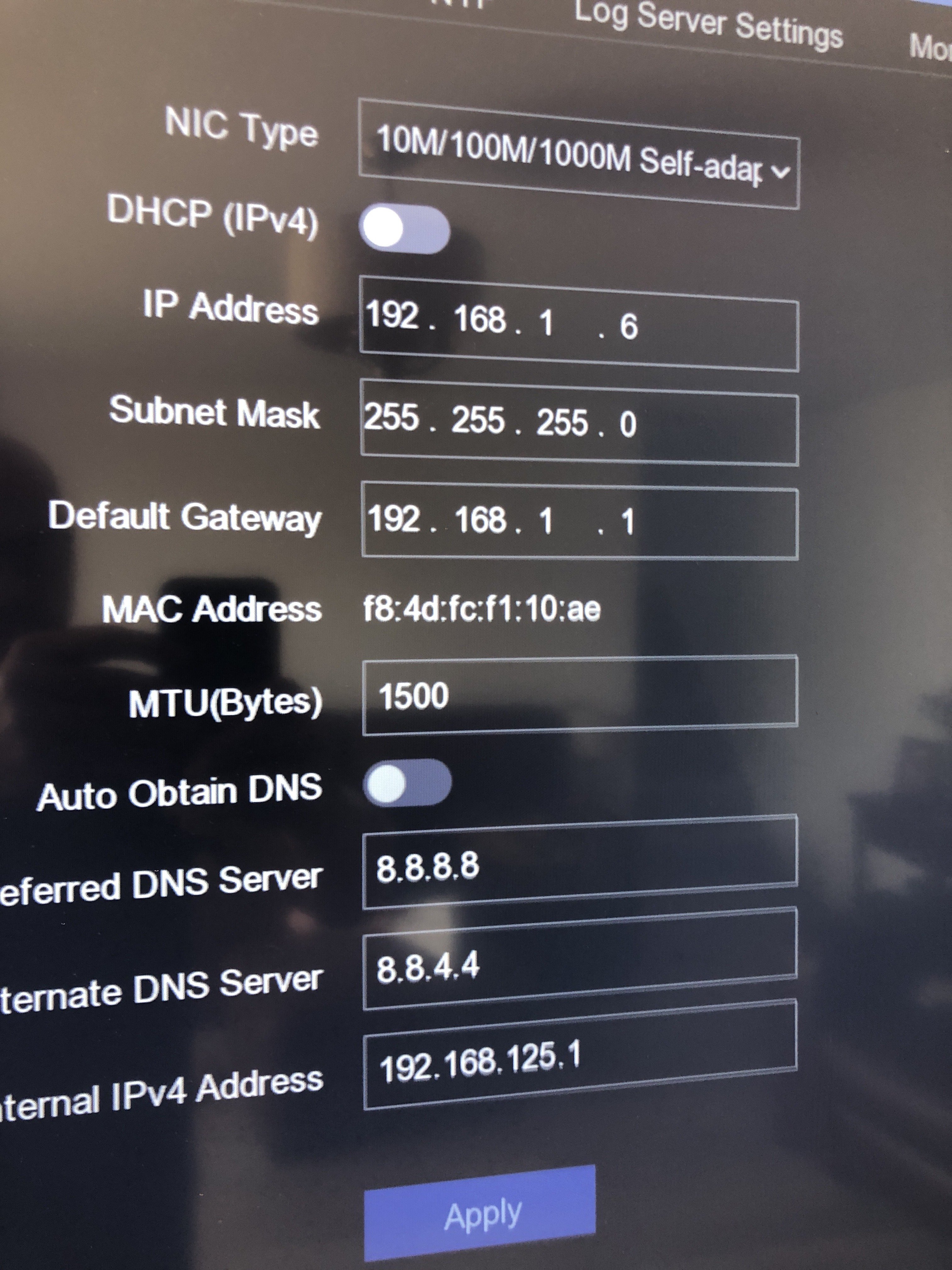

It's strange that you have a PoE NVR, but there are no details in the network settings for the "Internal network card IPv4 address" which is the IP address range used by the directly connected cameras (which is usually different from your local network IP range), are you accessing the NVR remotely or from the same local network as the NVR?
This is the screen from the VGA/HDMI

So your NVRs internal PoE port IP range is different to your local IP range, this makes it unlikely that the cause of the problem is an ISP/network issue.
If your local network range were to change when you changed your ISP this would only impact the cameras NOT directly connected to the NVR and the cameras directly connected should still function fine because they are assigned IP address from that internal IP range (192.168.125.xxx) would still be the same after changing your ISP.

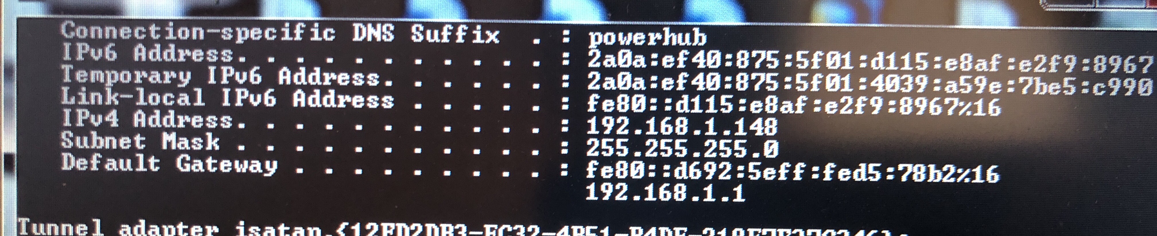

I’ve checked the IP range and it’s now 192.168.115.1 - .189
So am I right in thinking that I need to change the IP addresses for the 5 cameras via the VGA/HDMI settings to any free IP address within the range (I can ping them on my laptop to check)?

Yes, so you will need to open Hikvision's SADP Tool on a PC/Mac on the same network as the remote PoE switch cameras and then use that tool to change the IP addresses of each camera to match the new local network range (e.g. if your cameras set to 192.168.1.3 / 192.168.1.4 / etc... you can just change them to 192.168.115.3 / 192.168.115.4 / etc... and they should be back on the local network).
What's strange is that your NVR still seems to be set to the old local network range (192.168.1.6) but based on those browser screenshots you sent earlier you are still able to login to NVR from the new local network IP range.
Do you have any andvanced network set up? (e.g. VPN, dual networks, etc...)

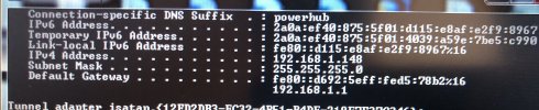

Connected into the main ISP router we have an AMPLIFI mesh system. I was connected to this earlier (in the house) when I ran the ipconfig
However, having gone down the garage to open the SADP tool, I connected my laptop to the PoE switch and ran ipconfig again. This time i got the attached IP info. I then plugged my laptop directly into the NVR and I then got the (same) attached IP info - which clearly differs from what my laptop showed when connected to the main wifi network (I believe that both the NVR and PoE switch run directly from the ISP main router)
So I’m not sure where this leaves us now…. Any further suggestions are very gratefully received and apologies for the confusion
