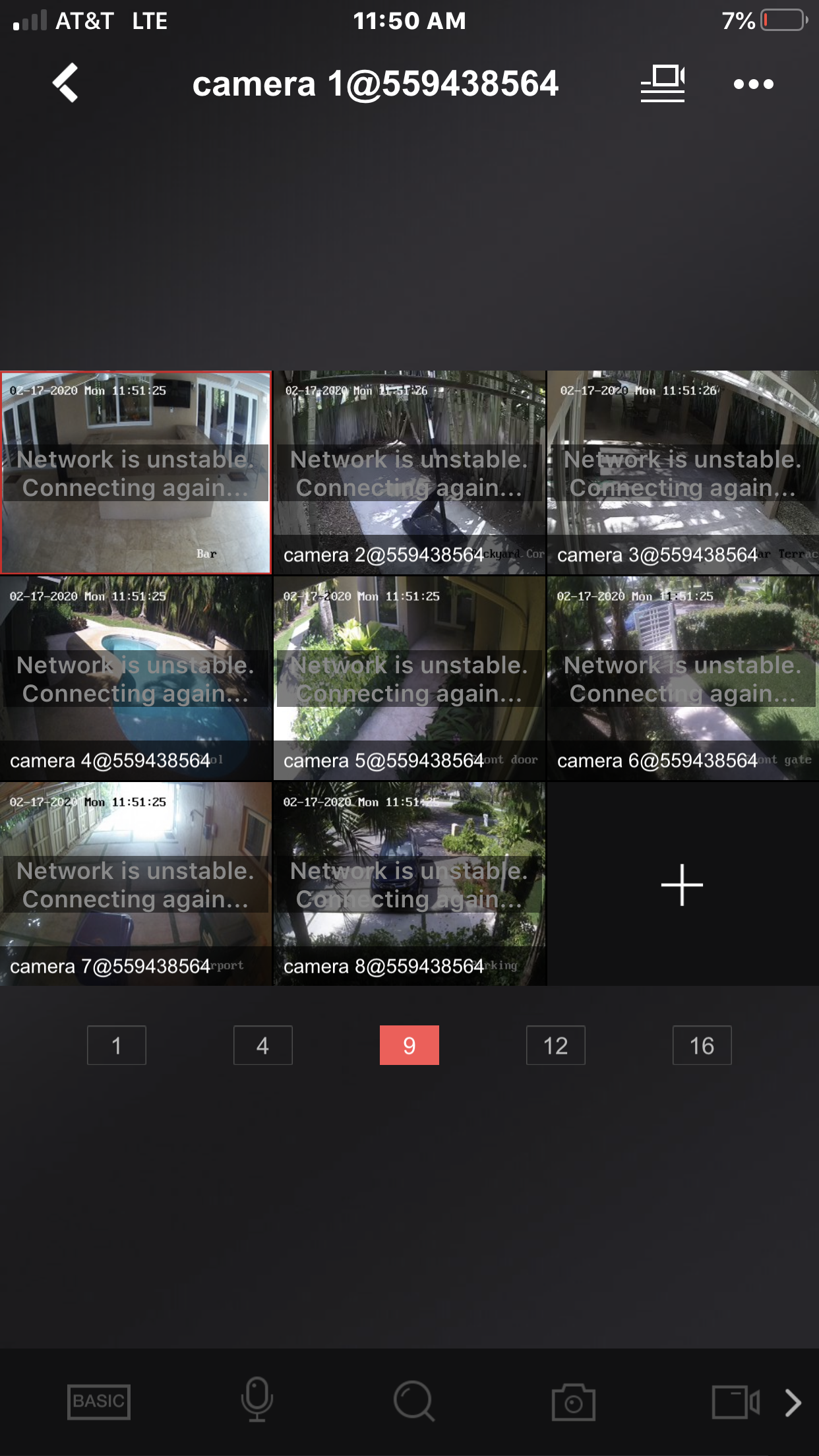

Where I am having an issue is seeing the cameras on the Hik Connect app on my iphone when I am OUTSIDE of my wifi.
The app works amazing on my WIFI at home, it's almost real time. And yes, the device shows ONLINE on the hik connect website.
When I step out of Wifi range and the LTE on my phone kicks in, that's where the app fails.
Gives me a "network unstable" error, and the cameras show a percentage counter rising before they just fail to show an image.

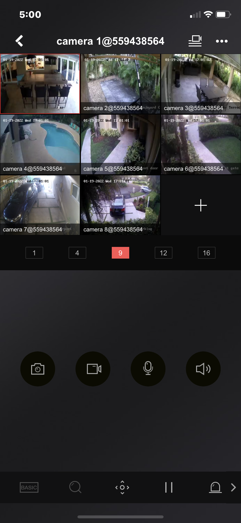

here are two app screenshots... one on WIFI, then the other switched to LTE.

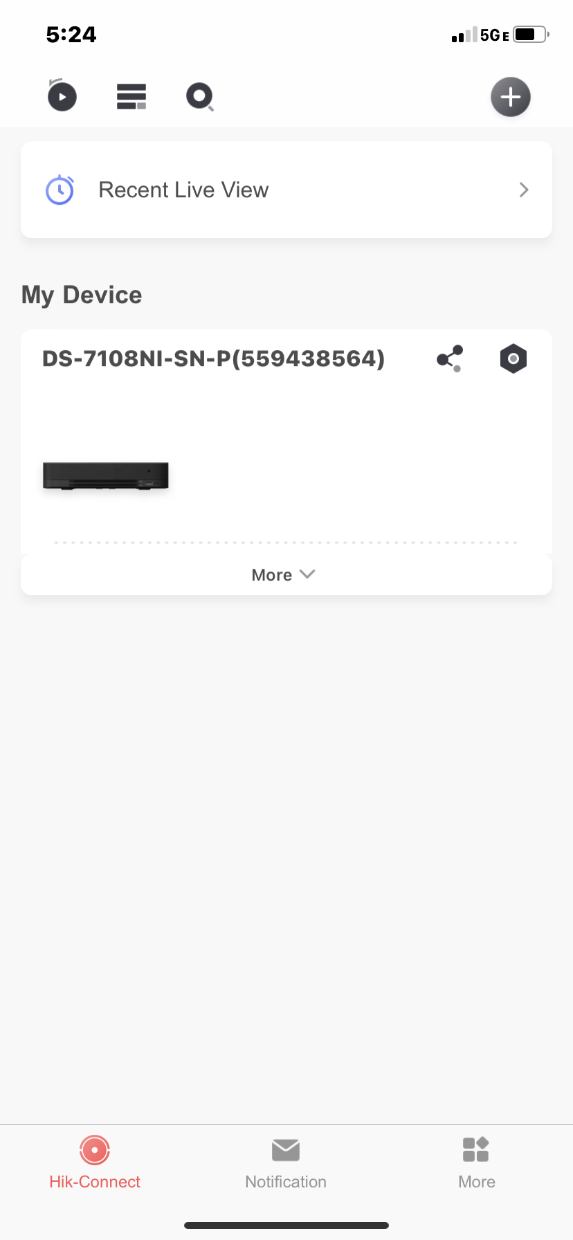

Cannot see on mobile, only when my phone is on the same wifi as the hikvision server. Once i leave my house, i cannot access remotely on phone.
Hikconnect shows ONLINE.
My server is a DS-7108NI-SN/P
it has 8 cameras plugged into it.
It is hardwired into my router
When I am on wifi on my iphone, I can see the cameras via the hikvision app.
When I step out of wi-fi and into 4g/5g mobile service, I can no longer see the cameras.
Again, hikconnect shows ONLINE.
Help me please!
