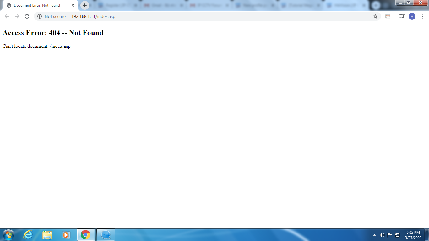

Every time i try to login it still says that the index.asp or what not can't be found

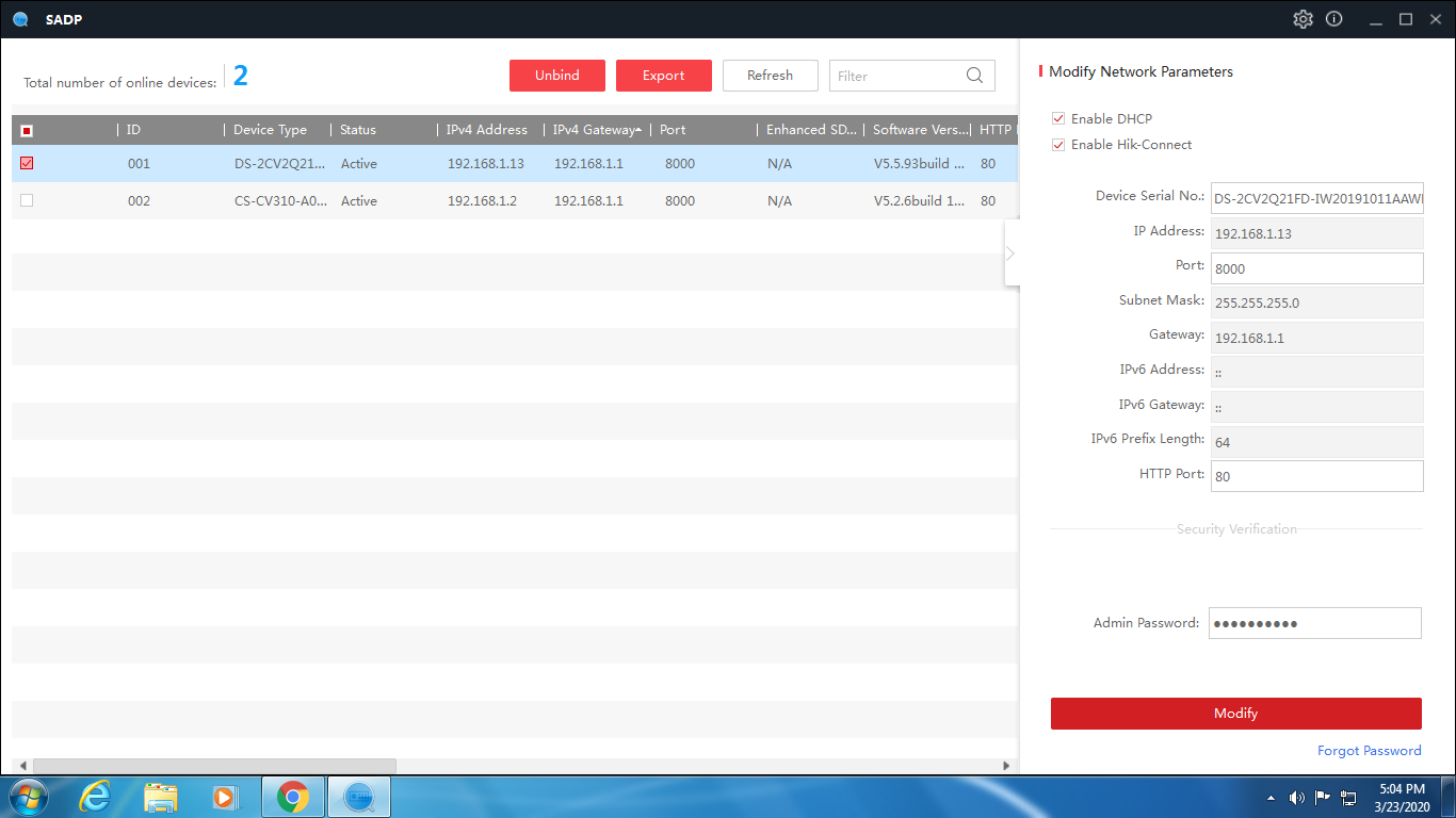

i'm just trying to change the wifi password in its save because its diffrent now and this kkeeps happening!!!!1584957922163.png
Have you tried browsing to the IP addresses using Internet Explorer? Do you get the same error message?
Yes i have and the same thing came up on me. Its like the Camera just went rogue and disabled it self

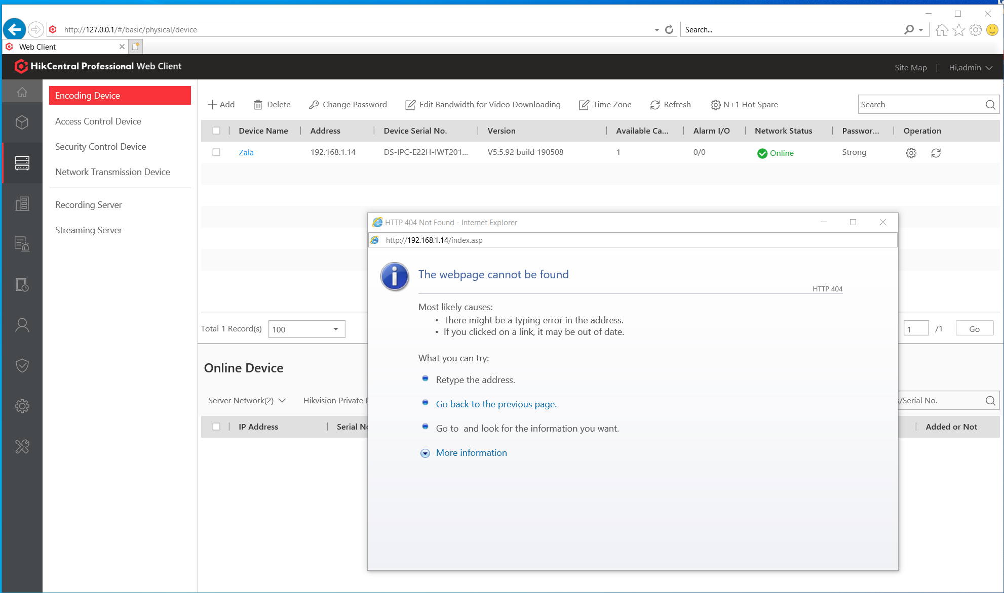

The IP address in the browser's address bar in your second image is not one shown in SADP in your first image?
I did do a hard reset and it did not work, also the IP is different because of the "modify" in SADP and i also used the original one before that via refresh but the error 404 still happens, please help
Please Post here a refreshed view of what the SADP table now shows.

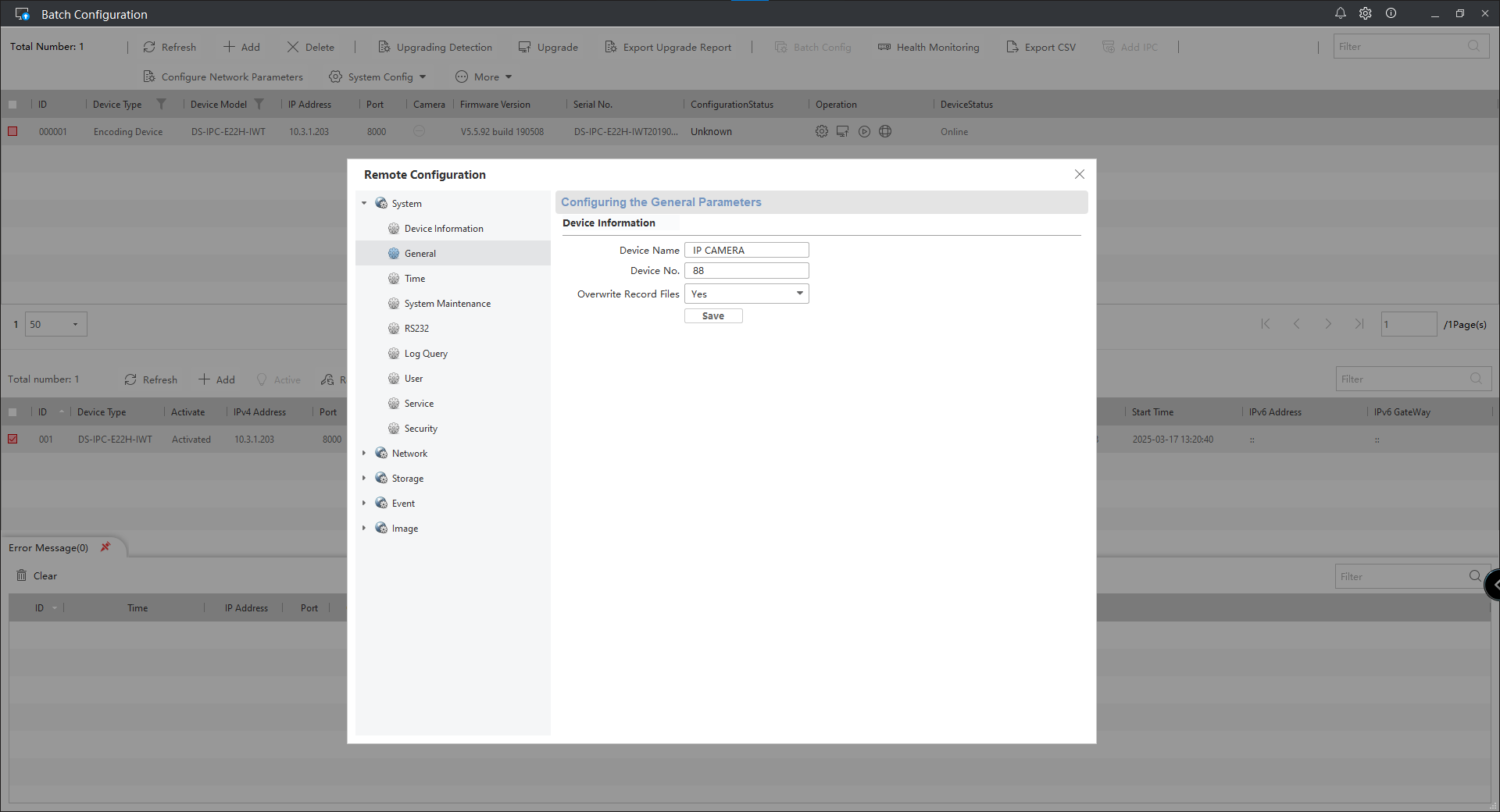

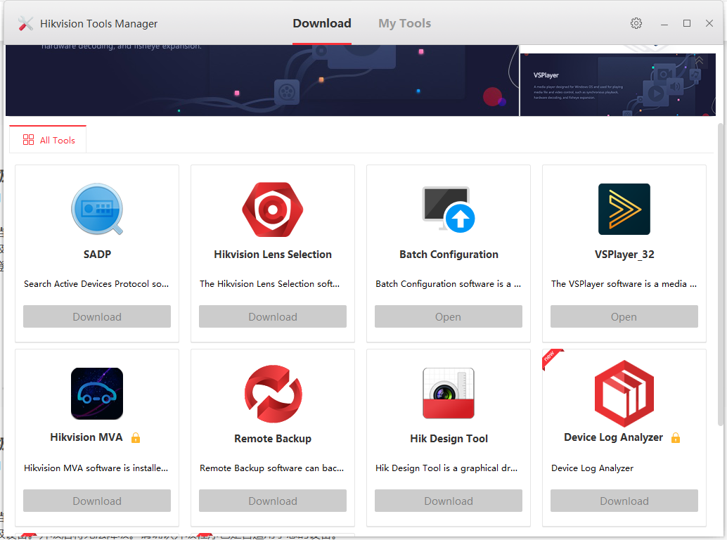

Only solution to my DS-IPC-E22H-IWT working was to use Apps from Hikvision Tools Manager.
screenshot-2025-03-20-151746-png.12674
For example "Batch Configuration" tool to setup device and change some settings init. "VSPlayer_32" to see live feed from camera. ( you can see live video feed rom "Batch Configuraion")
