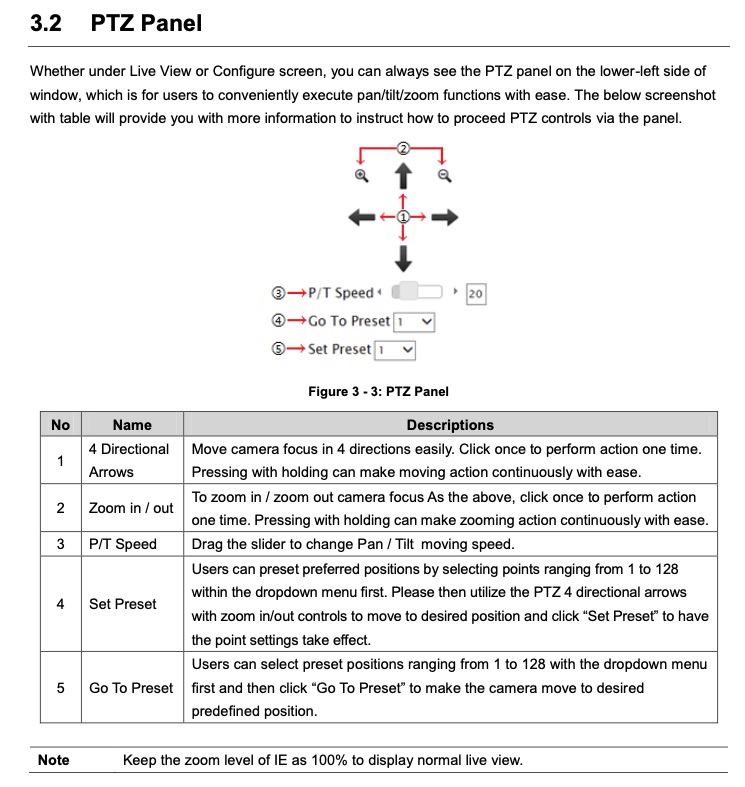

Hi @ahmedabdulla - what is the brand and model number of the camera, as these settings will vary with each camera?
The PTZs we've supplied normally stay in a fixed position as default until you manually move them.
To move automatically between presets, the camera will probably have needed something called 'patrol', 'scan' or 'pattern' enabled - maybe have a look for a setting called something like this and turn it off, which should keep it fixed.

Thx for your replay . Attached is snapshot of the manual of PTZ Camera related to our topic. The vendor is Messoa and the part number is SPD970.
Which setting should be done to make PTZ camera in a fixed position ?
