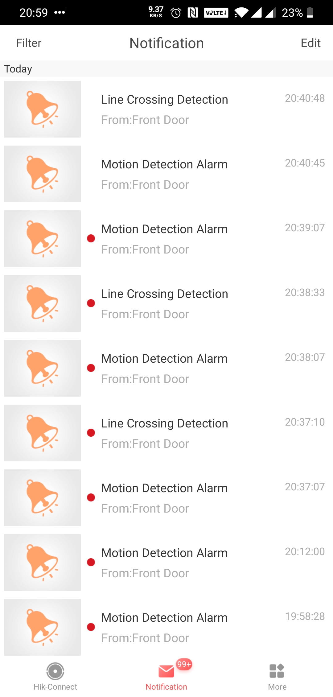

I wouldn't say the road is that busy, but I have a suspicion during the night when a cars headlights hit my driveway this causes the line intrusion and motion detection to be activated.

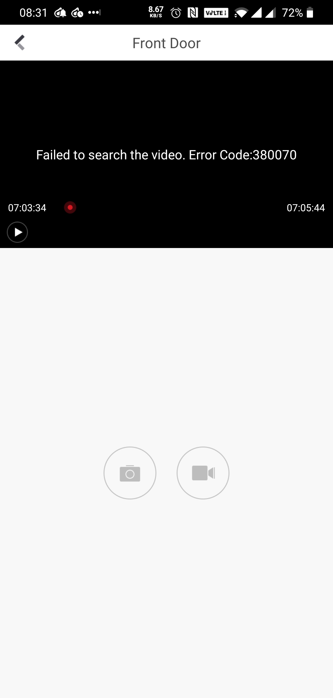

Furthermore, I am getting an error message (Please see attached). One final point, I have had few instances where someone has come on to the driveway and I didn't receive a push notification for this? I've even increased the sensitivity.
Edit- I've tried using the play back on the NVR and it says "No Video found"

ok, so the changing length of the event notifications is probably just down to repeated triggers extending the length of each notification. (e.g. if the event is triggered multiple times very close together they will all be clumped together into one notification) When you are actually recording by event you can set a pre/post record time to try and limit the duration of each event recording, but the same cannot be done for event notifications.
The only way to reduce the length of these notifications is to play around with the event settings to reduce how frequently the events are being triggered.
In regards to the 'No Video' error, Do you see this on all the cameras you have or just one specific model? If it is just one model which model is it?

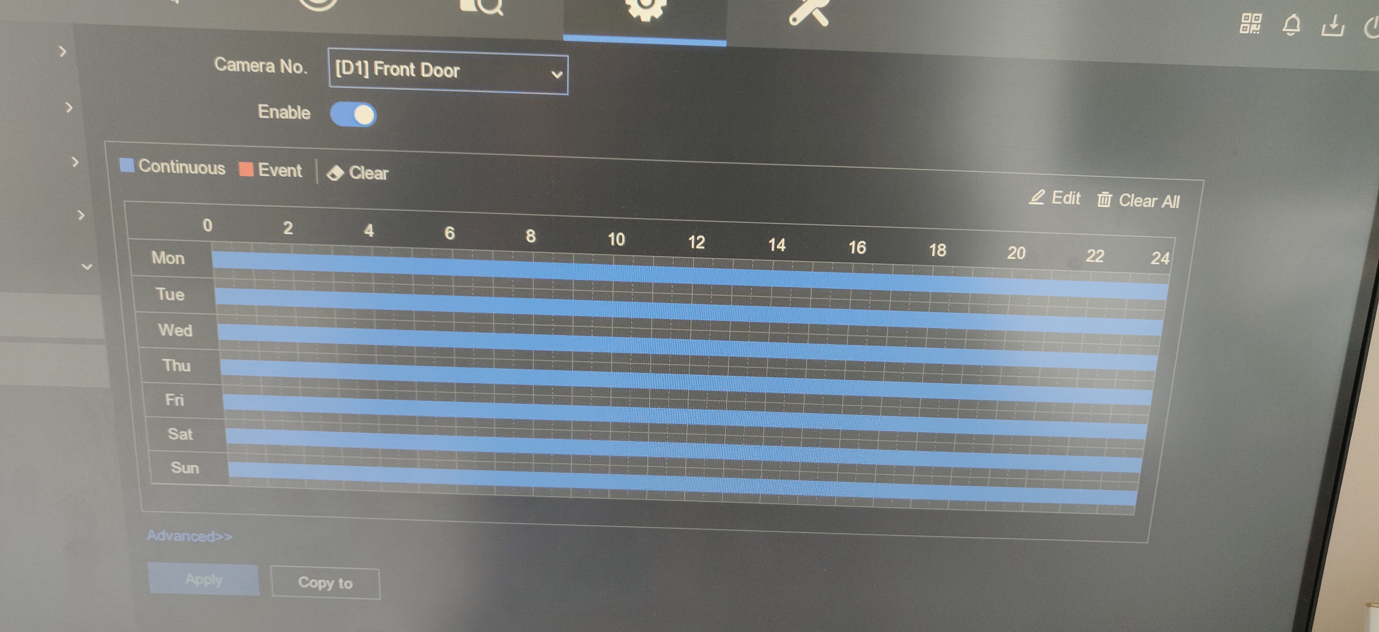

How do you have the recording schedule for the problem camera set? Continuous, motion, event, or something else? (can you send us a screenshot of the recording schedule for the problem camera)

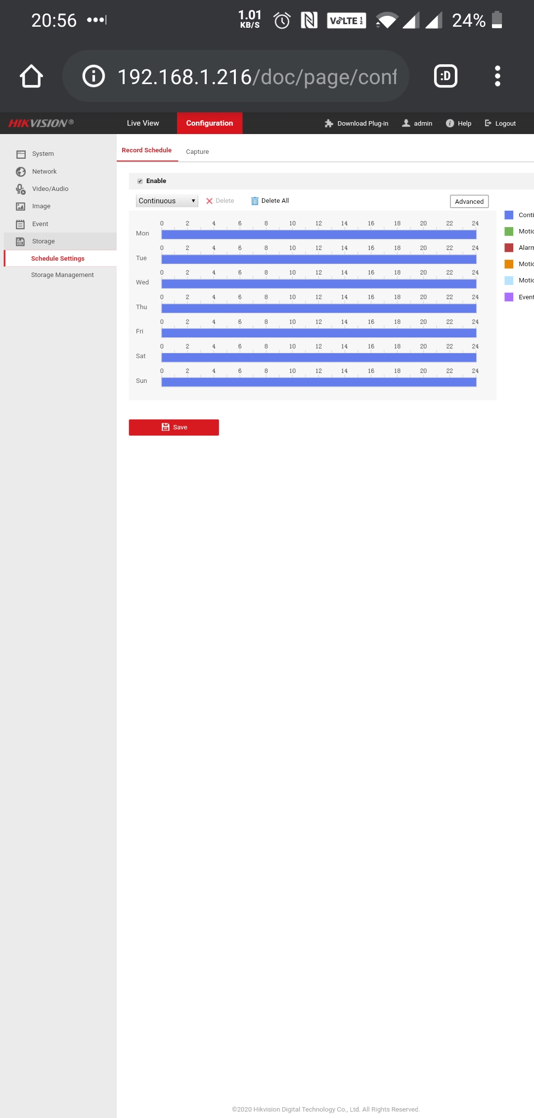

At the moment I only have the hikvision ds-2cd2555fwd-i mini dome. I've noticed sometimes it played the video once the event has been triggered and other times it fails to do so. In the even when an error message comes up I am unable to view live view from the HikConnect app. The recording schedule is on Continuous at the moment. (please see attached)

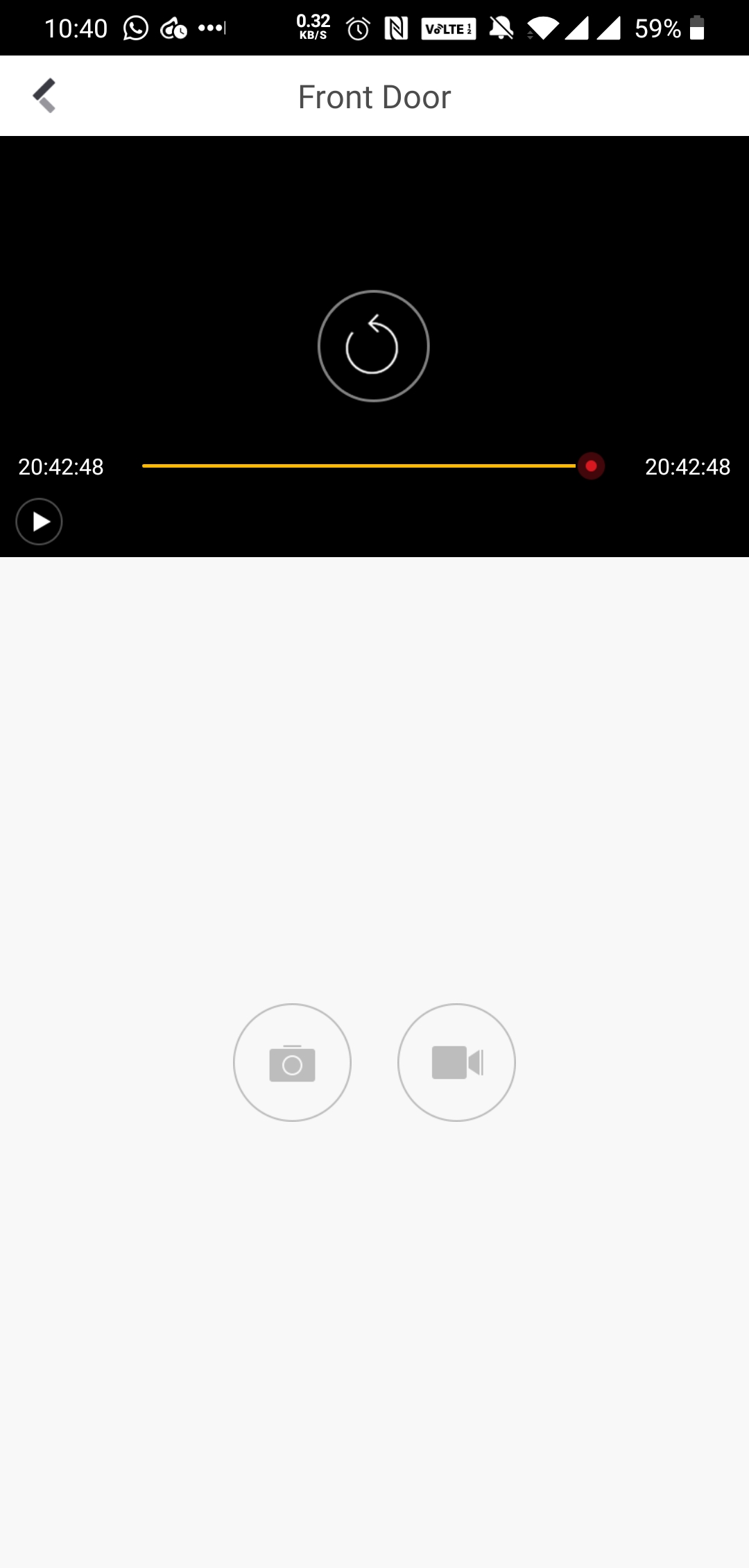

When the video is unable to play back, the thumbnails do not appear but a consistent bell is presented suggesting at glance the video will it play before the error message appears. (See attached picture)

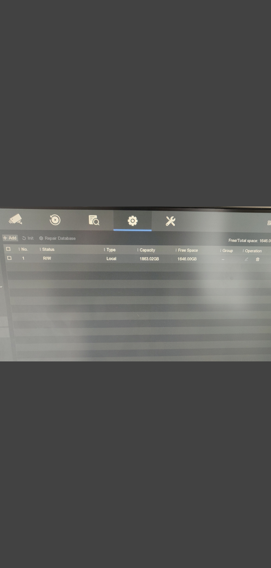

Can you share a screenshot of your HDD management page? (you will find it under Storage > Storage Management)

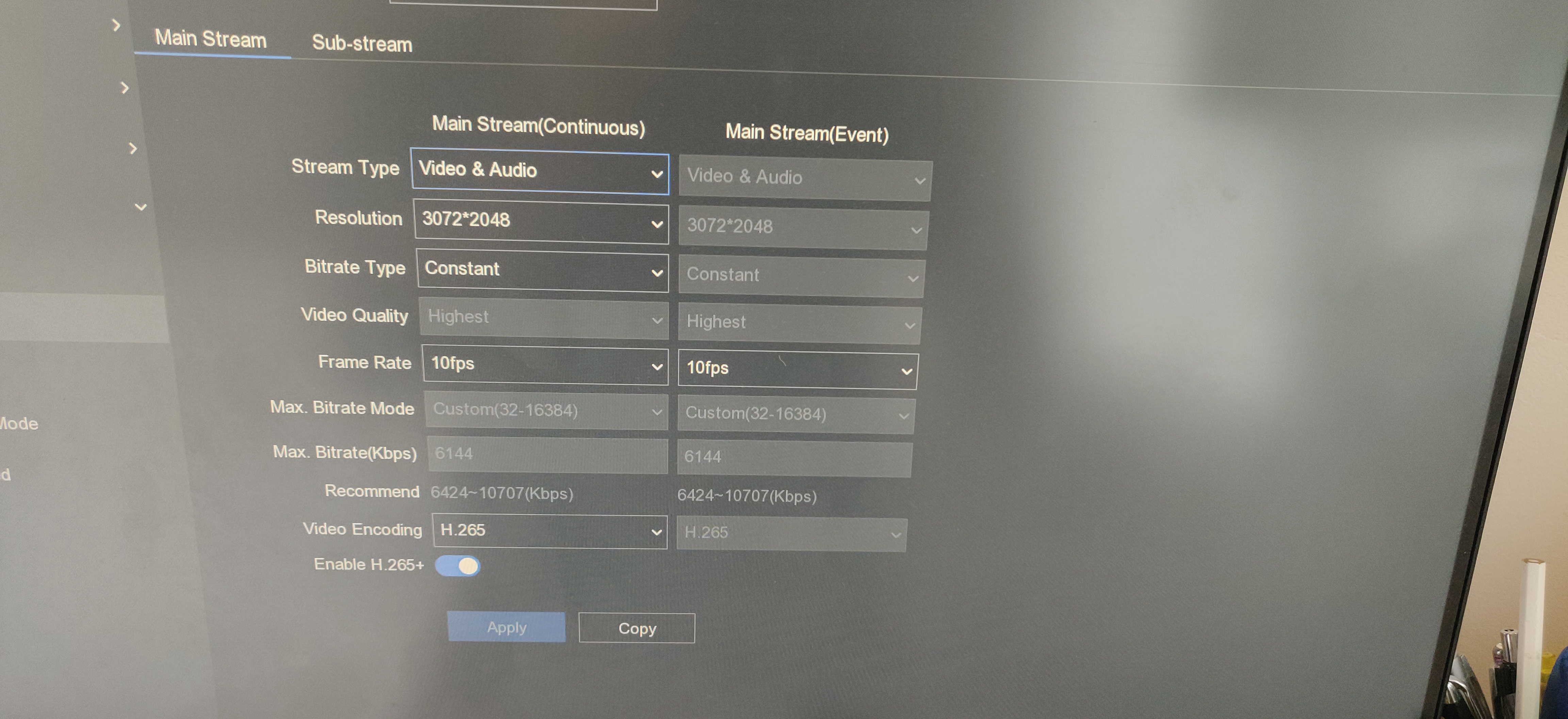

Please see attached (I've added the recording schedule on the NVR and the Streams setup for main stream etc)

Thanks, it seems to be working on the NVR. When I double check that subset of population some are working now, but when press play on some of the others it doesn't play and has the refresh button appearing.

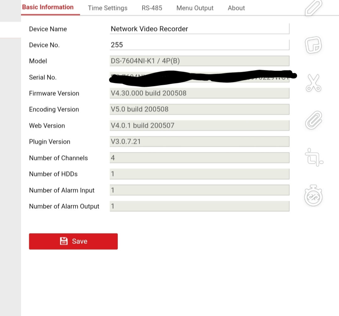

Can you confirm the exact firmware your 7604(B) NVR is currently using?
Hey
Thank you for looking into this Dan.
Please find attached with the requested info.
Regards
