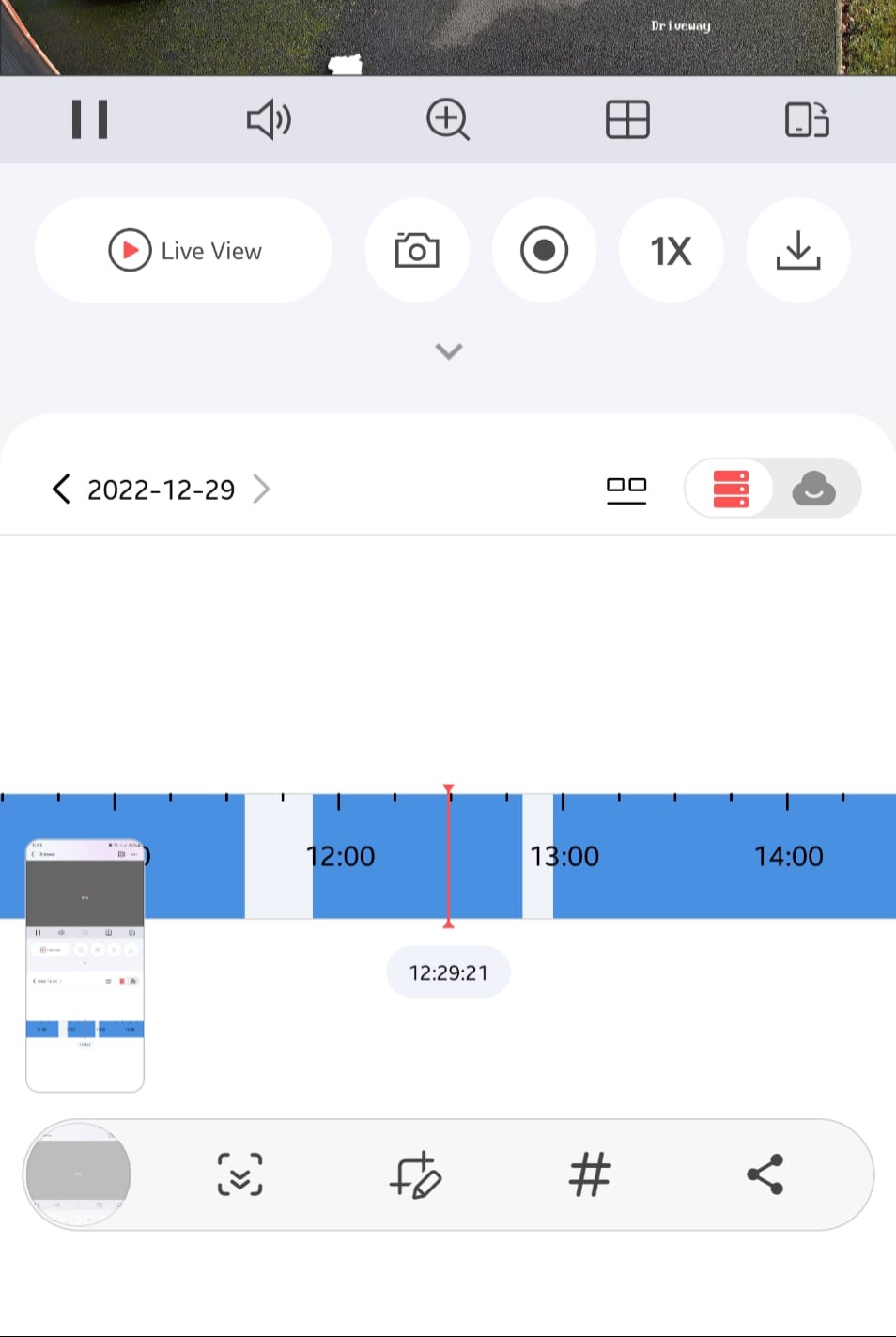

Hi There,
I have a DS-7604NI-K1/4P NVR along with 2 x DS-2CD2347G2-LSU/SL and 1 x DS-2CD2387G2.
The 8mp camera I have an issue where the recording randomly has gaps, as shown in the attached screenshot. I have video loss detection enabled and this doesn't alert at the recording drop out times and the other 2x4MP camera still record fine without issue.
This only happens maybe once a week and is flawless the rest of the time.
Struggling to work out what the issue could be as the video stream doesn't appear to drop out and the other channels record fine.
Any suggestions are appreciated.

Those are looong gaps, not just a few seconds. Have you looked at your logs in the NVR to see if there are power dropouts, network dropouts, etc?

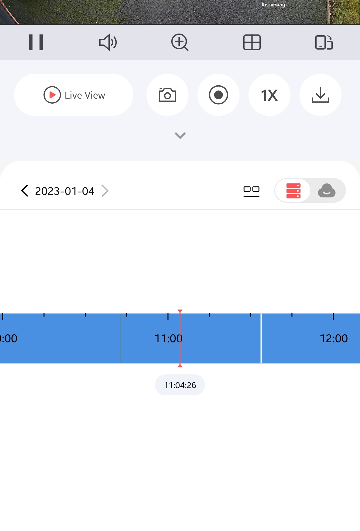

Exactly my thoughts. Logs on the DVR show nothing out of the ordinary network wise, I have the video loss detection enabled and that doesn't alert and other channels on the DVR record fine with 0 gaps. The example I used was quite a large gap, they are usually like the attached, seconds.
I wonder with it being an entry level DVR and having 4 channels in use (1 cheap ONVIF camera) is the fourth whether it's struggling to cope with the 8MP stream as I have it set on the max quality, frame rate etc.
I started out with just this one 8mp camera and don't recall any breakups.

So yes you're correct when I go back to the time before the dropout there is some green pixelation to one side of the image then it jumps over that to the next playable time.
