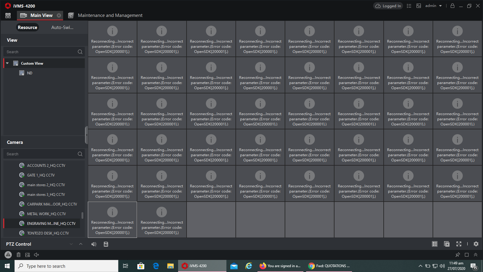

Hi i have some questions that i want to helped with on remote view 4200 ivms
1.Any version of 4200 ivms that is highly recommended for slow internet speed .my internet speed when ok it up 1.6 mbs maxmum?
2.What is the minimum internet speed for you to do remote vewing smoothly without freezing at times ?
3.Any setting that i need resolution ,framerate,maxbitrate any configuration ?
4.What about the pc you using does it matter ?
attached image of 1 of problems faced
FAXON

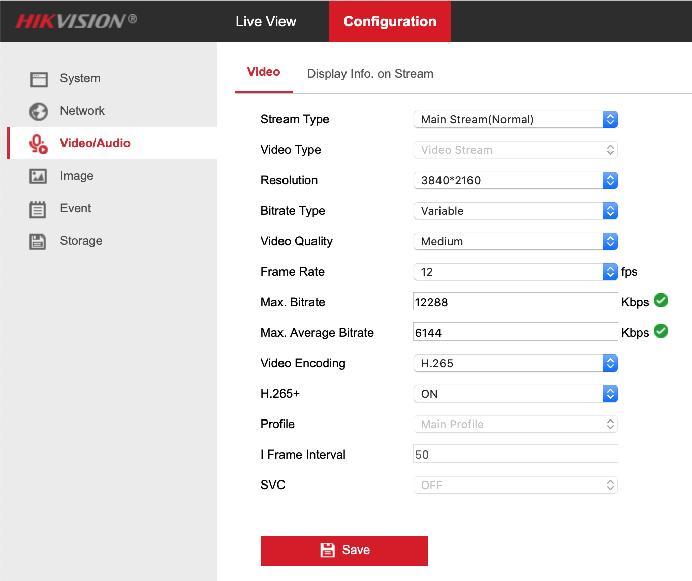

  3. Other recommended settings to help are shown below:
    Use H.265+ wherever possible, reduce the frame rates to 12-15fps, you can drop the resolution and video qualities if need be as well.
    Viewing the substreams should help keep your bandwidth usage down.
