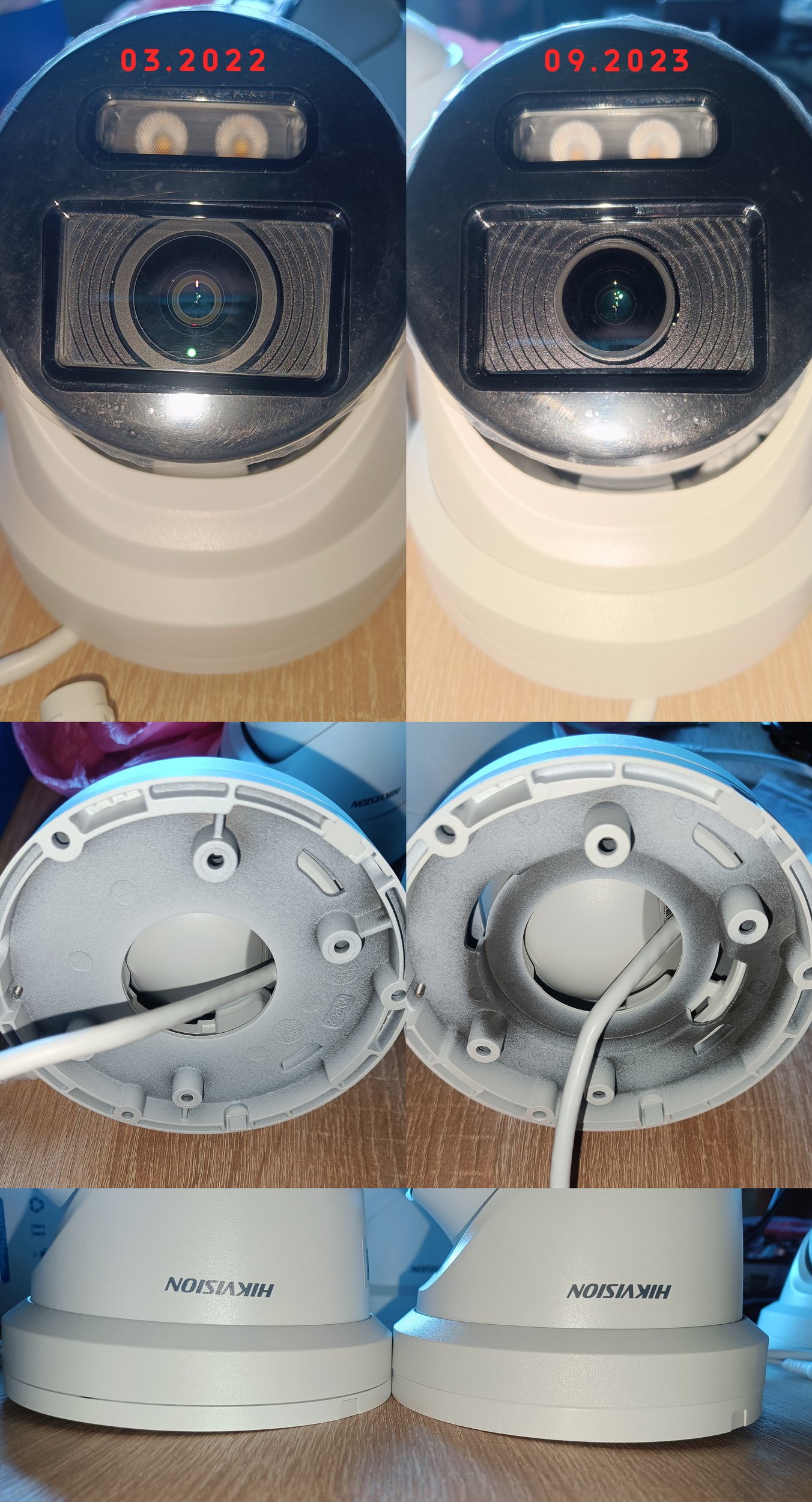

Hi everyone,
I've just received two hikvision ip cameras DS-2CD238-L(2.8MM)C but there are some slight differences between them.
Both cameras have the same model number everything except fabrication date, one is made in 03-2022 and the other one in 09-2023. There are some differences at the lens and at the base.
I've just unboxed them but didn't powered them up/activated them.
My question is if you think the newer one may come with some improvements over the older one as it's one year and a half between them. I've got them locally so I can send the 2022 one back for a replacement easily.
What would you advice me to do? What do you think? Thanks.

The later one looks like it might be one of the deep base models. On some older Hikvision turrets (DS-2CD2325FWD-I as an example) you could just to say fit the cable assembly behind the camera when wall mounting (without a backbox). This wasn't possible on the newer models. However at some point Hikvision were doing an optional deep base variant for the turret cameras that left room again. I've not had one myself but there was a video on the DVS website regarding it.

That means both are (c) version, but a bit different as you can see in the photo. Any thoughts?

In that case, I think it is just as @JB1970 says, they have tweaked the physical design of the cameras to make installation easier and the other subtle differences are only noticeable when you have the models next to each other but these differences don't actually have any significant impact on the performance of the cameras (if they did, Hikvision would have labelled them as different generations and not as both (C) models).
