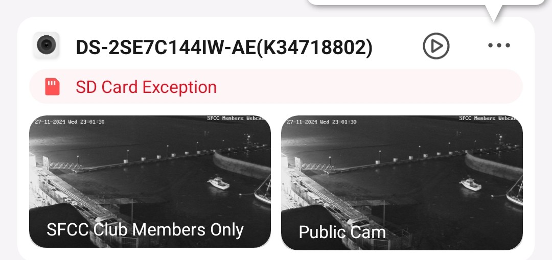

I am looking for a storage solution for my Hikvision model DS-2SE7C144IW-AE(32X/4)(S5) that we use as a webcam for our boating club.

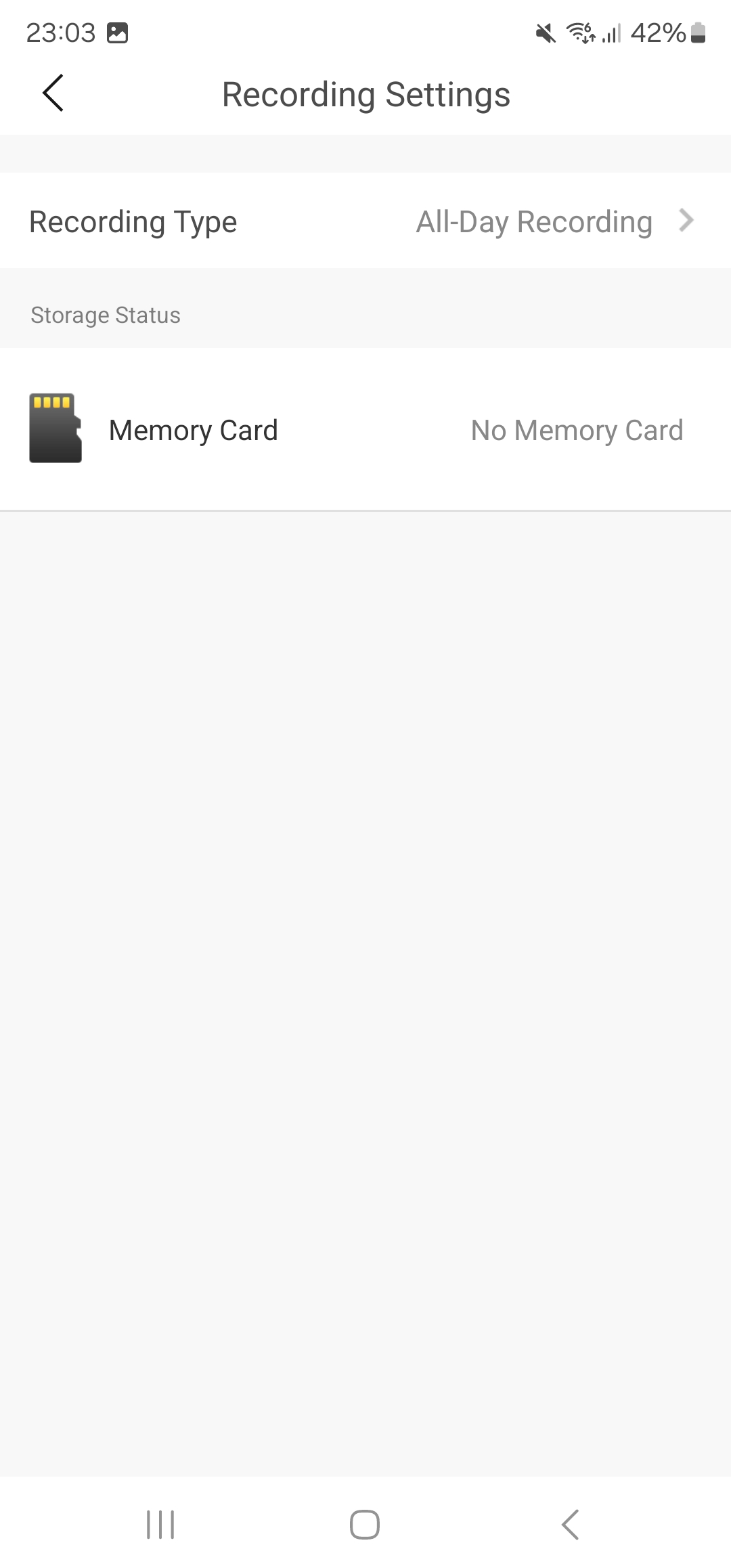

The camera manual says it takes up to 256GB SD Card. Each SD card I try it doesn't even register there is one. It just says "SD Card Exception Error" I tried a lower capacity 128GB card but same response.

So you also can't see the MicroSD card in the camera's storage menu when accessed with a browser?

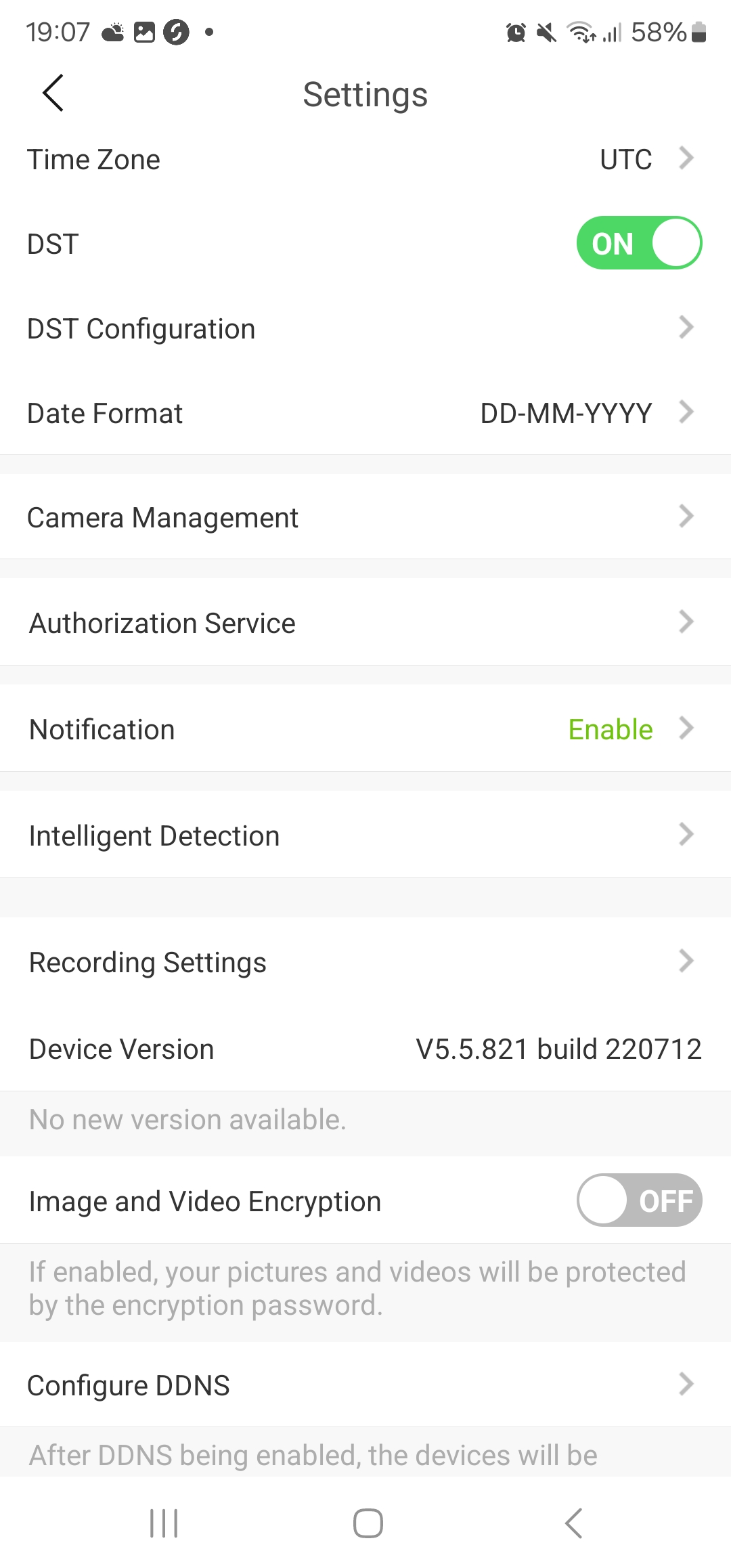

It's the latest available I've done a search.

That does look to be the latest firmware.
Can you please confirm that you have tried formatting the MicroSD when logged into the camera with a browser? (please share a screenshot of what you see in the storage management menu when logged in with a browser)
