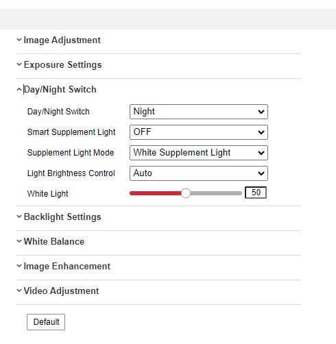

The night LED lights were working before, they were set to Day/Night switch to Auto and they were coming on at night and off in the morning, two nights ago the were off at night and I changed the senility from 4 to 5, then they turned on
The following day, last night the light was off at night so I changed the settings Day/Night switch to Night and the light turned on but this morning the lights were still On
I changed Day/Night switch to Auto and the light went off
I'm not sure why they are not working as before, I have upgraded to the latest hikvision firmware, Firmware_V5.7.13_230706
Any idea? AM I missing anything?

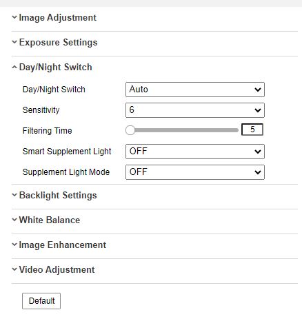

No idea what is the Smart supplement light & supplement light mode for, I had it on before, I turned it off now and set the sensitivity to 6 to see if it works tonight when it gets dark

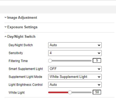

Set:
- Day/Night Mode - Auto (if you set it to day, the lights won't come on)
- Smart Supplement Light - Off (it won't affect your issue either way, it tries to adjust the light output if it's shining off something bright in the centre of the frame)
- Supplement Light Mode - White Supplement Light (if set to off it will never come on, even in 'Night' mode or 'Auto'
The second two of those settings (Smart Supplement Light/Supplement Light Mode) are badly worded so it's hardly surprising it confuses people.
When on Auto Day/Night, the sensitivity just affects how long the camera will try to stay in Day mode before it switches. I'd just leave it set at default

I have set it to default as in the screenshot attached and I will check tonight if the light turns On, that is how I had it before when it stopped working.
