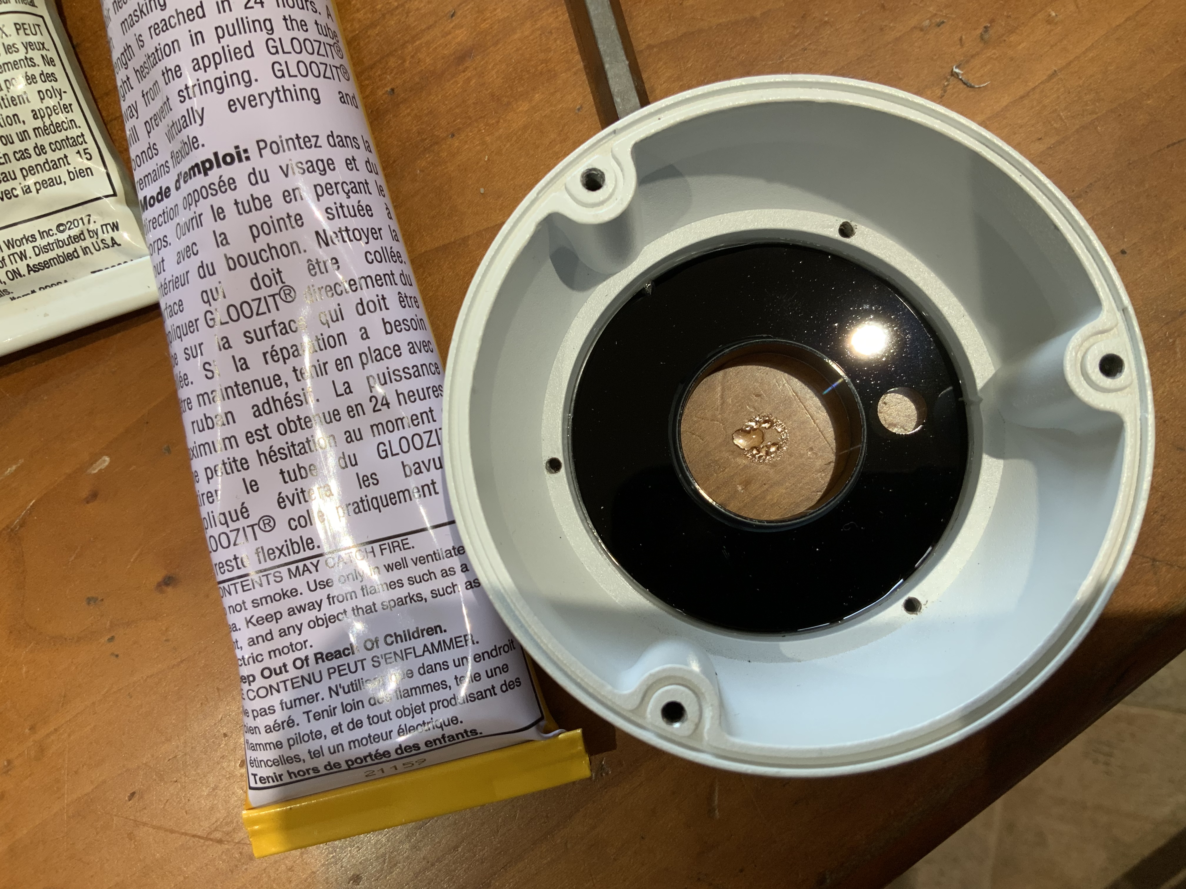

NB: managed to pull one apart that I hadn't put up yet. They're two gram dessicant packs. The packs are clear but don't appear to contain indicator gel. I'm going to just reactivate it - 10 minutes in a microwave defrost ie ~30% power. I've also sealed the glass to the cast aluminum hemisphere. 1.5cm x 5.5cm clear plastic sac
Just as an FYI, i decided all the cameras need sealing.

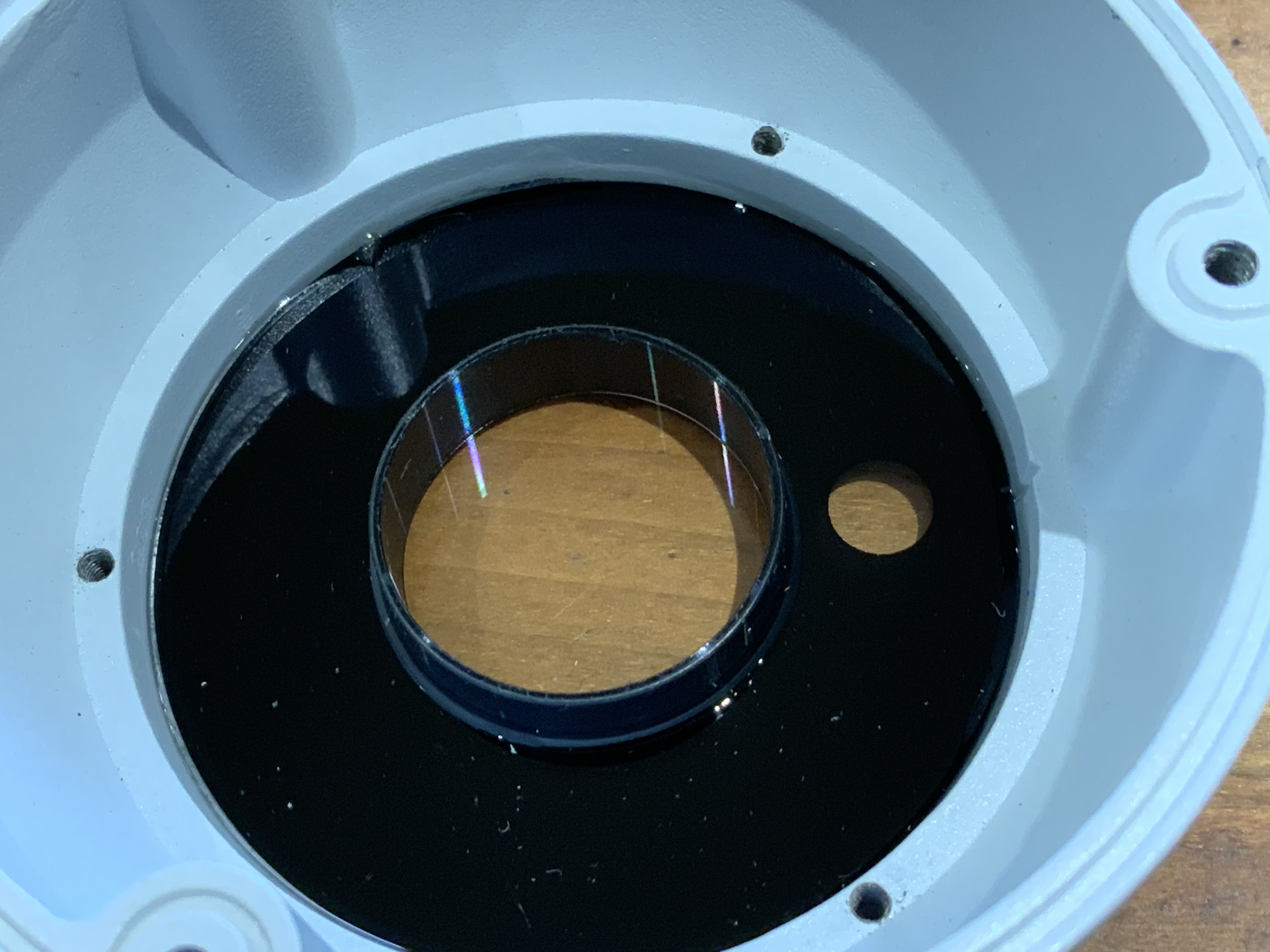

here are pictures of the camera I was ‘hoping’ would clear with time.
the centre of the lens cover had condensation that is clearly visible. The perimeter of the glass is not sealed.
im going to reactivate then silica pack and seal the front ‘glass’ window with polyurethane adhesive and the silicone gasket between hemispheres with dielectric silicone grease.
i also cured the PU in the toaster oven at 200F for 1/2 hr.
I’ll let you know how it goes.
doug
