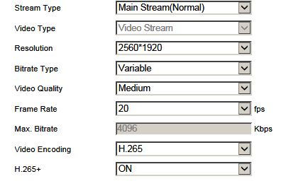

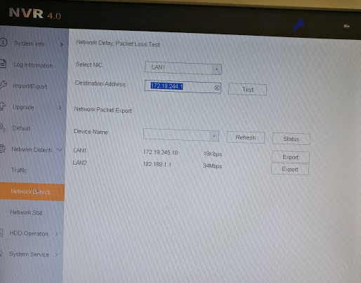

Watching it today...
LAN1 (connection to main network)
Sending: 1500kbps
Receiving: 40kbps
LAN2 (camera dedicated network)
S: 3500kbps
R: 110kbps

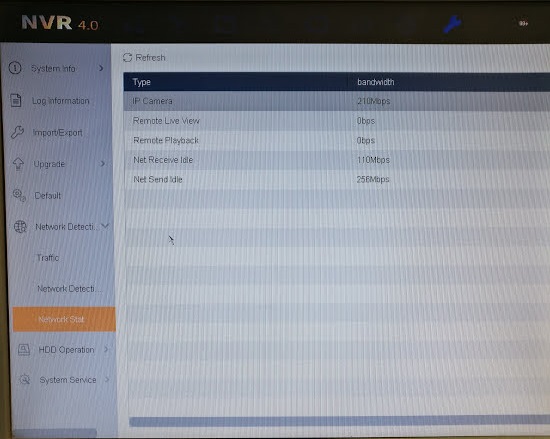

STATS Page:
IP Cameras: 210Mbps
Remote Playback (me monitoring 8 cameras): 9216kbps
Net Receive Idle: 110Mbps
Net Send Idle: 247Mbps

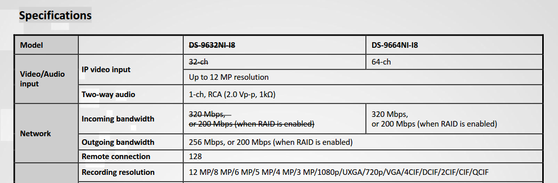

I was asking about RAID because configuring RAID diminishes the bandwidth the NVR can cope with.
Right.. was going to add that I took your comment about RAID the wrong way around! :)
Cameras are set to H.265+
Frame rates are all set as low as we can to be usable for us. For most that 15fps with some set to 20fps.
I've just checked that though and all cameras are now set to maximum! Don't know how that's happened. As I said though, it's working fine like that at the moment???
(Is there a way to bulk configure frame rate?)

I would just change video quality to medium for now to see if it has much effect. And increase the frame rate to 25 or the highest option available.
I’d stick with 1920x1080 and reduce any higher resolution cameras to this too and see if you notice any improvements.
