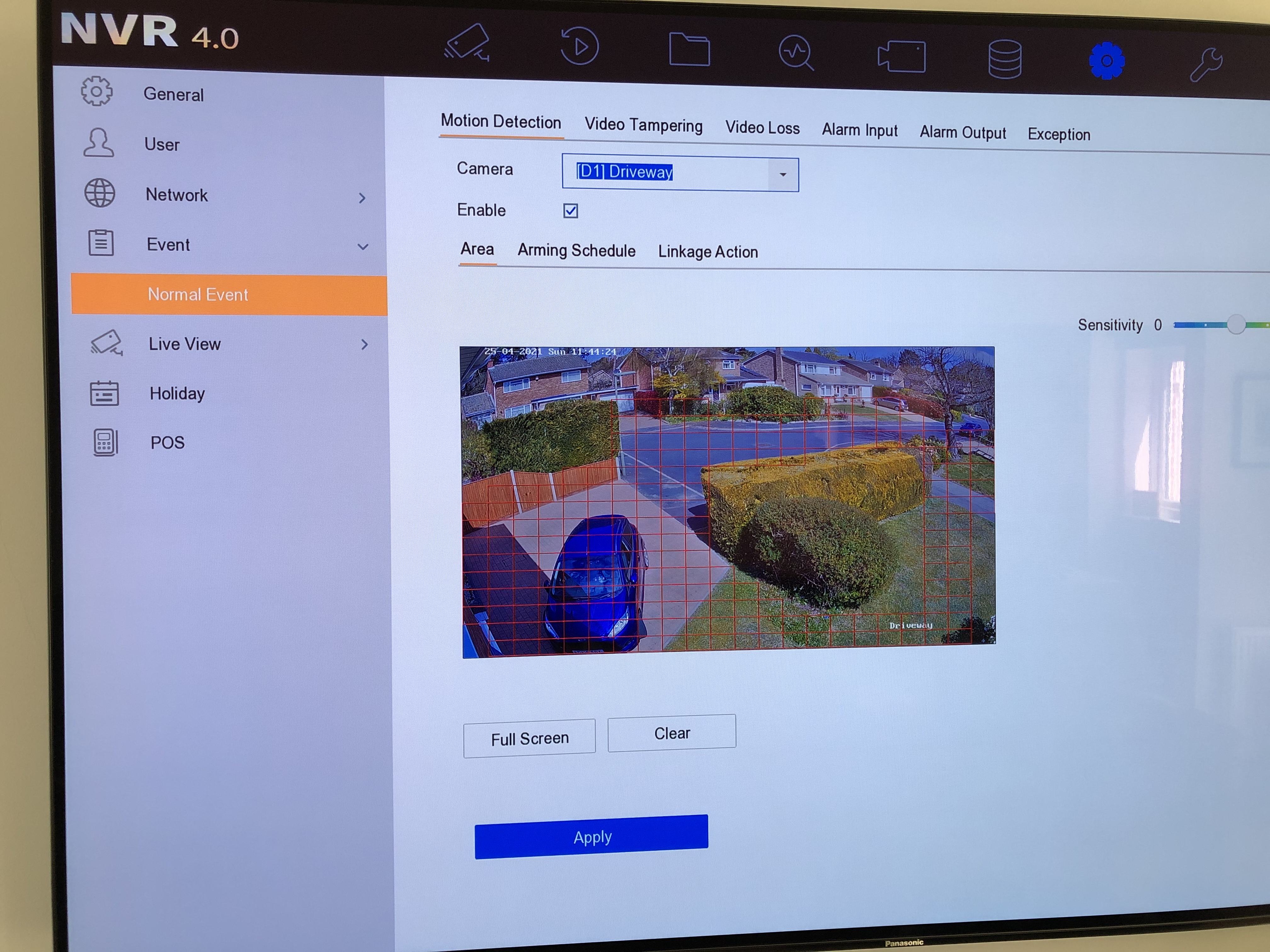

I needed to adjust my line crossing today and noticed the “smart event” drop down menu is missing on the NVR GUI.
SYSTEM/EVENT/NORMAL EVENT then should go to SMART.
If I log into the Web GUI via laptop I can access the Smart event tab and get access to the line crossing setup.
Ive restarted NVR several times but still missing?
Checked FW all up to date on IP cameras.
Is it another bug or have Hikvision moved the smart configuration setting?

It's been moved. On the monitor GUI click the Smart Analysis icon on the top bar (fourth from left)., then Perimeter Protection.

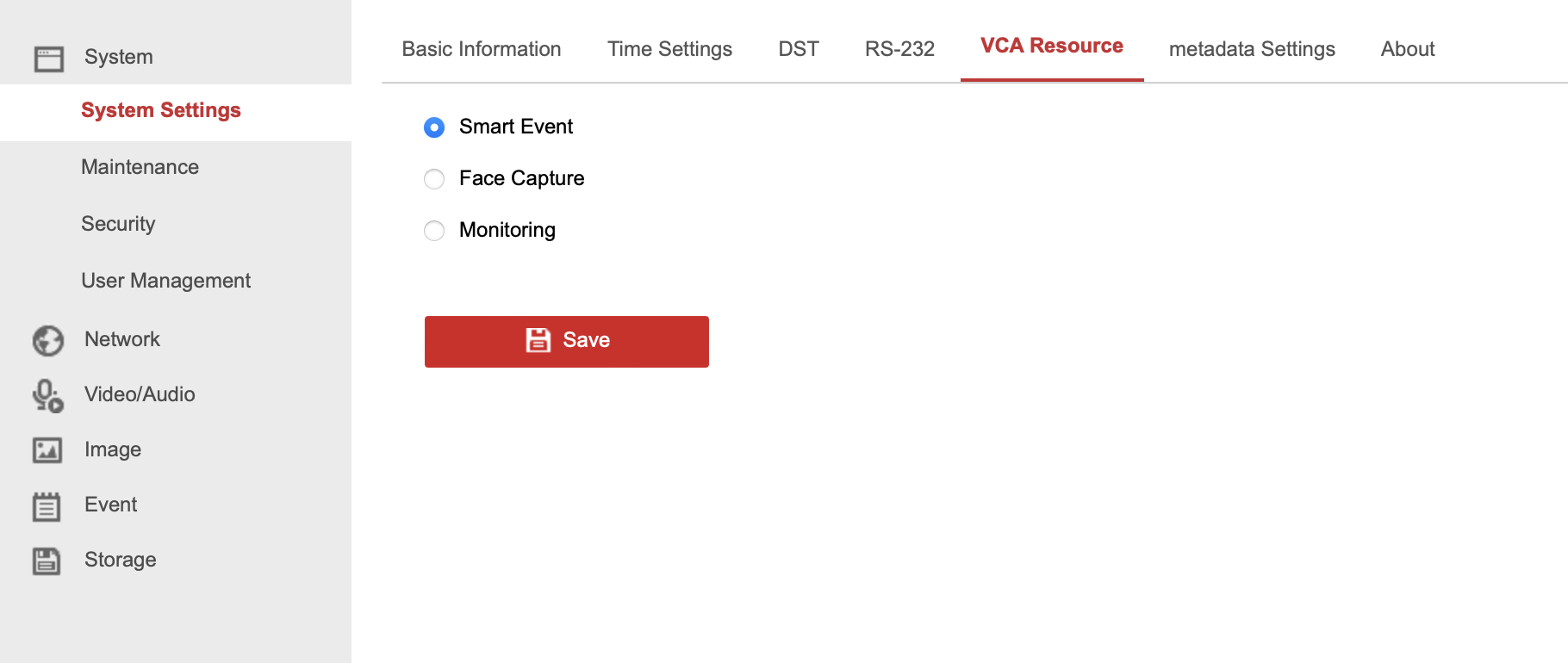

Does it work if you use the local menu on the NVR using the monitor and mouse? Can you take a look at the cameras settings via its web menu. Check the VCA Resource setting as shown in the image below. It must be on Smart Event not Monitoring or Face Capture:

thanks for the tip but I'm still banging my head. Doesn't work when doing locally on NVR while using mouse and also or either on web browser as VCA Resource is on smart event. ??
i think i fixed it - new firmware (not available in Canada but downloaded from Global site) Seems to be good - loving this camera
