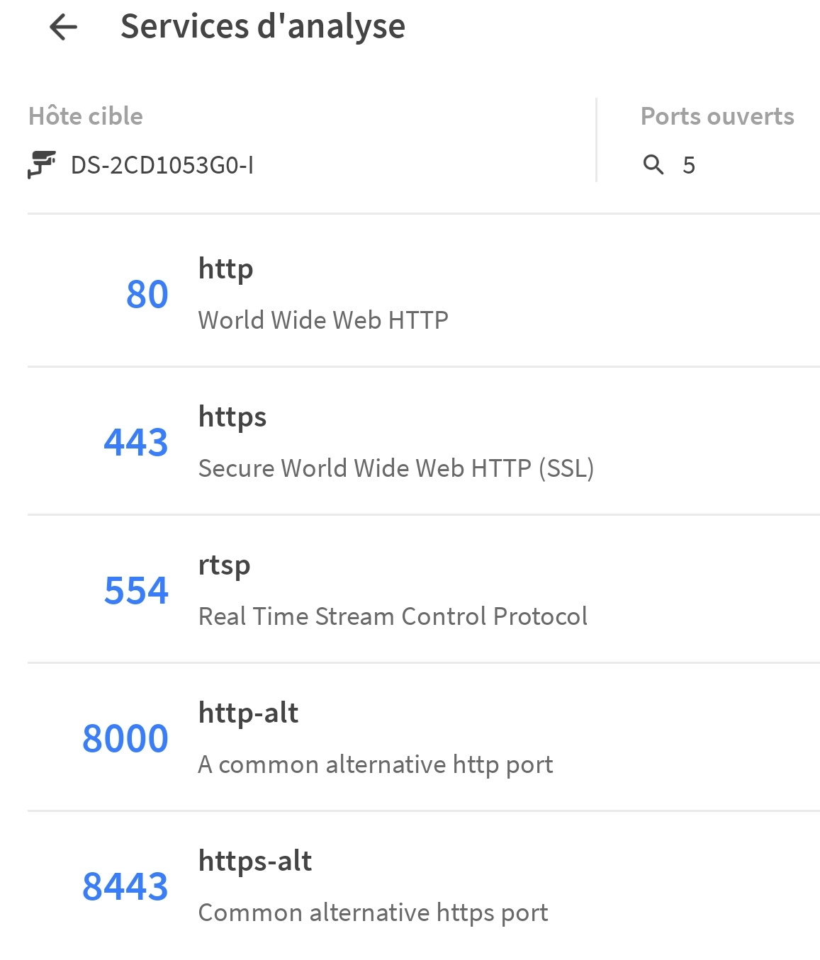

The camera is visible on the network and I can discover the 5 open ports. All seems OK.

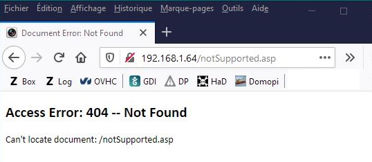

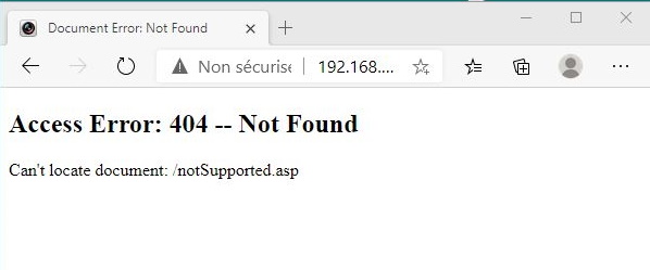

However when I connect to 192.168.1.64 I have no functionnal access.
A 192.168.1.64/notSupported.asp page is displayed
after a quick display of 192.168.1.64/doc/page/login.asp9_[a variable number] which is visible in the history of my browser.
I've tried either with Firefox, Edge or Chrome.
I fully disppointed. Has anyboby an idea of the problem and it's solution?

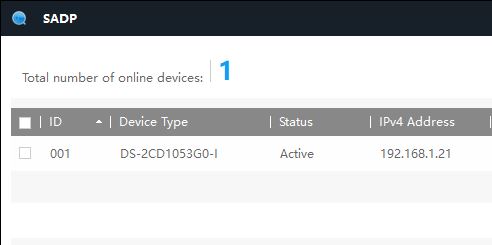

Hi @cuagn
I would recommend that you install Hikvision's SADP Tool to scan your local network for the device, if you have only recently plugged the camera in and have not yet logged in to the camera it will likely still be inactive, you will need to use SADP to activate the camera with a strong password and then set the camera to an available IP address by enabling DHCP which will automatically assign the camera the correct network information.
Make sure after you have enabled DHCP in SADP and the IP details have changed that you then disable DHCP because otherwise, the IP details of the camera can change when the camera reboots and this can cause you to lose track of what IP address the camera is using.
More detailed instruction for using SADP and activating the camera can be found at the below forum thread:
I've installed SADP and discovered that the camera was inactive.
I made it active and set DHCP in order to suppress the conflict with my Netgear relay.
Fine the camera is now at 192.168.1.21
