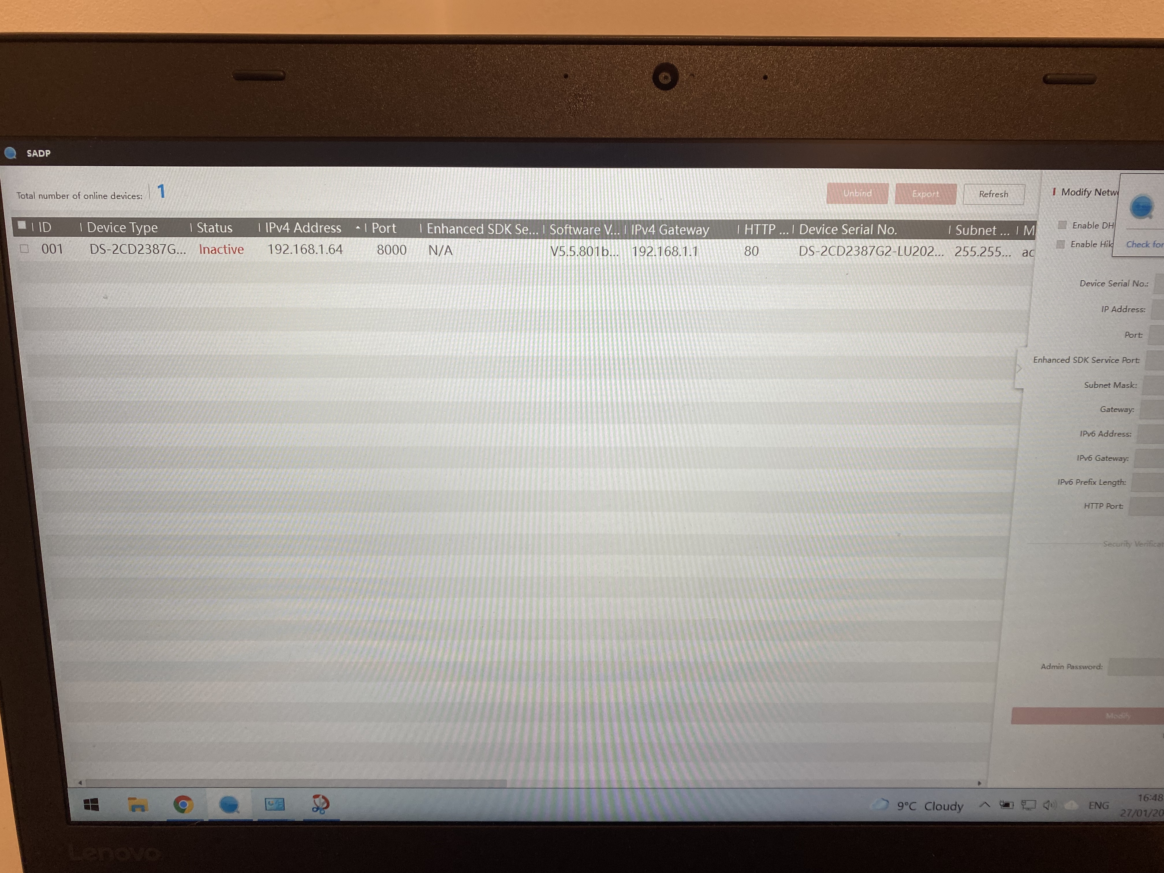

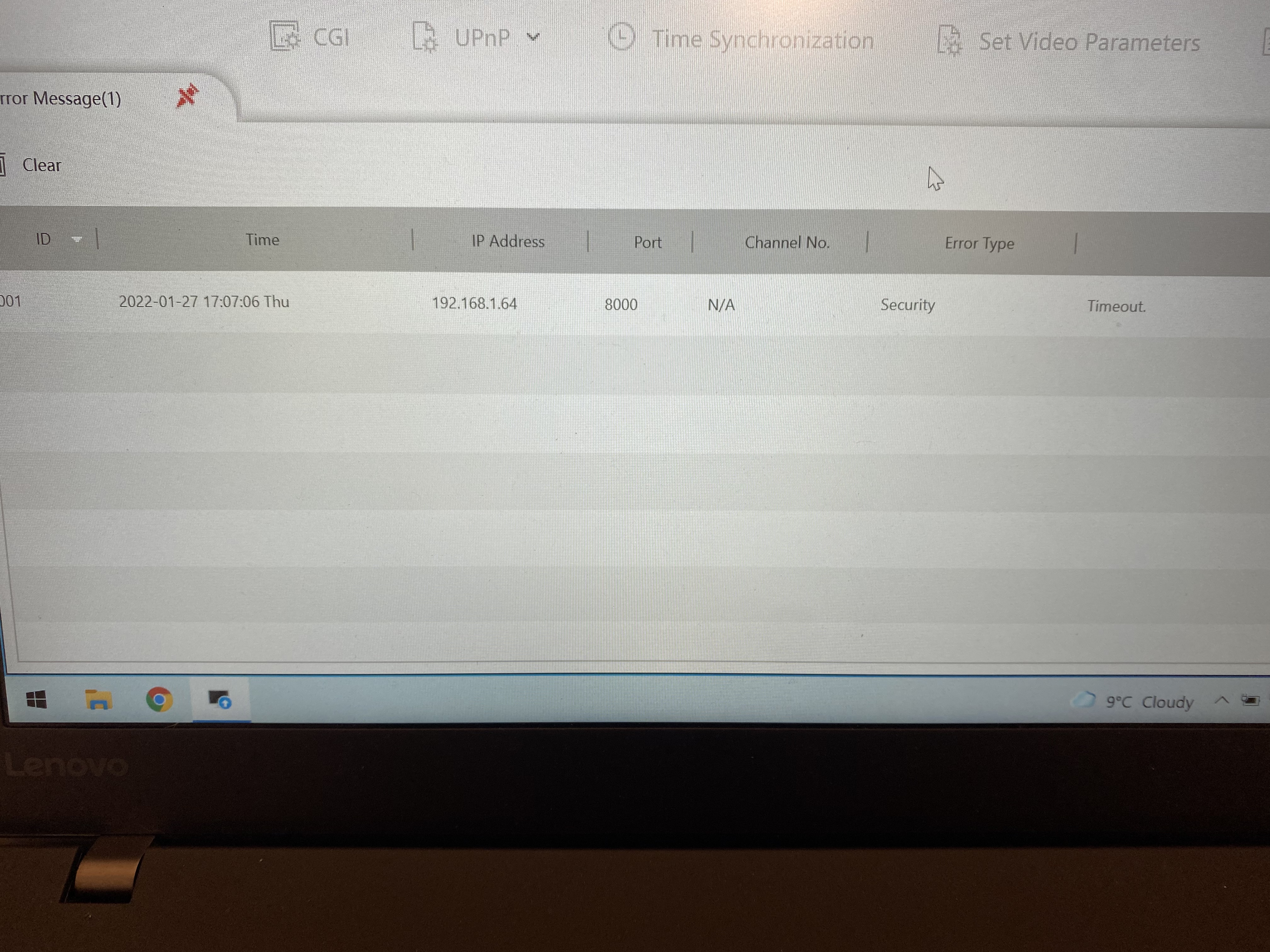

I can see the camera in SADP and it's asking me to assign a password, which I do, but then it timeouts.
I can't for the life of me see what I'm doing wrong, I've never encountered this before, any suggestions!?

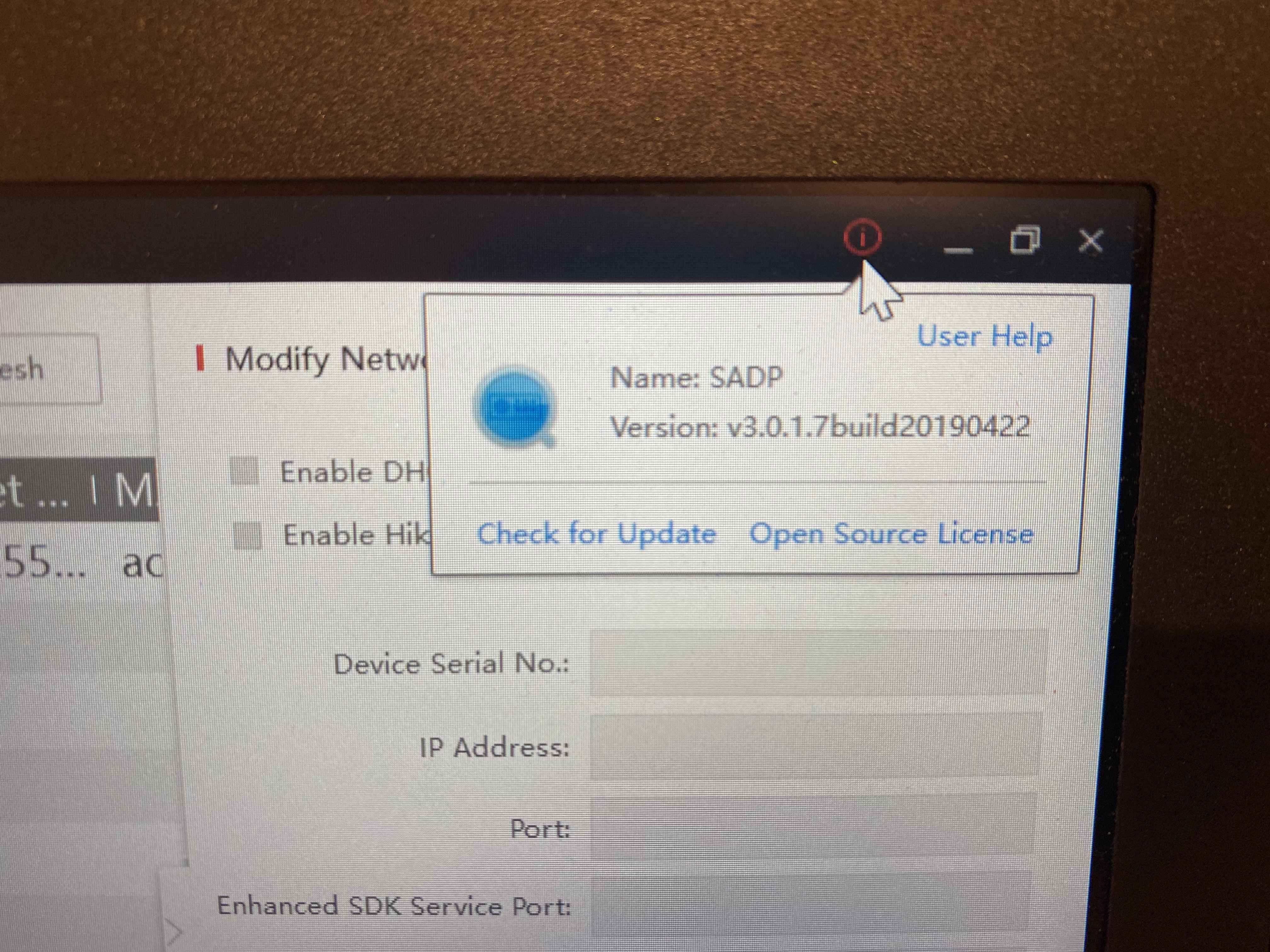

When you have SADP open can you click on the little 'i' info icon in the top right of the window and confirm what version of SADP you are currently running?
Hi Dan,
See attached.
You'll see the camera is inactive, upon entering the password and pressing activate, this is when I see the "timeout" error.

Just to follow on from this, my laptops IPV4 address is 192.168.0.27 and the camera in SADP is 192.168.1.1
Could that be an issue and if so, is there a fix?
So just to box this topic off and to help anyone else in my position, the above post was causing the problem. I had to amend my IP address and then activate the camera via the cameras IP and NOT SADP as that still did not want to play ball.
