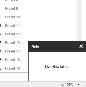

The old chestnut - Live View Failed using web browser over the internet?
George-H
50
This seems to be an issue to which I've yet to see a working solution - at least one I can to get to work.
I have (now) two remote sites.
One has 5 Hikvison DS-2CD2146G2-ISU cameras, plus 4 Foscams and an old Foscam FN3109HC NVR (long story). That all works fine with the Foscam NVR recording the Hikvision video via ONVIF. I can view all 9 cameras via the Foscam NVR over the internet by ONLY forwarding HTTPS through the firewall.
I can view the live view of any of the Hikvision cameras via web browser at the site but ONLY if I am on the local LAN. I've NEVER been able to get the live view to work from anywhere else over the internet no matter what ports I forward HTTP, RTSP, SERVER or anything else. All I can do is login the web gui then I get "Live view failed".
The second (new) site has two DS-2CD2146G2-ISU cameras plus a Hivkvision DS-7604NI-K1-4P(C) NVR (all brand new). Exactly the same issue. I can login to the camera and NVR web GUIs on the local LAN and view the live view. From somewhere else over the internet - "Live view failed".
So please, has anyone EVER found a solution to this for HikVision that actually works?

Agreed - there should be no issues. And it does indeed work fine when on the same lan as the cameras and NVR (or connected to that lan via VPN).
However, using the same test PC (a laptop in this case) which definitely has the Local Service Components/WebComponents installed, when trying to access either the camera web GUI or NVR web GUI over the internet through the site's router/firewall using port forwading it does not work.
I can access the web GUI but no live video. I've never been able to get it to work in this situaton using any of my HikVision cameras. Doesn't matter what ports I forward, even forwarding ALL of HTTPS, SERVER, RTSP ports - still Live Video Failed.
The cameras at the larger site are 4 x G3 and 1 x G5 and the new small site are both G5. None of them or the DS-7604NI-K1-4P(C) work in this situaton.
It SHOULD work and, unless someone can explain clearly otherwise, it SHOULD work only forwarding the HTTPS port. But it does not.
Check which version you have installed. I had an issue recently being unable to get live view working even locally until I updated. Latest Local Service Components is 1.0.0.60 and I needed to manually uninstall the previous version first.

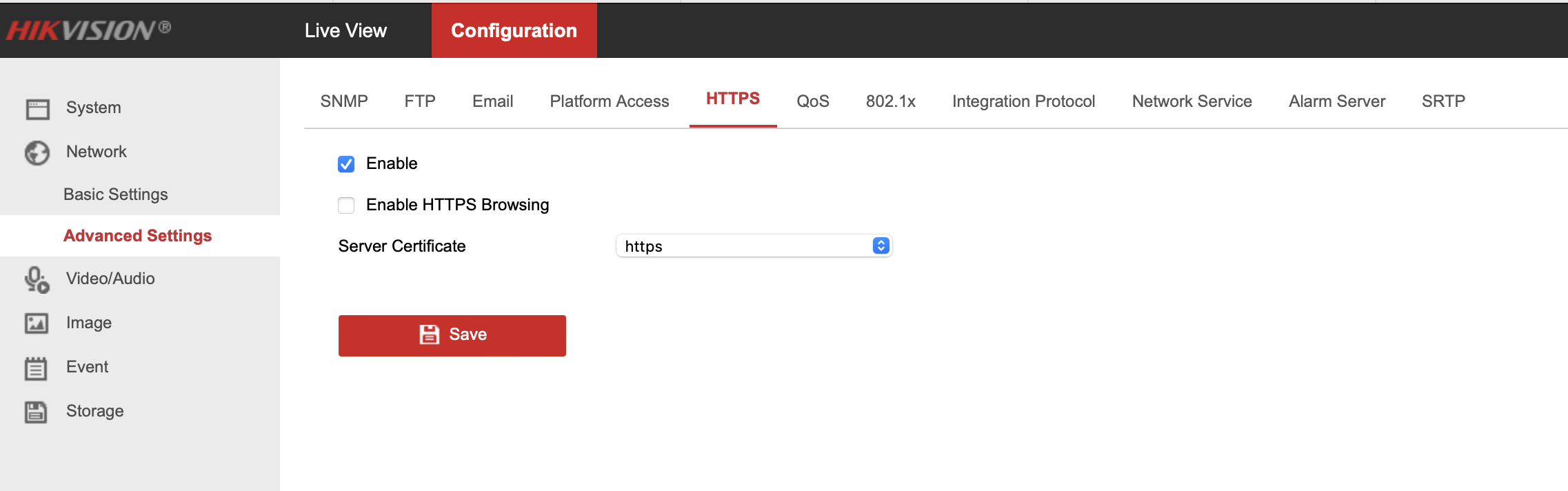

@George-H a couple of other things to check....
Have you enabled 'https browsing' in the cameras? By default https is enabled but https browsing is disabled as shown in the image below:

Could that be blocking the port forwarded live view...

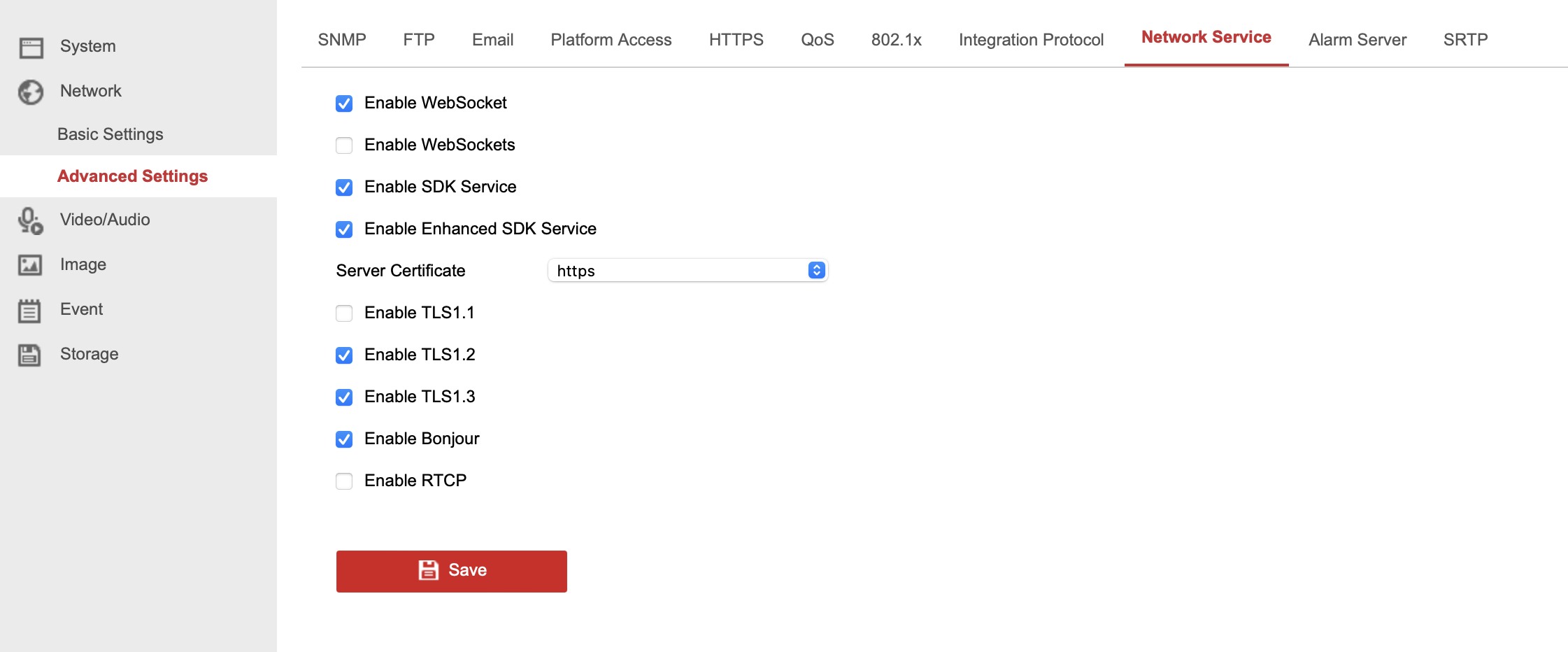

Also for plugin free live view (where supported) you need to enable websockets which is also disabled by default as shown below:
Thanks JB - I'll give enabling Websockets a try.

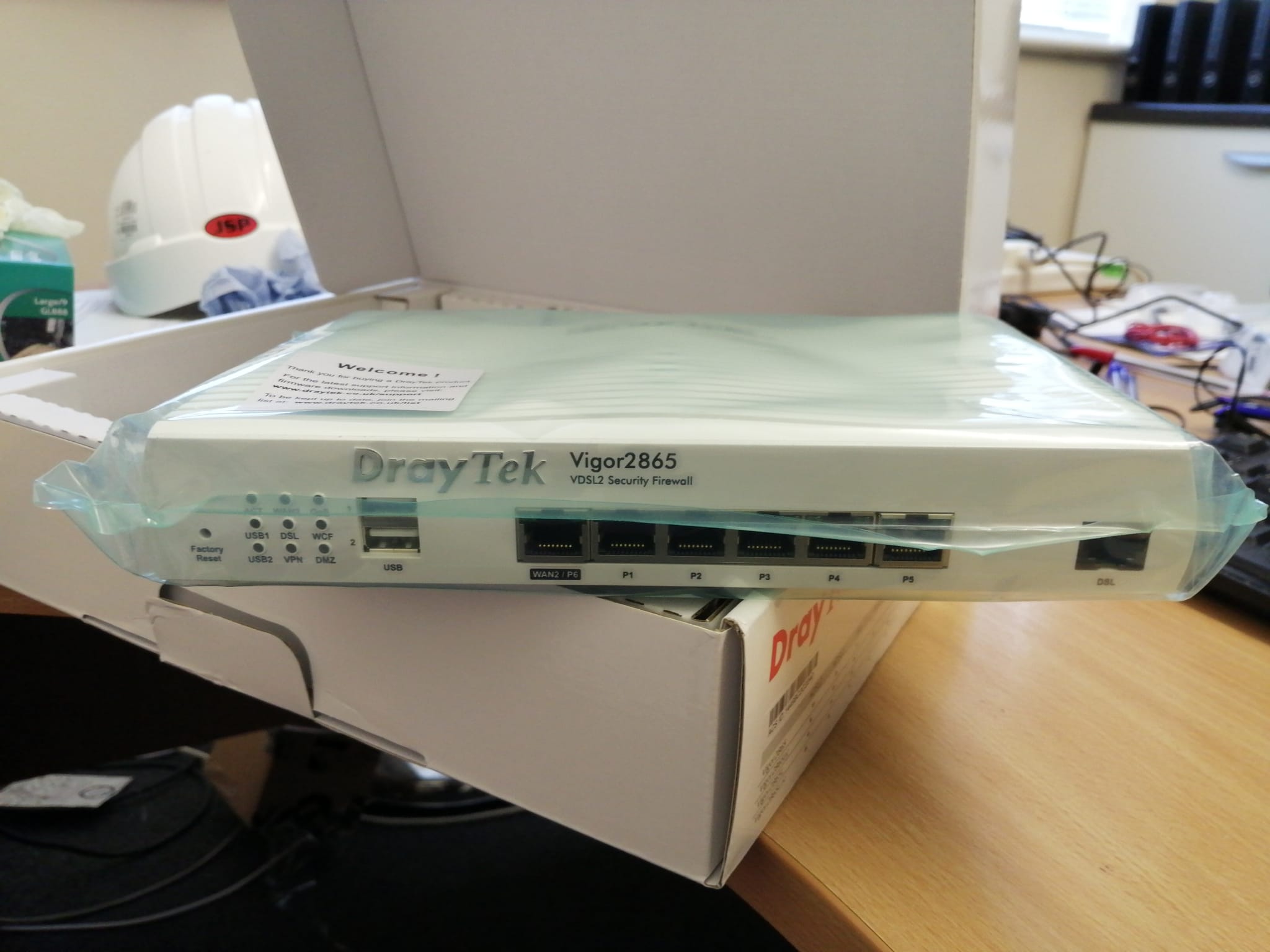

And this just arrived a short while ago (see pic) which I'll be installing at the weekend. Proper VPN access!

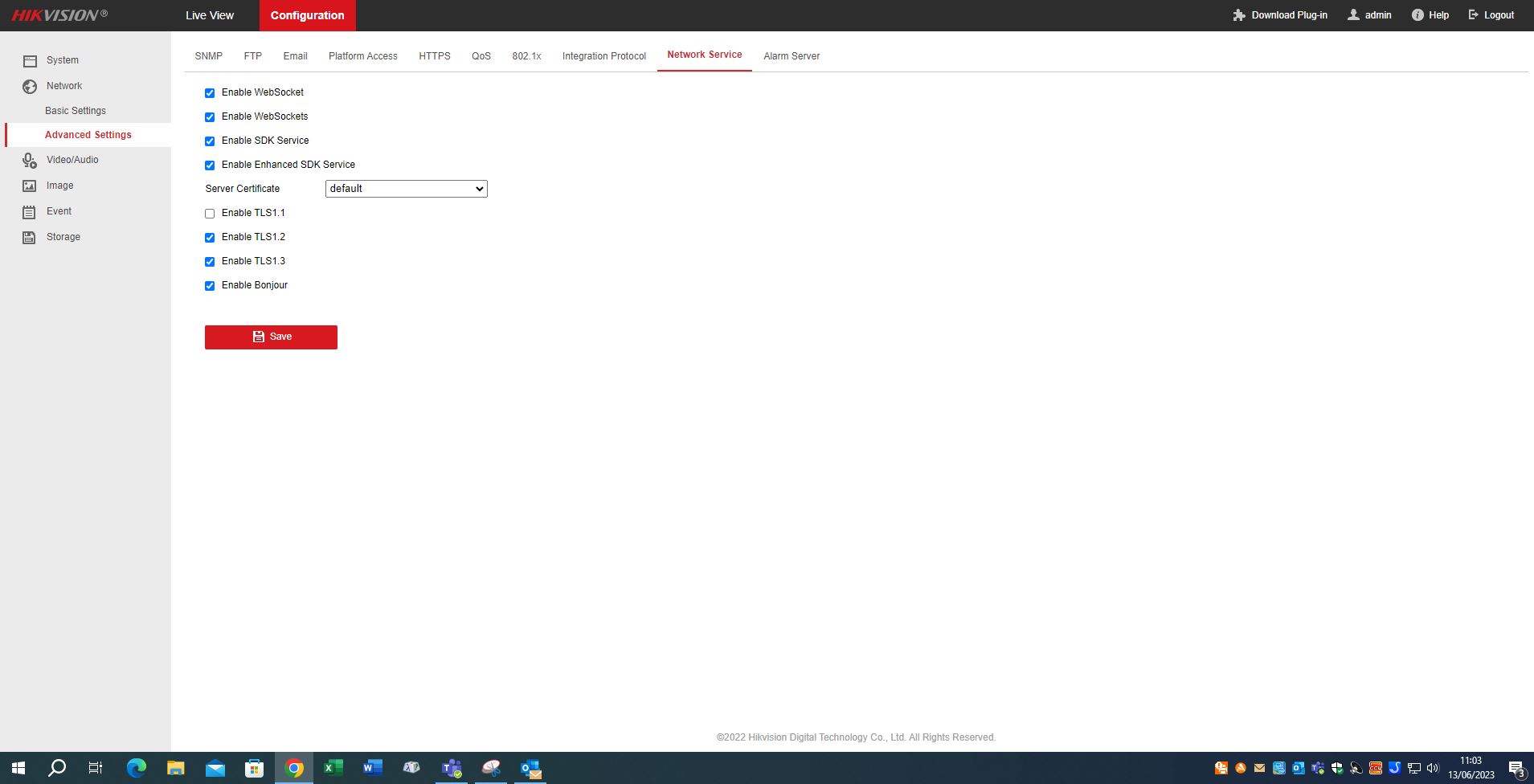

Unfortunately enabling Websockets - then rebooting the camera just to be sure - made no difference.
Still exactly the same in both Chrome and Edge (in or out of IE mode).

Just to confirm. Did you enable 'https browsing' as well as 'https' - there's a separate selection for each...
Websockets, I believe, only applies to plugin free browsing. So that would require both the camera firmware and teh specific browser to be compliant.

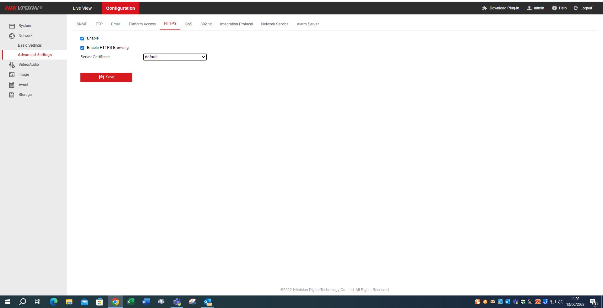

As I mentioned, the very first thing I do is enable HTTPS:
