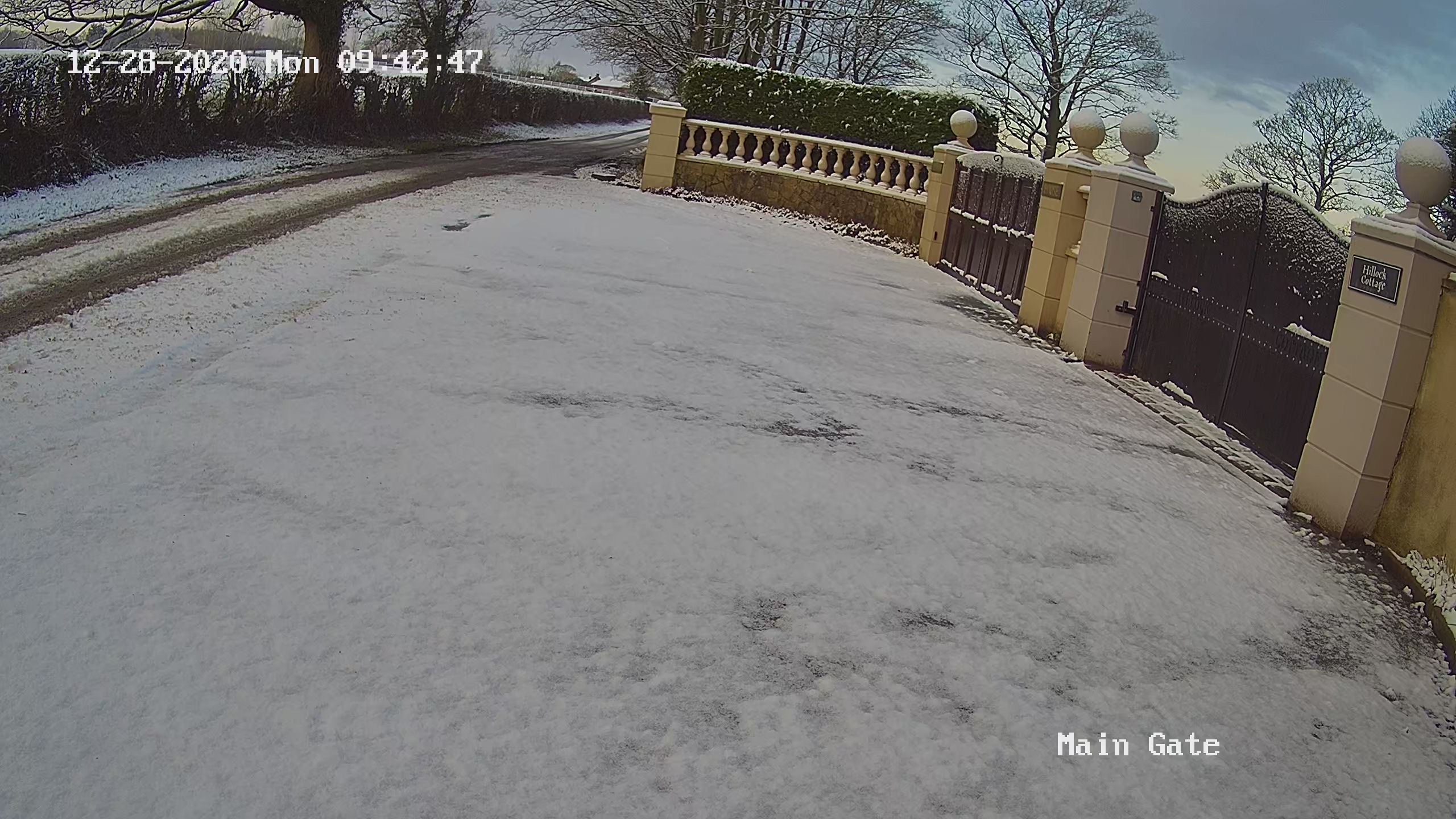

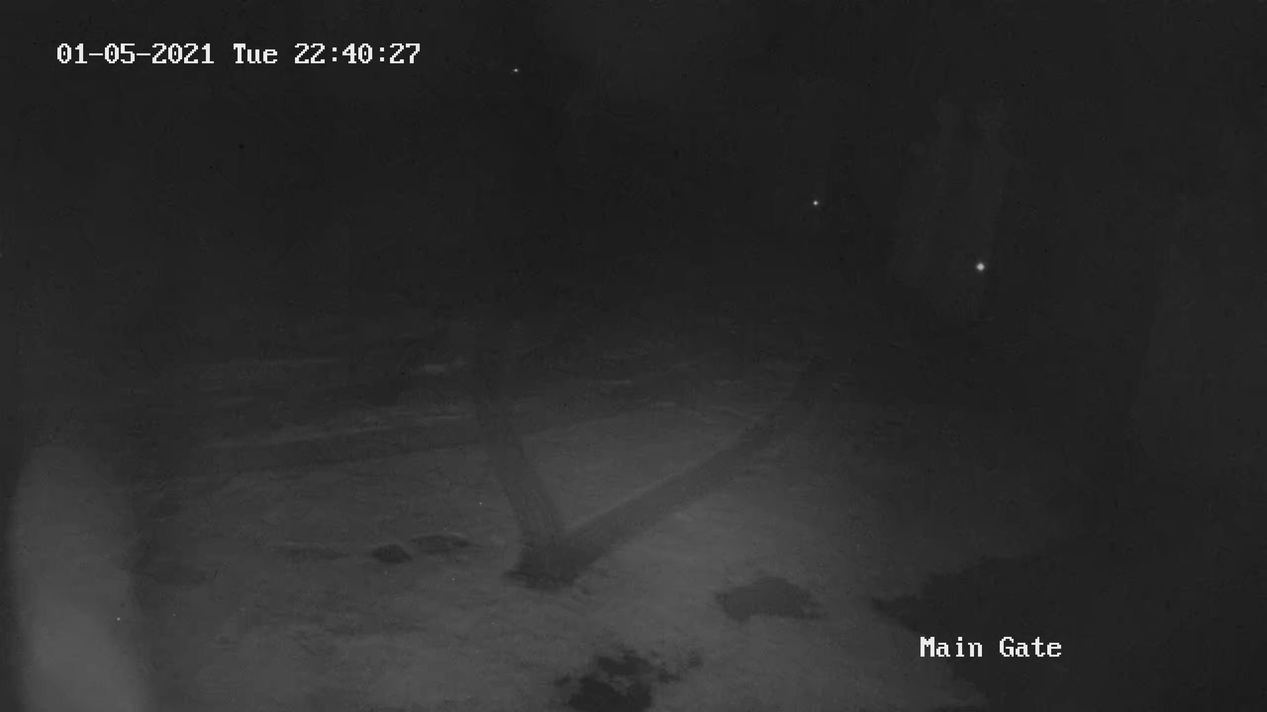

Hi. Looking for tips on which config areas to adjust to improve night image on 2163G0 given it rates @ (max) 30m IR.
images attached taken from camera, no street lighting nearby and the first set of gates on right is <10m from camera, the left of the image is a public single track road with adjacent verge/stone wall.
I would have expected better image but happy to be corrected or given advice. Internet searches are somewhat conflicting on best settings to adjust, and I’d prefer not to add a supplemental IR illuminator.

@Dave Howard Have you tried adjusting the camera exposure? It may lighten the image, make sure it does not compromise video quality.
That is a very poor night image
Virtually no infra-red contribution
Can you see that the IR LEDs are working?
I can see some IR internal reflection glare at bottom left
Make sure that the dome cover inside and out is really clean
Test to see how it looks with the dome cover off temporarily
It's set at 1/500 as are other cameras. I've changed this 2163G0 to 1/200 and will see impact of this tonight.
Appreciate any other points i should look at e.g. HLC, BLC, etc. Thanks.
Thanks @Phil have changed exposure to 1/200 not 1/500 its better (played with WDR, BLC, HLC but without material change).
IR's on the camera i can 'see' 3x lit red. I'll check again this evening and also follow your other suggestions (dome was cleaned in + out before the above images taken). Will report back tomorrow :-) help much appreciated.
I agree its awful certainly by comparison with a 2346 I have pointing opposite way (yes I know its turret, etc) :-)

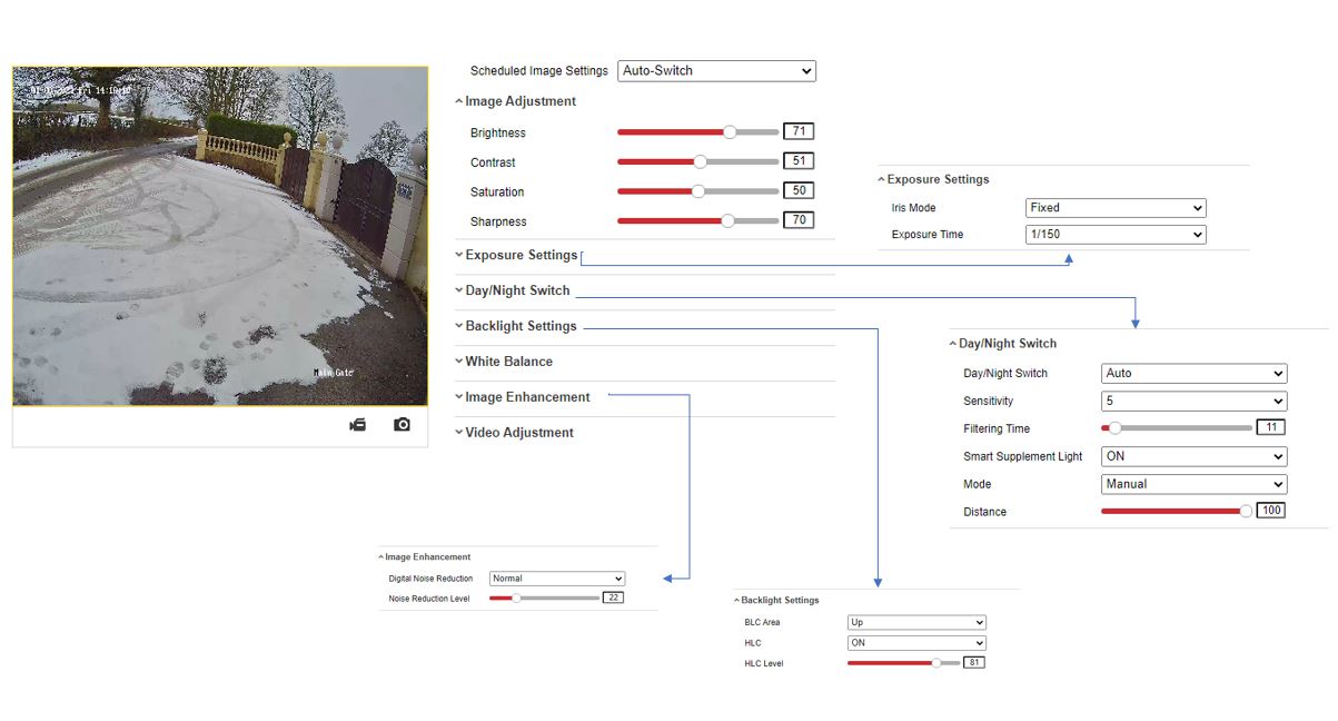

@Phil i attached pics of image from camera and its current settings. There are three IR's visible from on the camera. Having dome off seems to make little difference. The pics are Stream1 taken on PC via browser to NVR. I've included config as well.
Dave,
increase Image Adjustment> Brightness. Mine is set to 87
Exposure settings> Exposure Time increase to brighten the picture. My night exposure time is 1/25.
The centre of your IR light seems to be lower than the camera's picture centre, try to raise it. The IR centre on my cameras is low as well.
Dave,
