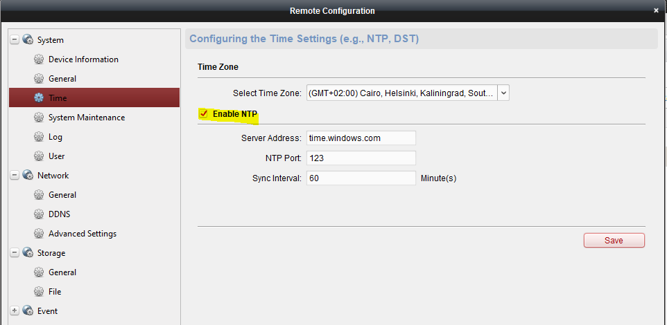

More of a best-practice but important - Synchronize the time across all devices. If possible set the cameras to use NTP server: time.windows.com and make sure the Time Zone is correctly set. There should be a Test button to check the camera is able to communicate with the NTP server provided it has internet access. If not, when you add devices to iVMS-4200 there is a tickbox to Sync Device Time with the local PC.
On the camera:
In Windows 7 you can sync with a NTP server in the Control Panel>Date and Time>Internet Time(tab).

This is important for accurate search/playback, metadata, events and many other features to work properly.

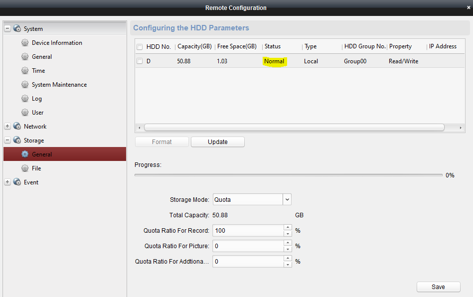

In iVMS-4200>Device Management select the Storage Sever and click Remote Configuration. Under Storage>General make sure the HDD/partition you allocated reports a Status of Normal.

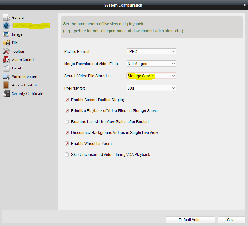

Also check here: Click Tool on the file menu and select System Configuration. Click Live View and Playback and set the Search Video File Stored in to Storage Server.

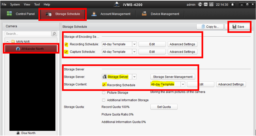

Lastly open Storage Schedule (added from the Control Panel if missing) and make sure each and every camera is set to record to the Storage Server using the All-day Template. Click Save for every camera you modify.

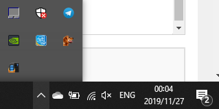

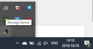

Reboot the PC to make sure the changes take effect. When you log back into Windows check the blue storage server icon and the dog head (iVMS v2) or red circle icon (iVMS v3) are visible in the icon tray.
