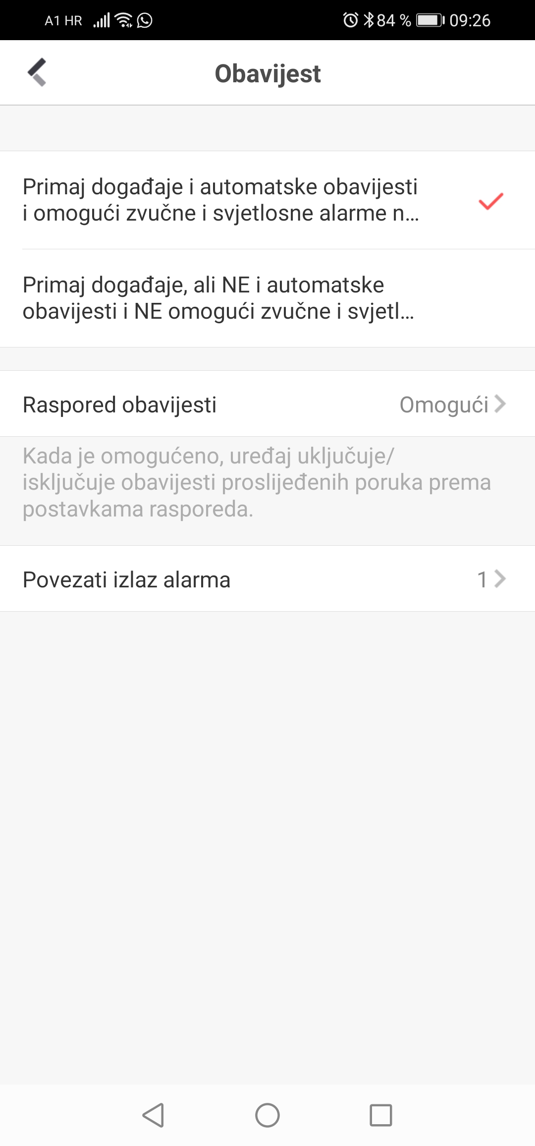

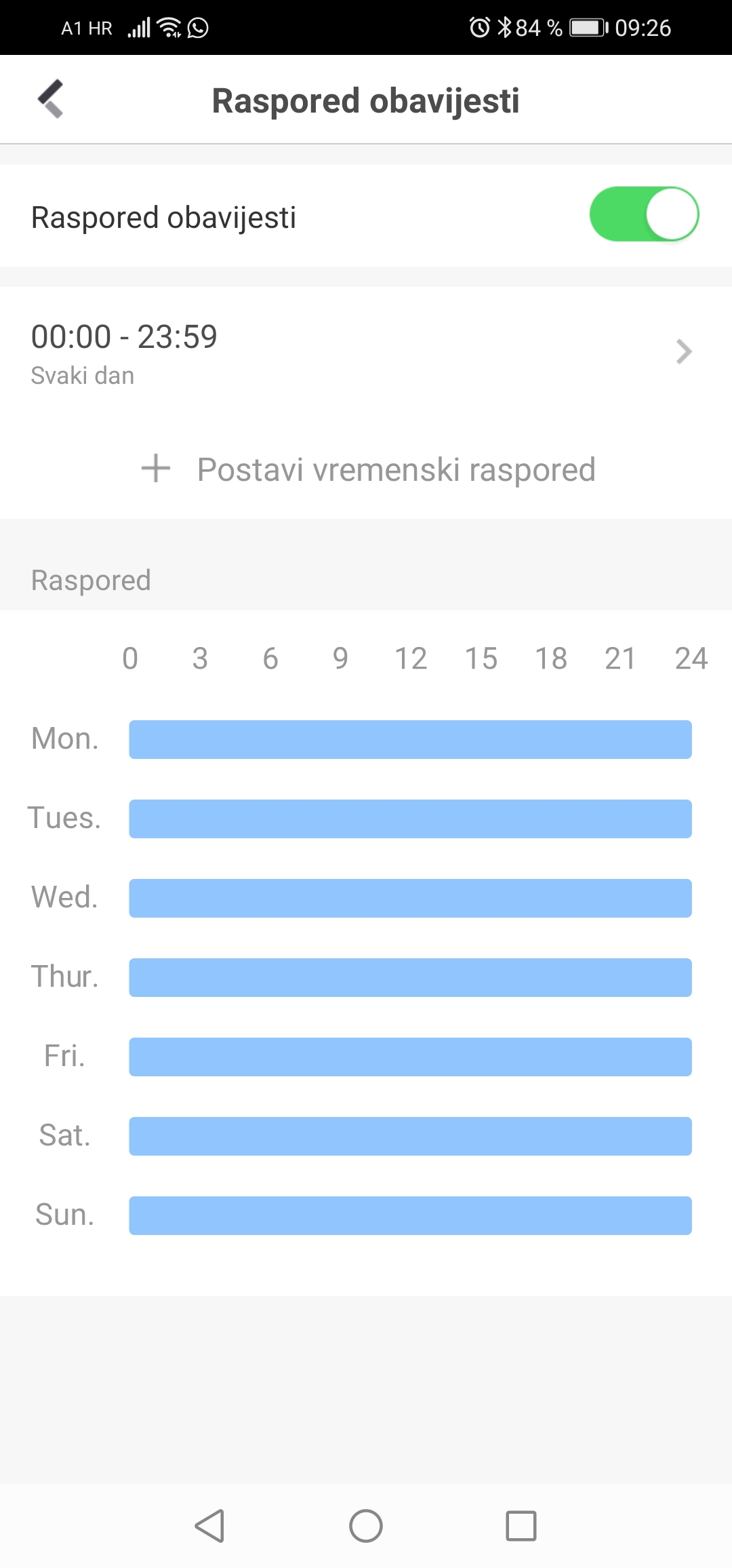

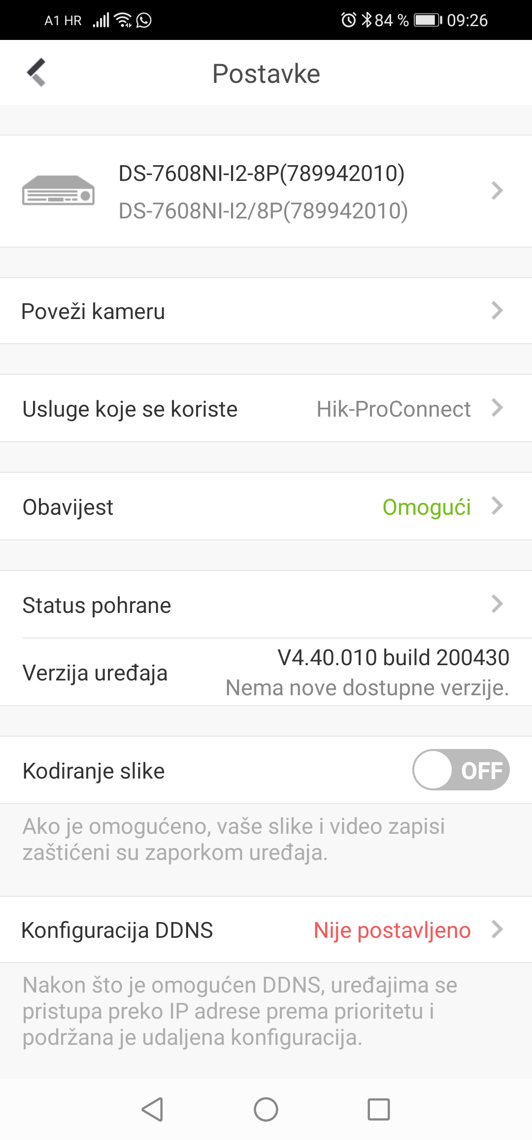

Picture's is in my native langugage but you go into your HIK-CONNECT app. Choose notifications ( obavijesti ), enter Schedule ( raspored obavijesti ) and then choose your schedule.
Try that.

Many thanks KamirZG. That is exactly what I needed and the schedule feature is good too.

I didnt know about this feauture so had never setup any schedules. I have now set this up and now my kids dont set it off everytime they run outside.
