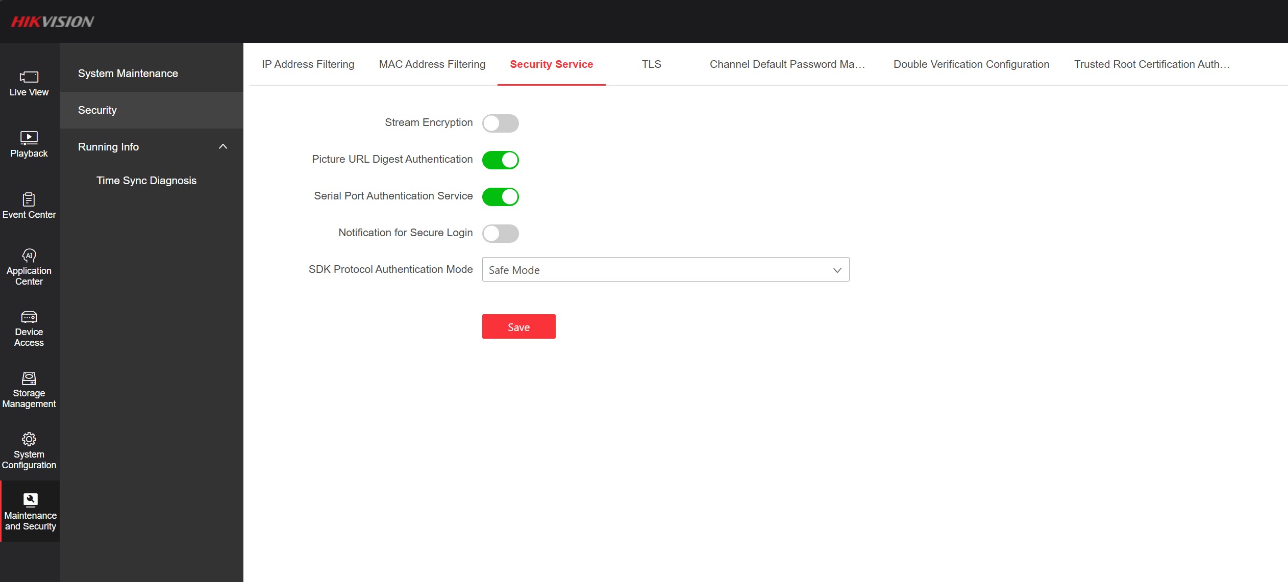

Does anyone know if the option to turn off the stream encryption has moved in the lastest firmware ?
I cant find it anywhere

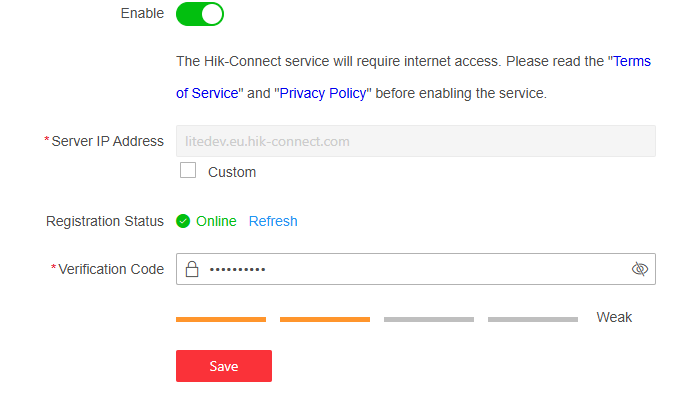

Just turn it off in Hik-Connect app. Click the 3 dot menu next to the site, then Settings. Image and Video encryption switch is there.
I’m not sure why it’s been removed from the devices menu; perhaps it’s for additional security/privacy. It ensures encryption is on by default at the time of connection to the Hik-Connect platform and has to be explicitly disabled using the platform (which presumably is logged)
