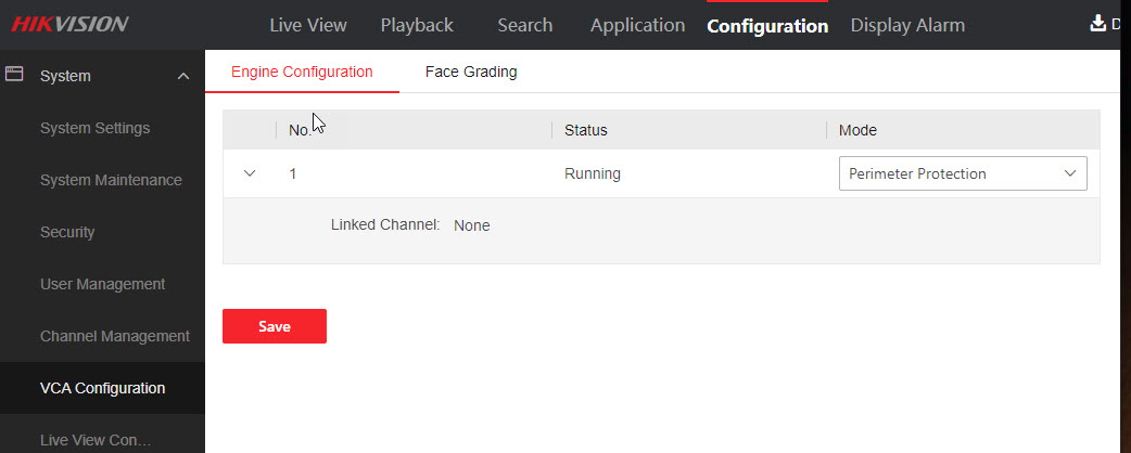

Hi
I cant seem to find the answer anywhere, so I hope someone in here can help me?
Please see attachment - what is this configuration for, and shouldnt I have at least 1 linked channel here? (See attachment, linked channel: None)
NVR:
Device Model: DS-7608NXI-I2 / S
Firmware Version: V4.62.210 build 230612
I have activated Smart Event: Intrusion Detection
Camera:
Device model: DS-2CD2143G2-I
Firmware: V5.7.13 build 230504

This one causes a lot of confusion. You have activated "Smart Event:Intrusion Detection" but it's possible/likely that you're using the cameras VCA. The camera model you've detailed does not have AcuSense Human/Vehicle filtering so you're not getting the benefit of the NVR features and not using the event engine.
Go back to the Smart Event Intrusion Detection setting for the camera, disable it (untick the enable box) and save/apply. Then at the top of the page tick the box for "Use Device VCA" (or similar wording), click apply. Once that's done enable Intrusion detection again and redraw your settings. That should force the NVR to to do the AcuSense filtering and the camera should then appear as using the VCA Event Engine.

I guess that you meen all settings you said should be done on NVR right, and not on the camera?
I did like you said, but no change in Linked Channels - still None :-(

My bad you're right, the camera is Acusense - apologies.
In that case it really didn't matter about the NVR event engine not being in use. You can choose to use AcuSense on the camera OR on the NVR (not both). If you use the NVR event engine it restricts the engine to either Motion or Smart Event (set intrusion using the NVR engine on camera 1 and you wouldn't be able to use motion on camera 2). Whereas if you use the AcuSense on the camera it would normally allow you to have motion and line crossing/intrusion detection simultaneously (as it's not restricted by the NVRs available resources)

Can you tell me what the difference between VCA Engine set to "Perimeter Protection" or "Motion Detection" is for?
And when I should change that?

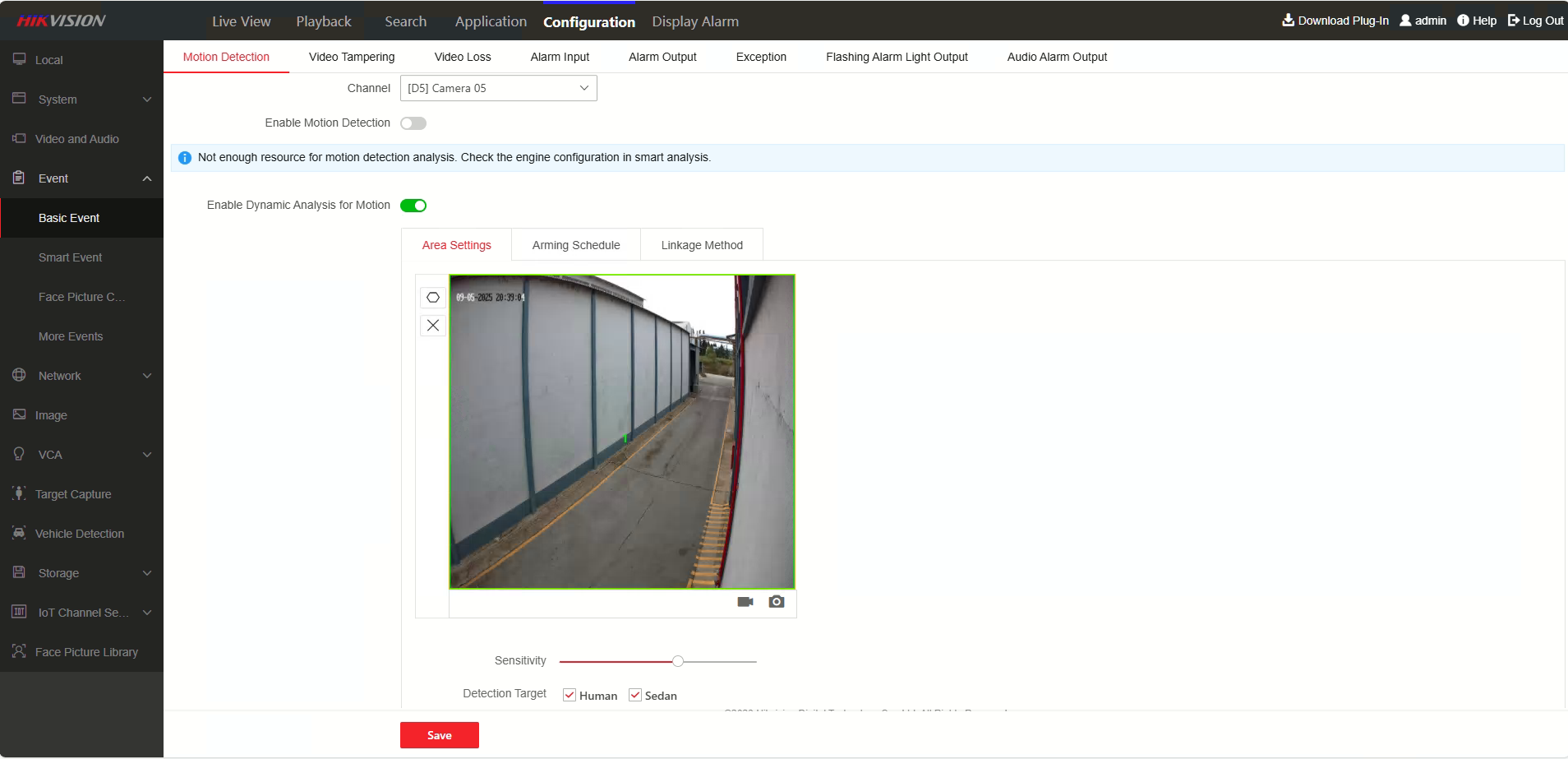

Thank you for the very good explanation, much appreciated, i am starting to understand Hikvision a little bit now :-)
Actually I have 3 AcuSense cams and 2 Non AcuSense (other brand) and I get this error know:
"Not enough resource for motion detection analysis. Check the engine configuration in smart analysis."
I only activated Basic event Motion Detection on the two Non AcuSense no name cams. And not Enabled VCA Enable by Device.
Do you know why and how I solve that, or is it not an issue I should concern about?

Unfortunately you've gone too far so the settings are a bit messed up. In the NVR each camera has two event configurations depending on whether the 'enable VCA by device' is (or EVER was) ticked or not. You need to somehow get back to where you were before you started by clearing and disabling the events on each camera. When you tick or untick that 'enable VCA by device' and apply - previous settings may reappear that need to be deleted.
Once you're back to square one set it up as detailed in my previous post. The 'not enough resource' appears when the event engine is set up for perimeter and you try to set up motion, or vice versa as mentioned in my bullet points above.

1) It appears the message "Not enough resource for motion detection analysis. Check the engine configuration in smart analysis." Probably by playing with configurations I have messed them all up. What do I have to do to remove this message?
2) In motion detection it also gives me the option to choose for human/vehicles clarification but only in my AcuSense cameras. So what that means? Does that means that the cameras use the AcuSense feature also in motion detection except the smart events? So cameras with AcuSense feature applies it to both basic and smart events?
3) My Engine Configuration in VCA configuration is set to perimeter protection. Is this why in the non AcuSense cameras gives me the option to select human/vehicles clarification at smart events and not in motion detection? For example... if I change the engine configuration to motion detection, will then allow me to choose human/vehicles in motion detection and will remove this option from smart events?
For VCA by NVR (needed for your non AcuSense cameras) the 'engine' can only do perimeter protection (line crossing/intrusion) OR motion detection. For perimeter protection, the NVR may be limited to a particular number of channels. You need to decide for the non AcuSense cameras whether you want motion or perimeter protection.
Human/Vehicle is available on Acusense cameras for both motion and perimeter protection; in fact you can use both simultaneously when VCA is 'by camera'. That's one of the benefits of having the camera doing the processing (where capable) as it's unrestricted. If your non AcuSense cameras aren't giving you the option of Human/Vehicle on motion, it's because the engine is configured for perimeter and so it's unavailable.
Yes and yes, but it's a bit of a faff on to switch....

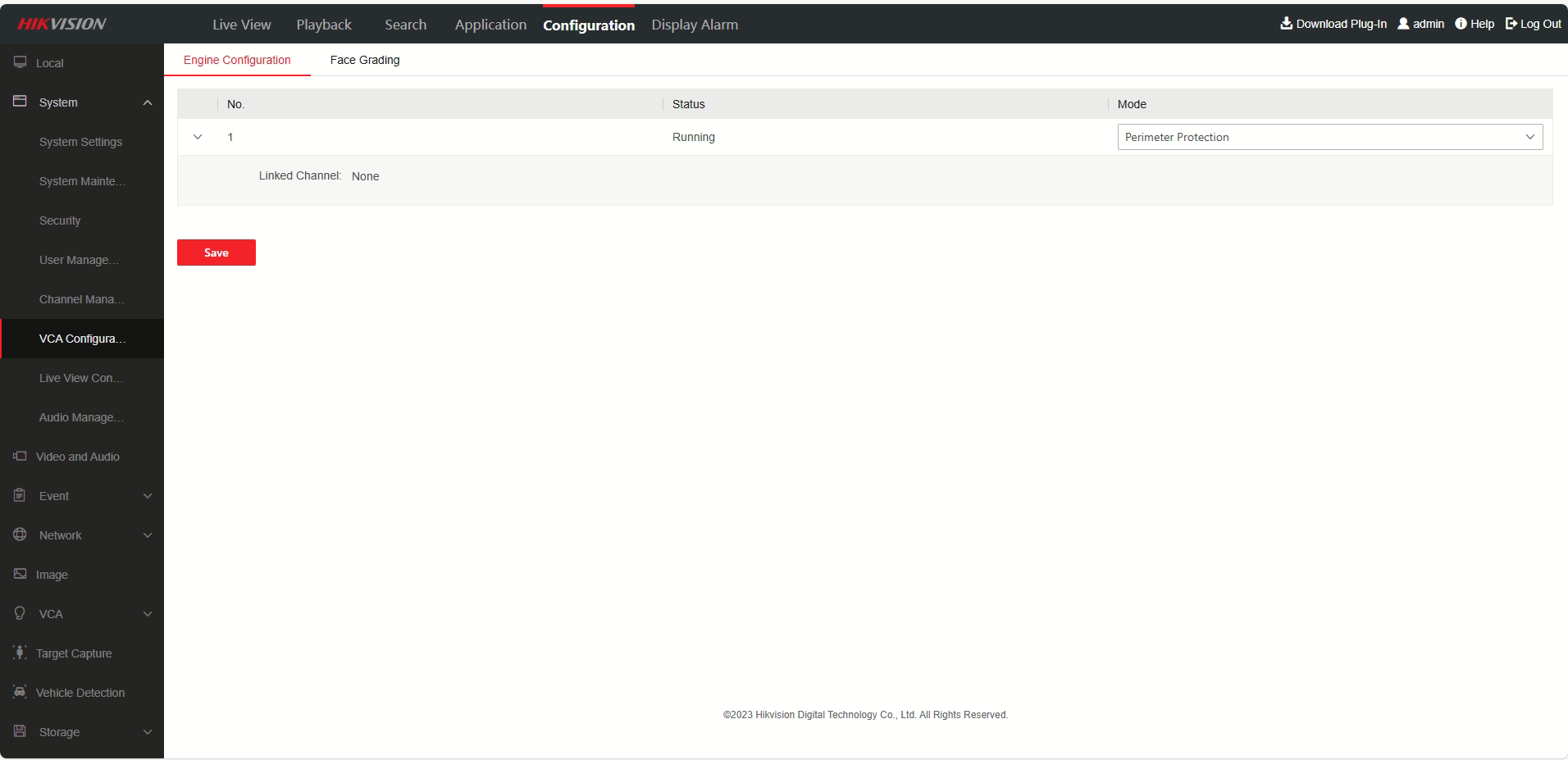

So back to how you sort out your config. My advice would be to:
  1. select each camera in turn, select line crossing and where available set it to VCA by NVR then save.
  2. if set delete the line crossing, save, untick the enable box, save (if you've messed around with intrusion do the same)
  3. if it's an AcuSense camera, reselect VCA by camera, save. If it's a non AcuSense camera, leave it on VCA by NVR
  4. repeat for all cameras
Once done the NVR AcuSense engine should not be in use, as you've deleted and disabled all events using it. So you can go ahead and set up your AcuSense cameras as you wish using motion and/or line crossing and/or intrusion.
You should now be able to chose whether to use perimeter OR motion for the non AcuSense channels. If it still won't let you select motion with Human/Vehicle on the first camera, you'll need to find the engine configuration in the local menu. It shows what resources are in use and will allow you to switch between perimeter and motion. I can't recall exactly where you'll find that as I don't have an NXI that I can check but the above should assist.

Dear @JB1970,
Thank you so much for your prompt response.
I finally think that I I am in a good path regarding the knowledge of how basic events, smart events and how AcuSense work.
I have disable all my events (both motion and smart) by unchecking them, I have disable the use of nvr AcuSense in my 1 non AcuSense camera where I used to have it enabled. But I still see the "Not enough resource for motion detection analysis. Check the engine configuration in smart analysis." message when I go to motion events.
I have to mention that I haven't delete the areas, lines etc... of each camera and event types. I have only uncheck the events option (enable/disable).
Do I have to delete the areas, lines, min and max size for each camera and each event too?????
As for the VCA configuration... is set to perimeter protection as I want it to be. My question was in order to understand how it works, so there is no reason to set it to motion. Also regards only 1 non AcuSense camera. Probably in the past (when I was trying to find out how all this work) I would accidentally change this option to motion without knowing what is about.
Dear @JB1970,
I'm confused now as to what you want. What you chose for the engine configuration has no effect on AcuSense cameras where you're using VCA by camera.
Make sure your AcuSense cameras are set to 'VCA by Camera' and set up motion detection, line crossing or both on them.
As you've already got Line Crossing set for the NVR engine configuration and that's what you want, set your non AcuSense cameras to VCA by NVR and set up the line crossing on them.
If there's a non AcuSense camera where you want to use motion detection instead of line crossing, you'll need to delete and disable the line crossing on that camera, switch to VCA by camera and then set up motion detection as normal which will be basic motion detection with no false alarm filtering.
If you're still getting 'not enough resource' messages you'll need to go into 'engine configuration in smart analysis' (which is available somewhere in the local menu of the NVR) where you'll see what resources are in use, available and the cameras that are using them.
Why you are confused? My engine configuration is set for perimeter protection as it has to be. I use only one non AcuSense camera for smart event so I think that's setting is fine. Also it has no linked channel on it as I have disable all my events.
The problem is that I have this message on all of my cameras channels in motion detection section. So I suppose this message appears because of faulty setting I had in the past.
Yes possibly. That's why the first step listed in my post above was to enable VCA by NVR on all channels, then delete all line crossing, disable line crossing, and switch back to VCA by Camera. There wasn't any point in not deleting the line crossing configuration before switching to VCA by camera; it's no use to you later on. When you do VCA by Camera, although it's displayed in NVR UI, the line crossing is saved in the camera itself. When you do VCA by NVR I think (I could be wrong), that line crossing is saved on the NVR not the camera. So I don't think you can't just switch to NVR by Camera and expect your configuration to work.
I very rarely use VCA by NVR on the NXI NVRs as I install AcuSense cameras by default, but on one occasion where I got things screwed up like you're experiencing, that is what I did to resolve it. For what it takes it's an easy job just to restore the defaults of the NVR from the maintenance menu (using the option to keep the user and network information). It'd take less than 30 minutes to do that and program it again.
I was just ready to ask you about restoring.
So if I restore I will have to setup again all the other settings in the NVR? Like ntp time, dual vca etc?
And after that how you suggest to set them up later?
Now I have motion detection enabled on all of my cameras 24/7 and I use smart events on almost all of my cameras that are enabled some hours in the day in order to send notifications. So do you suggest starting by setting the motion detection first and after that set the smart events?
Thank you so much…!!!
