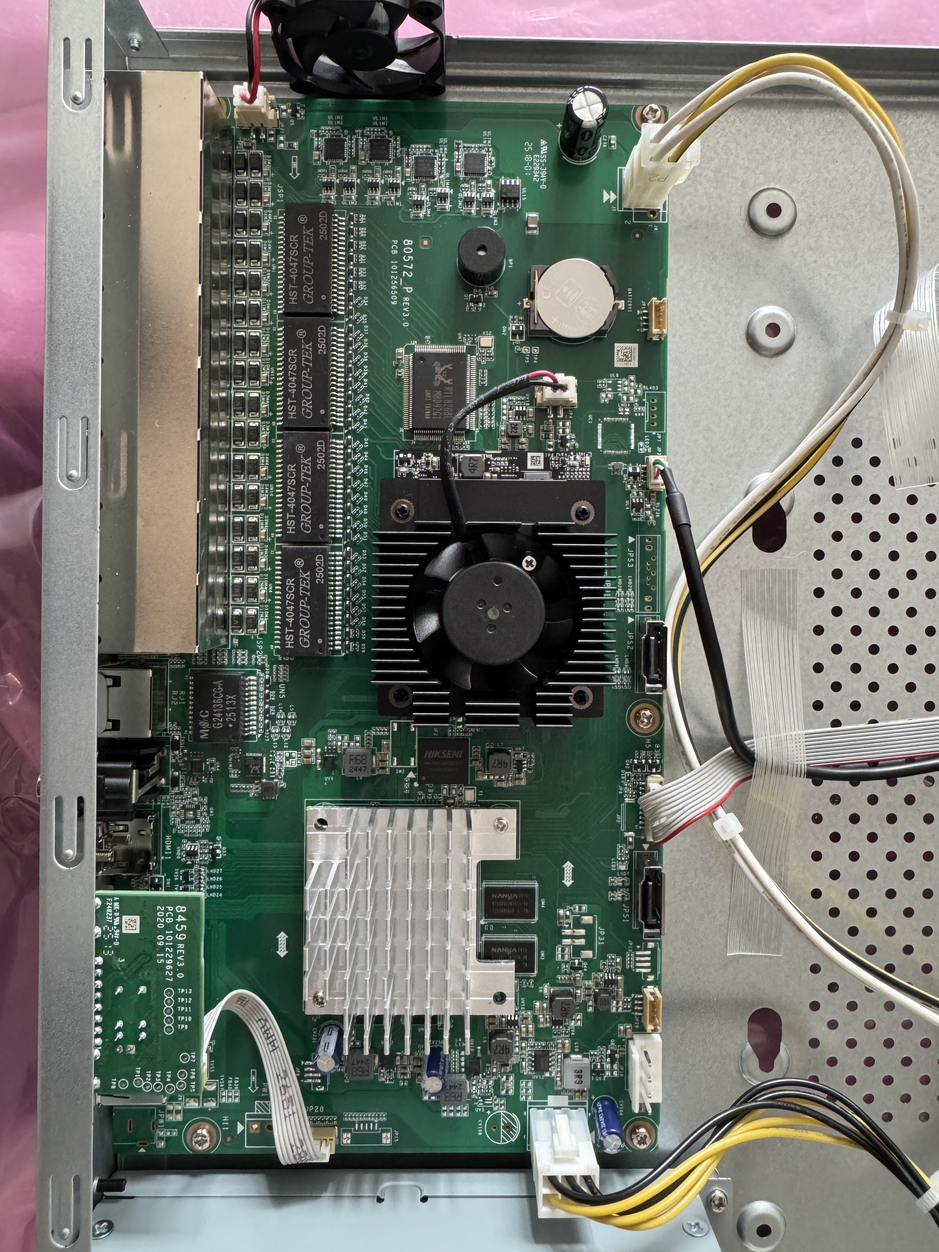

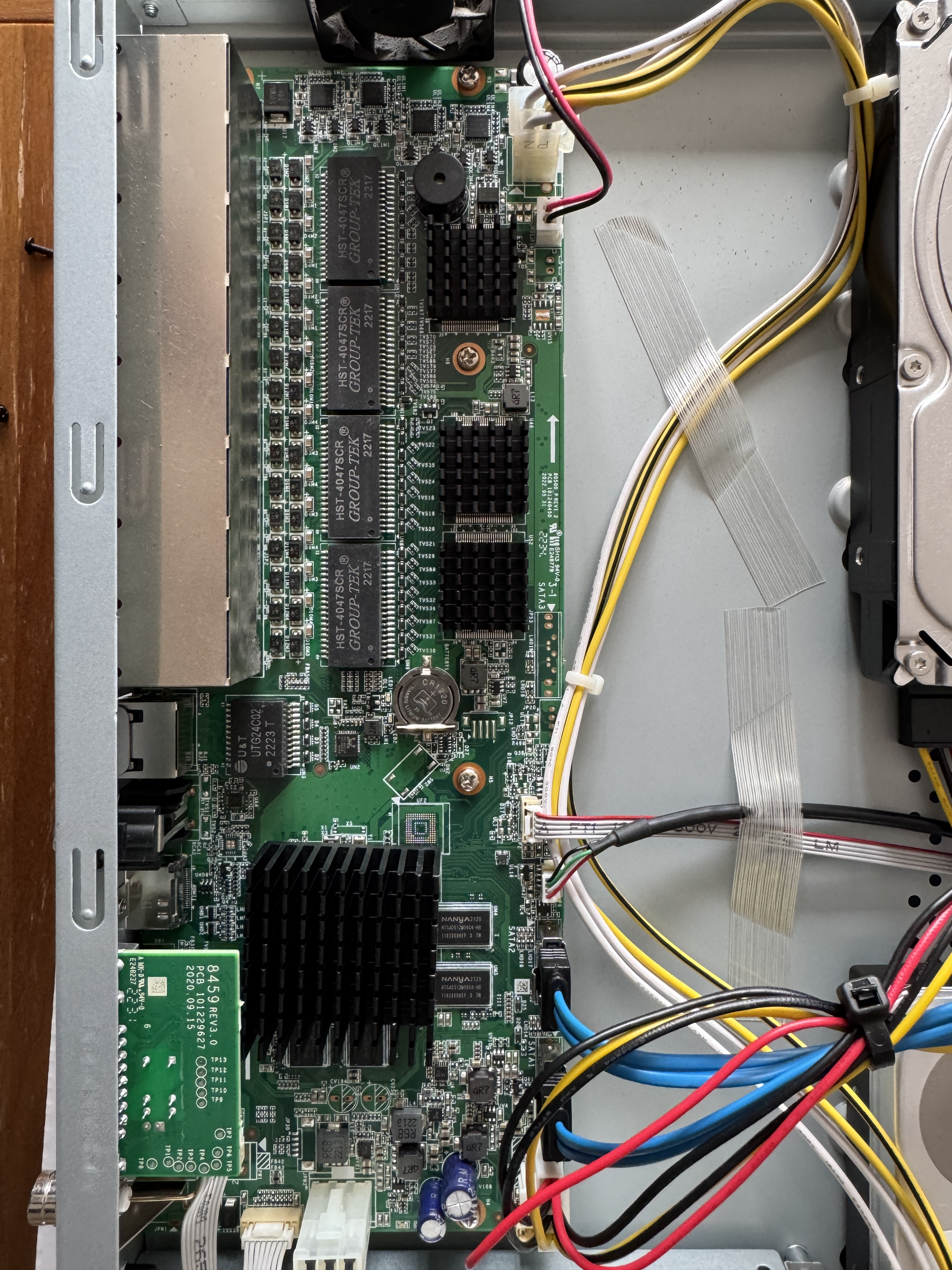

Out of the box it's almost identical to the M model it's replacing, the exception being that the M has a BNC monitor output. Internally the main board is quite different, with an additional processor and fan (M Series left, VPro right):

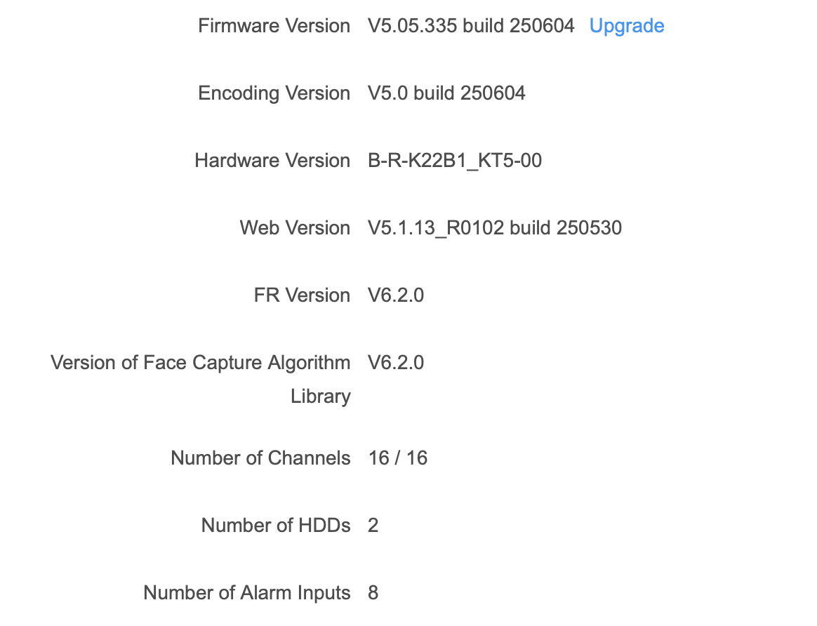

Firmware. The new NVR uses firmware platform K22B1. As yet I don't see any firmware links on the usual Hikvision pages:
It's arrived with version 5.05.335_250604 as above. Although there's no firmware on the UK, Europe, or Global Hikvision sites, a search using the serial number in Hik-Partner Pro has given me a link to 5.05.351_250705 which I'll load today. The release notes for that state that it enables Acusearch and Acuseek searches in the Hik-Connect app.

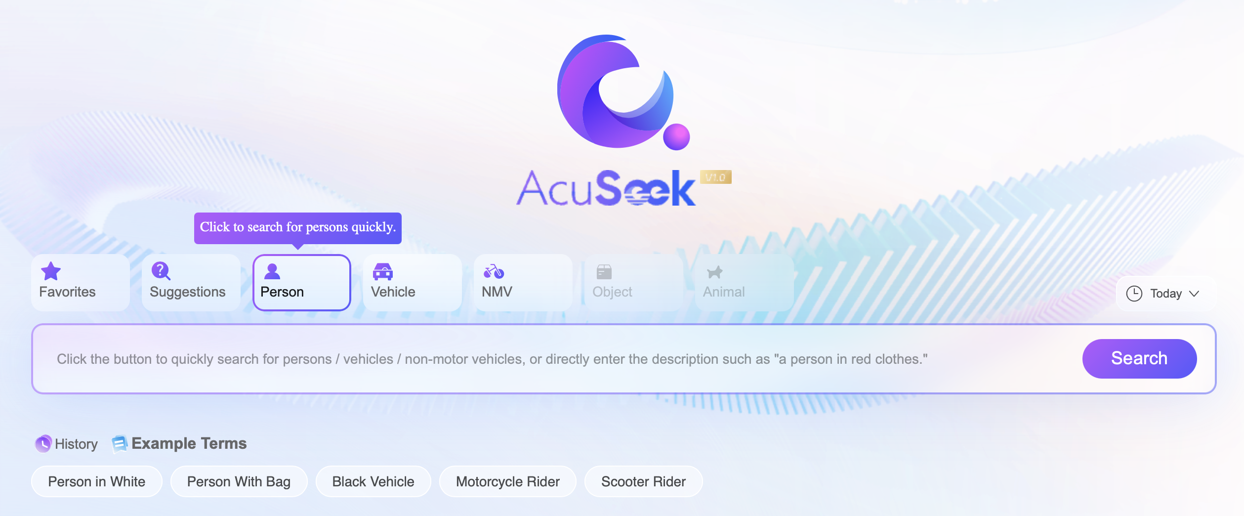

AcuSeek is the ability to search retrospectively through footage for something of interest using plain text. The system can model 300,000 targets per day apparently. Where AI by camera is used, AcuSeek works across all channels. It works with all G5 platform cameras and the new H13, H13U third generation ColorVu's. The NVR has two 'engines' one is used for AcuSearch, the other AcuSeek.
There are a few broad categories to chose from; Favourites, Suggestions, Person, Vehicle, NMV (non motor vehicle), Object and Animal (at this point Object and Animal are greyed out and marked 'coming soon'). Once a category is selected, there are further sub categories. 'Person' offers top, bottom, accessory, behaviour, gender. 'Vehicle' offers type, brand, colour. You can just build your search by clicking the offerings how you want. For instance - Vehicle > Tesla > Red or Person > Black top > Blue bottoms > Sunglasses > Walking Dog. You can search across all or selected cameras and also select a time frame.
I've a 4 megapixel 2347G3 turret with 2.8mm lens and it's successfully identifying vehicles at about 8 metres while looking between our two parked cars. 'Mercedes' correctly brought up all Mercedes that had passed (including a Sprinter van!). While there are suggestions, you can also type what you want. In vehicles there are only around six brands listed so I tried 'Jaguar' and it picked up every Jaguar that passed along with JLR (Jaguar Landrover) models such as Range Rovers. 'Vauxhall' worked similarly well. 'Scooter' brought up both mopeds and people on electric scooters. One thing to note is that some search terms are Americanised; type in 'Estate' and you'll get no results, you need to click 'Station Wagon'. Similarly it's 'Small truck' not Van. Searching for a Person 'on phone' or 'walking dog' worked well too with just a couple of incorrect ID's (it picked up someone who just had their hand to their face, and someone pushing a suitcase (not a dog)
