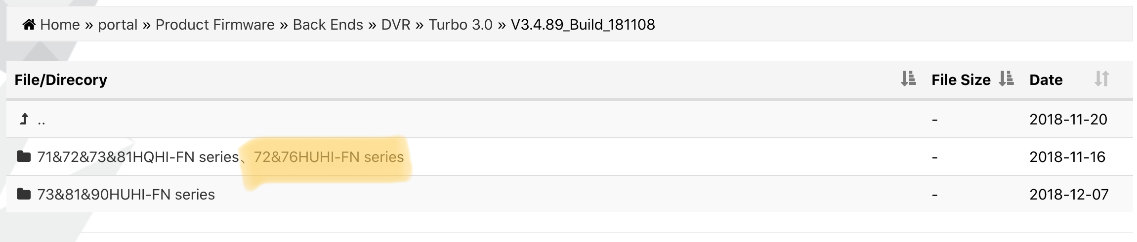

Sorry, my link to the firmware in my last post was broken! It's working now. That is definitely the correct firmware for your DVR, the portal can be a bit bewildering. The part highlighted of the below screenshot refers to your DVR, confirming it is the right firmware:

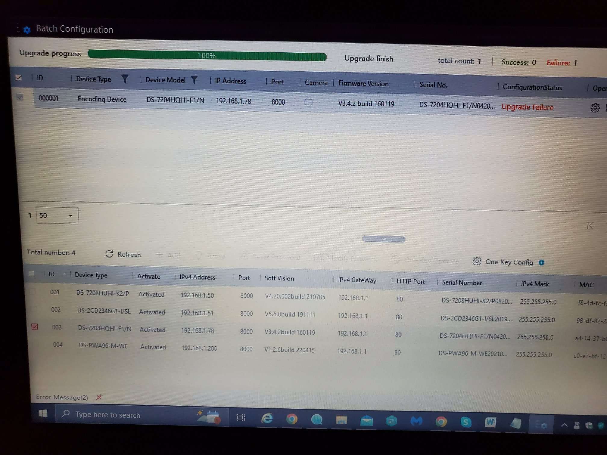

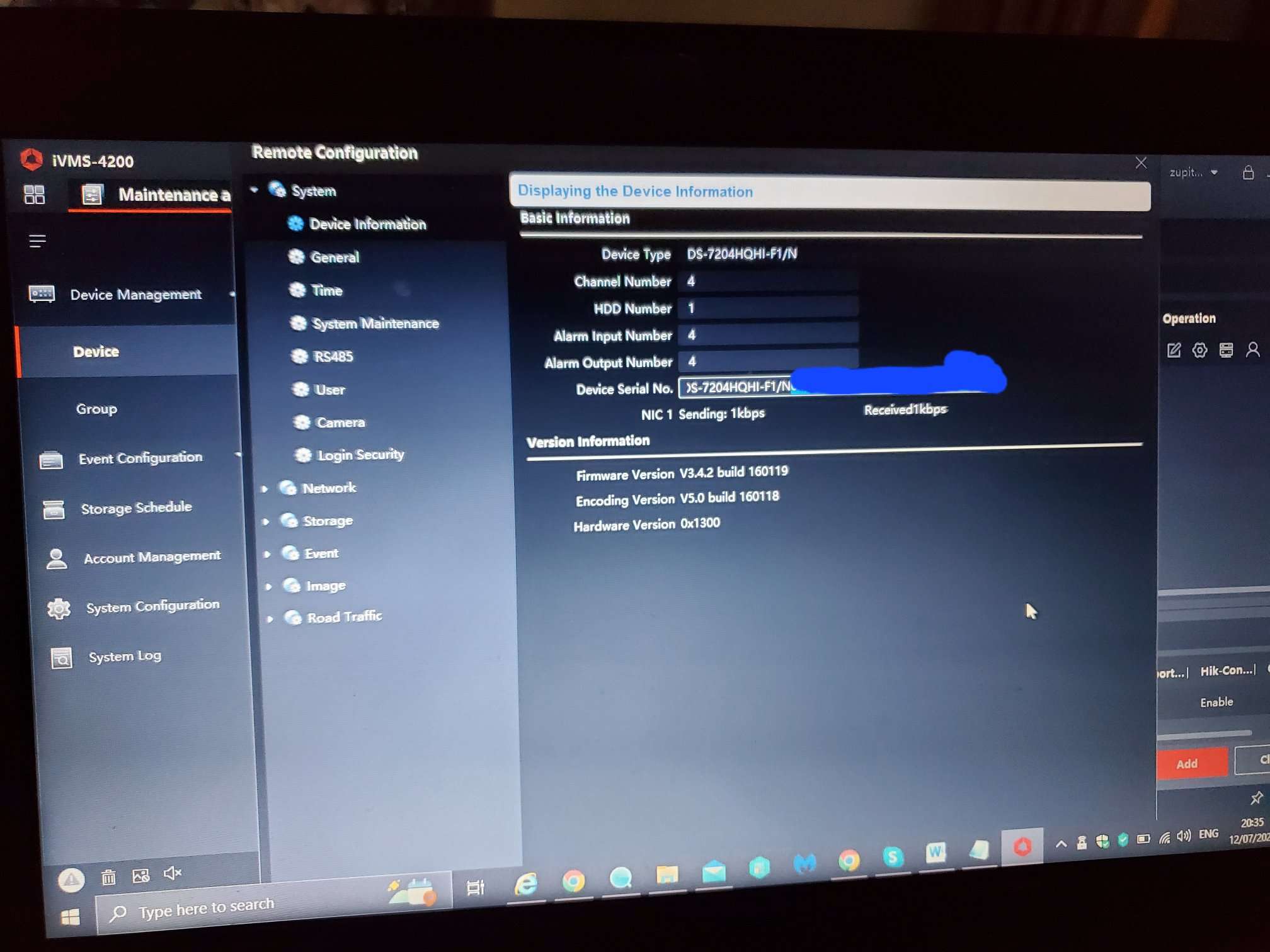

Hi Dan .
Im trying to download this verision ,
but not clearify which is exsaly cause is old one ..
i mean for this DS-7204HQHI-F1/N
i try some of this.. non of this firmware cannot upgrade this mode dvr ,
can you uplowad th link here please ..
Regards Nick

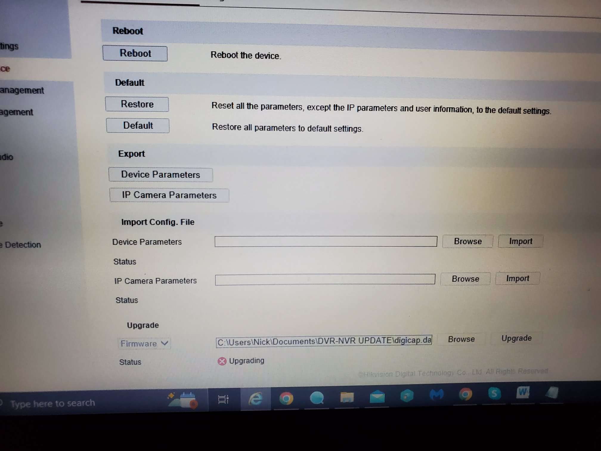

Hi@Dan,
Unfortunately this firmware cannot be loaded to this dvr .
I try many ways ,but not sucssesfull ..
Regards Nick
