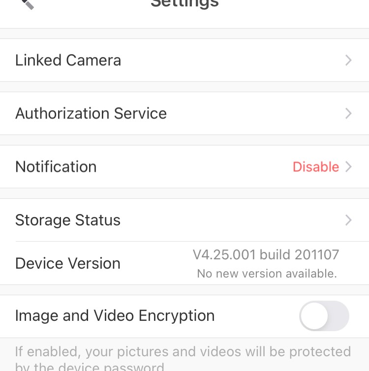

Hi Kyle, yes it is showing that version on hik connect , I am using iOS and i havce deleted the app and reloaded from the app store to make sure its the latest version ? thanks

Thanks for confirming - yes, that should definitely be the latest version.
