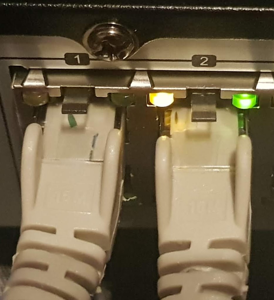

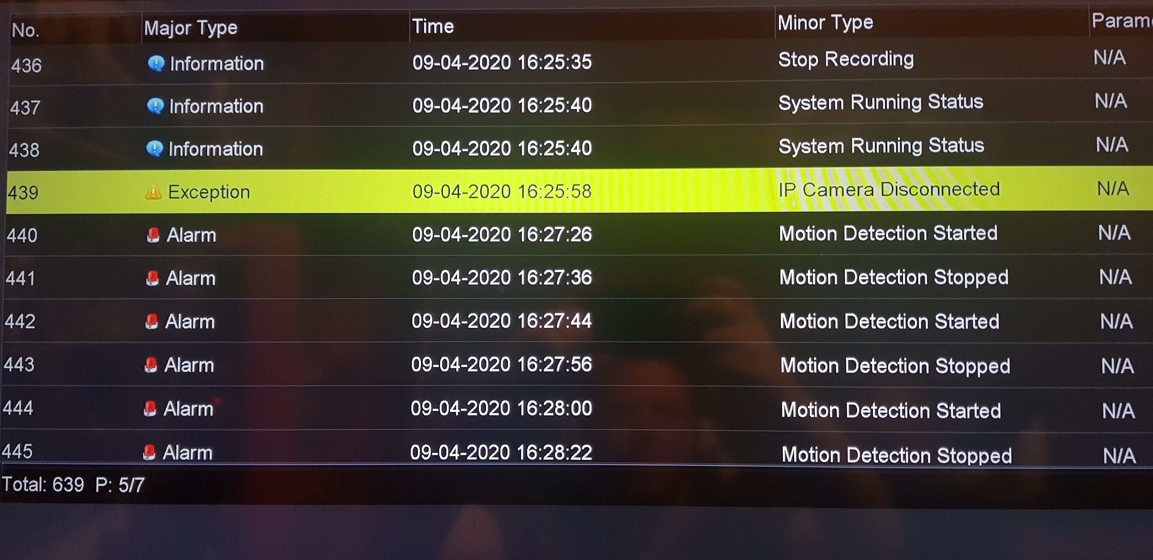

I noticed this camera had lost its feed. I went into my nvr to see what was going on and it stated "Network Unreachable" there wasnt anything i had done to it as im aware of anyway.
I got up the ladders to check the cameras connections and all that stuff. 3 IR lights seem to be constantly lit but there is no issues from what i can see from the cables.
I check the nvr poe ports and camera 1 network lights are not flashing. I then try another port and still nothing. I Disconnect the cables incase i had a faulty one and tried another but still nothing. All the camera shows is the 3 red ir lights being lit. I have tried resetting the camera using the reset button but nothing happens.

A couple of things to check/try
1 - Check the inside of the female RJ45 connector at the camera. Moisture ingress can cause shorting of the pins, burning, corrosion.
2 - Try taking the camera down and connecting directly at switch/NVR using patch cord.
3 - Are you resetting the camera correctly? If using PoE - disconnect the RJ45, push and hold the reset button, reconnect the RJ45, release after about 15 secs.
4 - As a last resort try powering the camera via 12V DC.

1 - yeah i have checked looks brand new from what i can see inside, but that doesnt mean there aint any damage
2 - yes i have already tried this, as stated the 3 IR lights come on and stay on but nothing else happens
3 - yes nothing happens, its like its frozen in a certain state
4 - tried plugging it into a 12v dc but again gets power IR lights stay solid and nothing else happens, its like its frozen and cant boot up.
Hi @AzzaUk
If you have followed @JB1970 steps and you still can't see anything and you are only getting red IR LEDs staying on constantly then I would say that camera is likely faulty, if it is still within the 3-year warranty you can take this information to whoever you bought from and if they were an authorised Hikvision seller they should accept it for return/warranty replacement.
