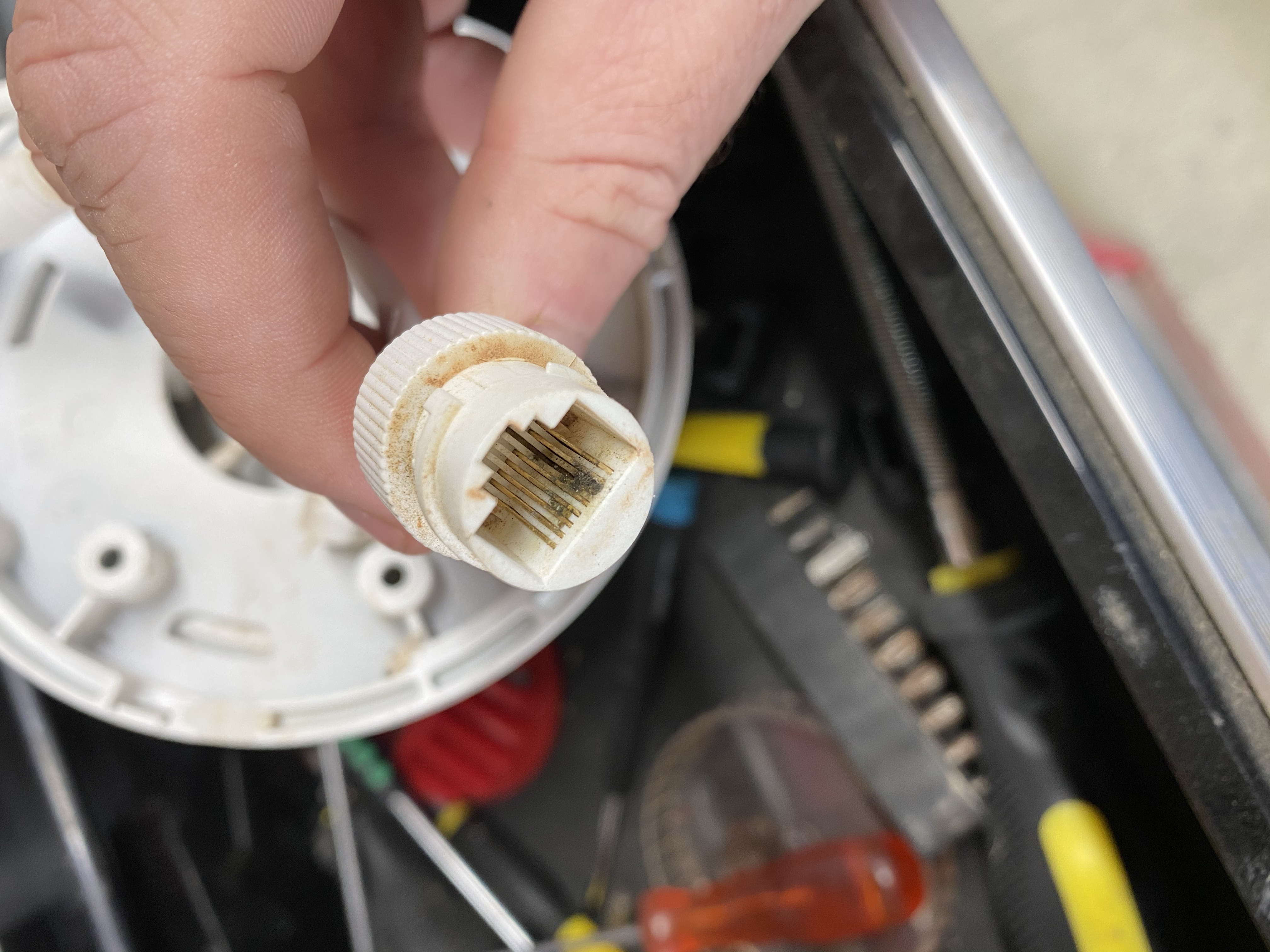

Check the camera end connection first. Moisture can get in the connector housing. If it has you'll likely see the pins of the RJ45 socket look burnt where the moisture has caused a short. If you have a look in the sticky threads, Dan did a post some time ago regarding the need to further seal the connector assembly with self amalgamating tape or similar to prevent water damage.
Hmm. Well you’re right, burnt pins. Strange as I’ve been running Hik cameras for several years now and this is the first one to go. Should need additional protection IMO.

I've had it on one of mine. I gave the pins a careful scrape with a very fine screwdriver to clean them up and it's working fine. I still generally don't seal the connector when installing them - as you say, the enclosure, gasket, compression gland should seal it sufficiently but as Dan states in his post it wouldn't be covered by warranty. There are a few posts on here with the various pinout configurations if you want to cut it off, crimp on an RJ45 and use a straight through coupler.

I’ve seen the pinouts so fingers crossed I can get it working again. The 3rd PIN has completely gone. It’s strange as we moved house earlier this year so that camera has only been installed for 6 months at the current house.

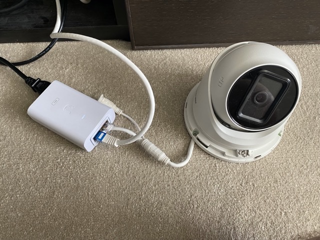

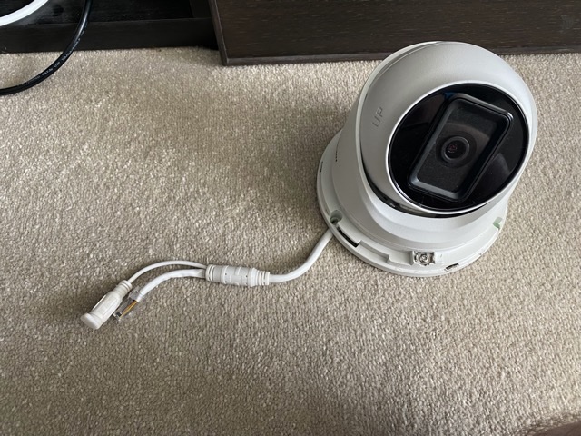

All fixed. New RJ45 connector on it.

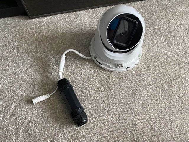

I have a waterproof RJ45 coupler bit it’s pretty big and I don’t want to make the hole in the wall any bigger than it currently is so I’ll have to get a mounting box for it. Unless I can find another, smaller coupler.
