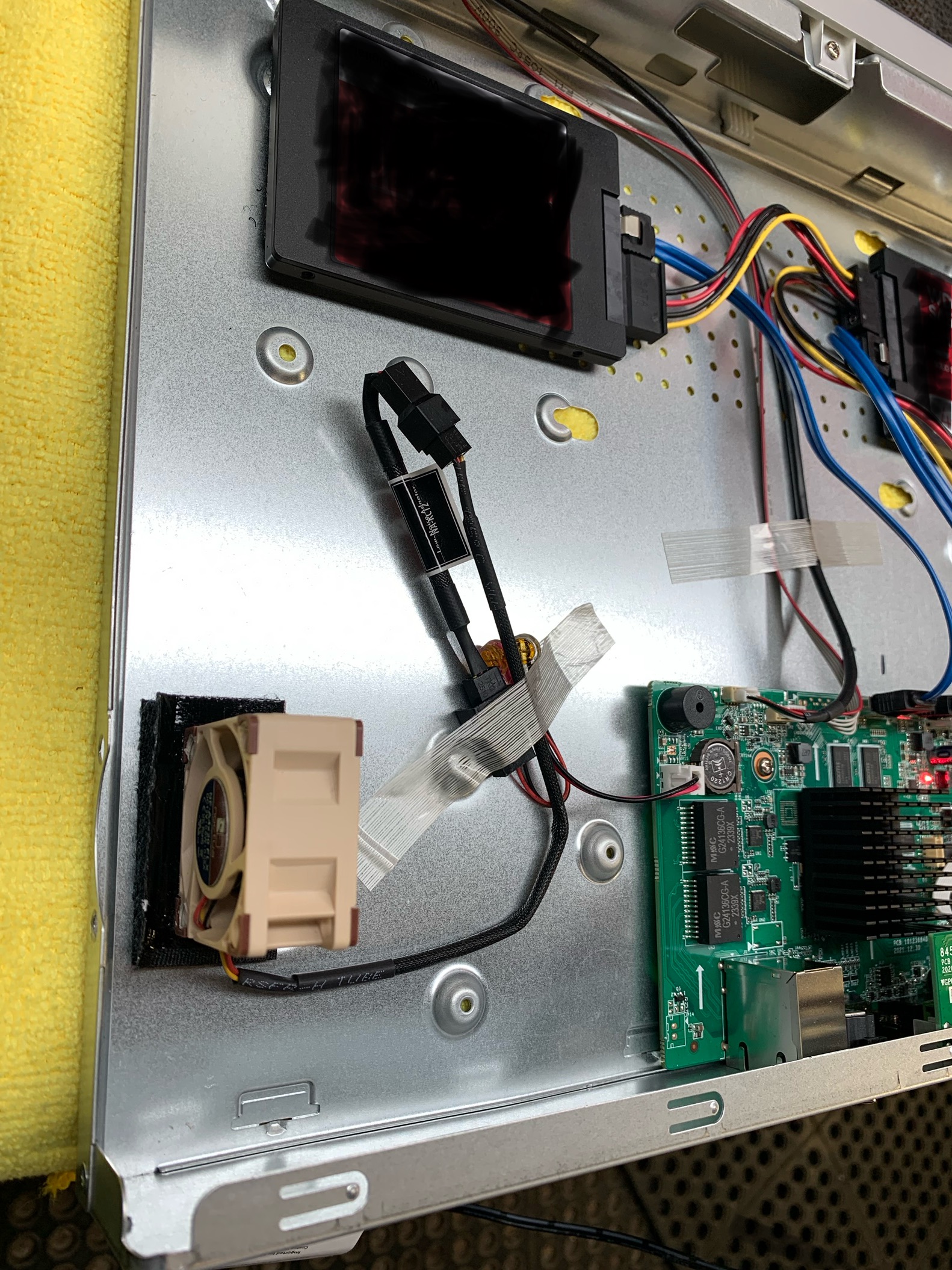

I too feel it’s the air blowing thru the perforated case that’s responsible for the bulk of noise. If you have room inside your case, you might offset the fan by about 1”…… it’s still not silent but it is quieter.
The attached pic is from my non-POE DS-7616NI-M2 with an external PSU. The fan is offset about 1” or so. Your /8P version will look substantially different with the internal PSU and POE ports.
I’m using the Noctua NF-4Ax20 FLX mainly because the NF-4Ax10 FLX was not readily available at the time. The narrower NF-4Ax10 FLX might be better suited for the /8P, but without seeing the internals of the /8P, I can’t recommend one fan model # vs the other. Either may work for you.
Double sided Velcro was used to hold the fan in place.
Of course all this is at your own risk. And your mileage may vary.

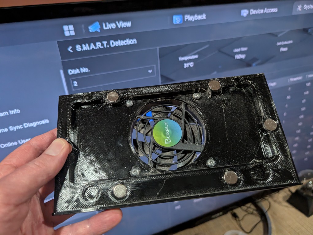

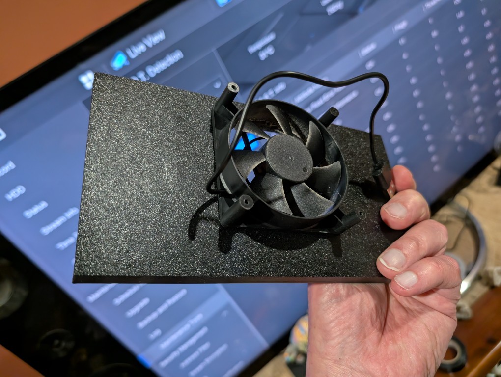

I've got the 7616NI-M2/16P rack mounted and recently designed/ 3D printed a magnetic "fan tray" that sticks underneath the the NVR's base- it blows through the holes in the base. I fitted a USB powered 80mm (?) fan to the tray and it blows air up inside the NVR directly onto the base of the hard drives. That has substantially reduced the hard drive temps in both drives inside the 7616, and it's running all stock fans. (You can see the temps in the NVR's settings menu.)
I tested the temperature difference with and without that fan running tonight. The first temp is with the fan running, and then the second with it removed and checked 1hr 20min later for the no fan temp. I removed the entire 3D printed fan assembly from the bottom of the case to make sure it didn't interfere with the second reading. Ambient room temp was only 22C.
Disk 1 35C increased to 43C (10TB WD Purple - located behind the power supply)
Disk 2 31C increased to 36C (14TB WD Purple)
The fan assembly is pictured below. My NVR is rack mounted so I can attach the fan underneath the case. The USB powered fan was a freebie, so I thought I'd put it to good use.
(There are some differences in the bases of the Hik 76 series NVR cases even though all the NVR's look basically the same. I originally started designing it using my ~6YO 7608NI-I2 case, thinking it would be identical to the new 7616NI-M2. But the pressed metal base is different.)
