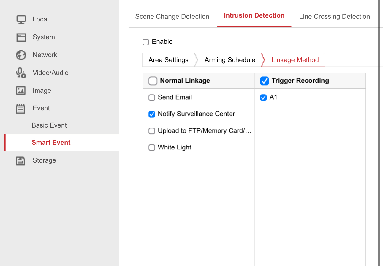

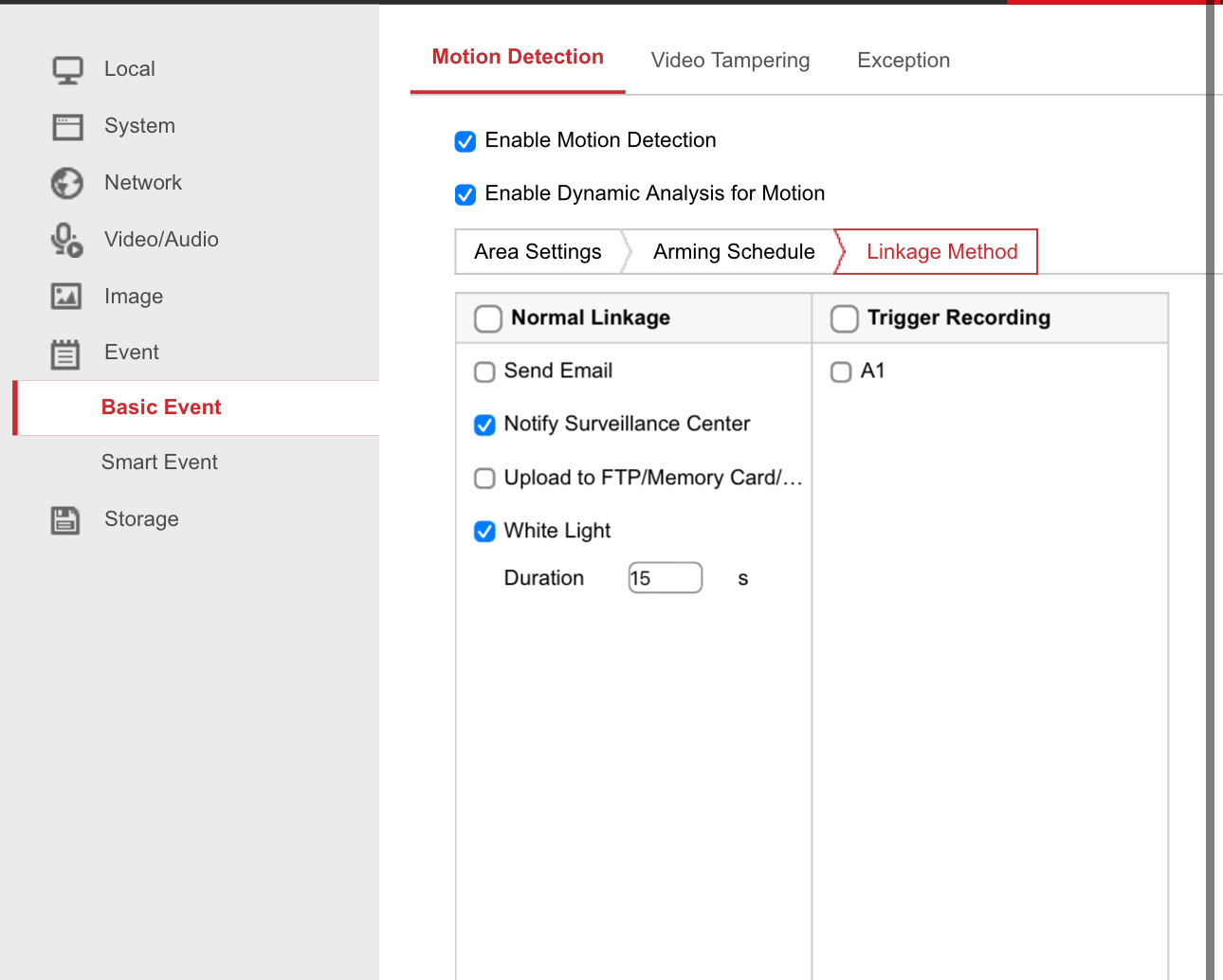

Ok many thanks. I currently have the LU models. Just to confirm this is what I currently have under basic and smart events. Are yours the same on 5.7.15?
