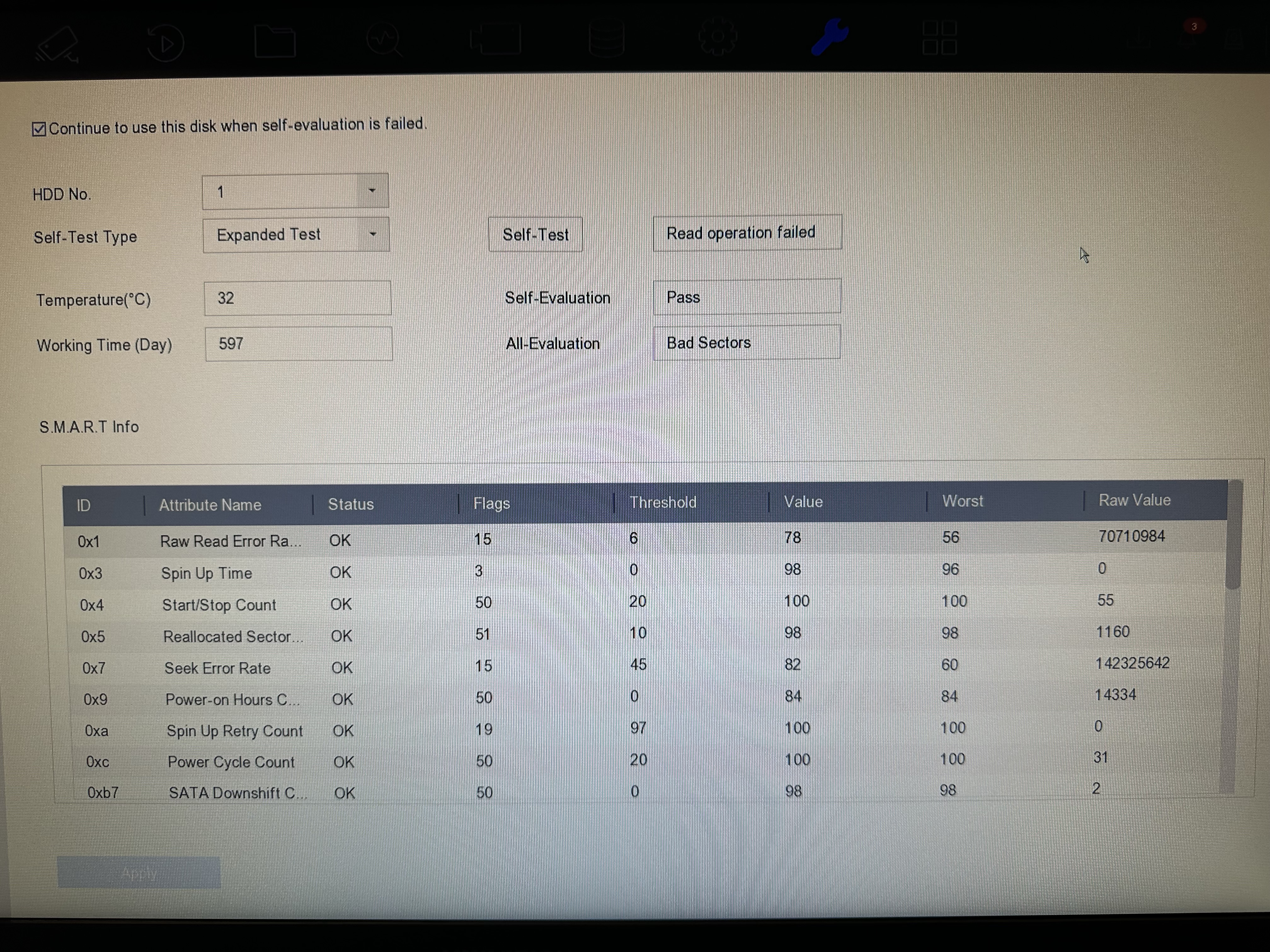

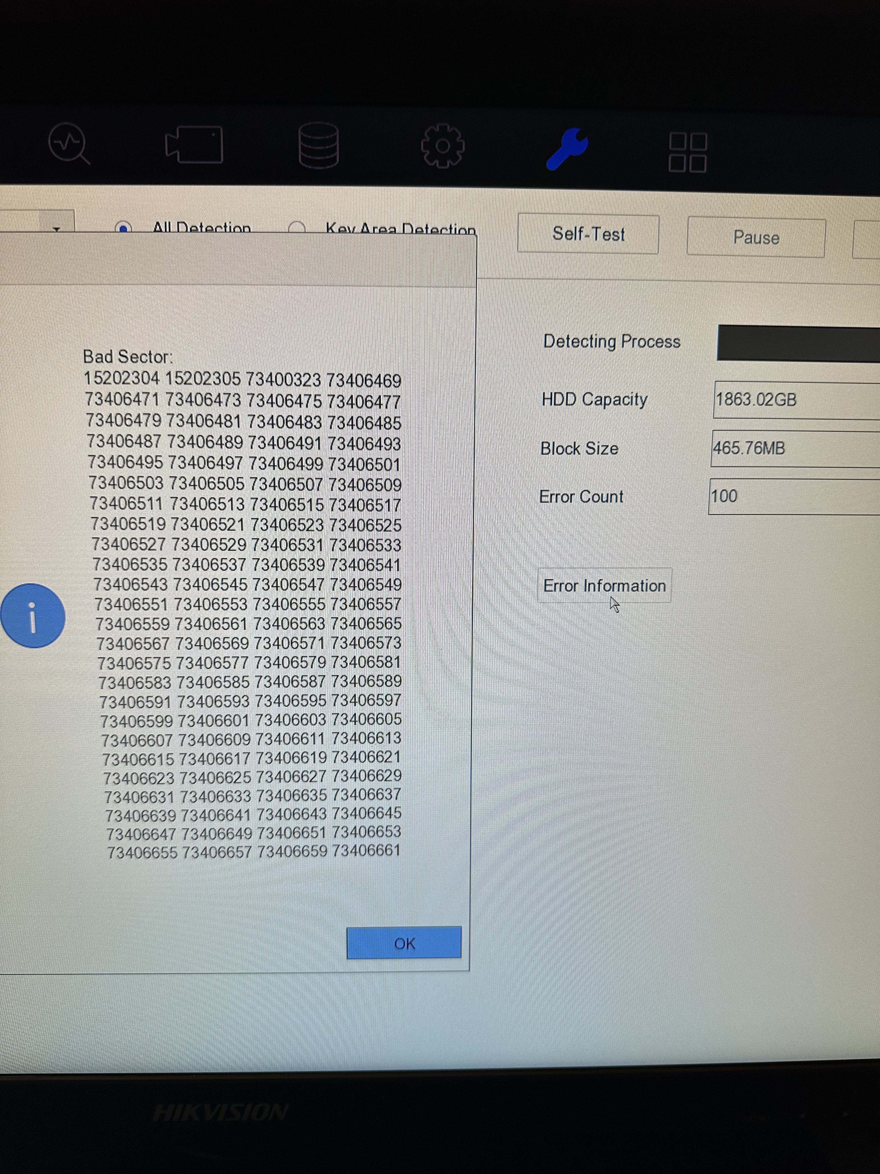

Hi
Just an update…
Did a DB repair which competed.
Ran Sort and Extended SMART tests both give Read Operation Failed
Did a Bad Sector health check - it’s got loads of bad sectors and aborts.
Therefore think I need to replace the hard drive. Need to check if it’s in warranty as installed in September 2023.

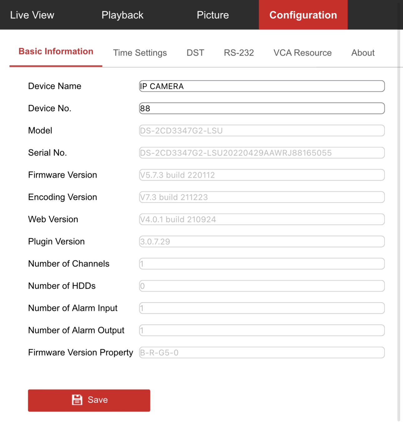

I’ve noticed that the firmware for the NVR and the Colorvu cameras is out of date.
Can you please send me a link to then latest firmware for both and can I install the latest firmware or do I have to install any previous ones before installing the latest. I attach pics of both.

The camera can be updated directly to the latest 5.7.19, the only issue being that Smart Search/VCA Search will no longer work if you want to retrospectively search recordings for anything other than Human/Vehicle. For example "who's fecking cat shat all over my garden last night? I know I'll draw a line adjacent to said turd and have a look" That won't work anymore. So if you want/need that ability still, the latest version you can install on the G5 cameras is 5.7.15.
For the NVR it'll be all change if you update as the latest is the version 5 firmware and everything changes - the look, the menu's, everything. Unfortunately it's not all for the better and you may (like me) end up hating it. Downgrade will restore the NVR requiring you to activate it and set up from scratch. The latest version is 5.04.050_250124. Strictly speaking you should update through a 5.01, 5.02 and 5.03 version first but I probably wouldn't bother.
Latest versions can just be found by going to Hikvision.com for your region then Support > Download > Firmware and key your model number in the search box. Alternatively if you browse the product page and find your model if it's current (the NVR is), you'll find the firmware at the bottom of it's page.
Thanks JB I think I’ll just leave it for now as nothing is broke apart from the HDD replacement. Thanks
