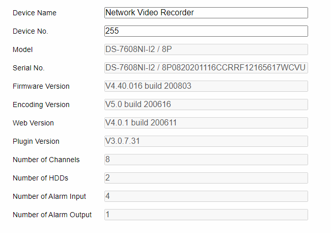

Trying to setup an NVR for my mom.
DS-7608NI-I2 / 8P
Firmware V4.40.016 build 200803
Have a camera that is mounted upside down but did not spot a mirror option in the settings -> image location.
Can someone let me know a good upgrade path to get to latest stable release?

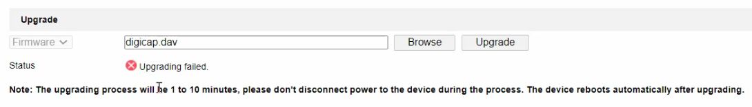

This looked promising but I am getting
Following @Dan suggestion of upgrade path
V4.1.10 build171107 -> UPGRADE FAILED

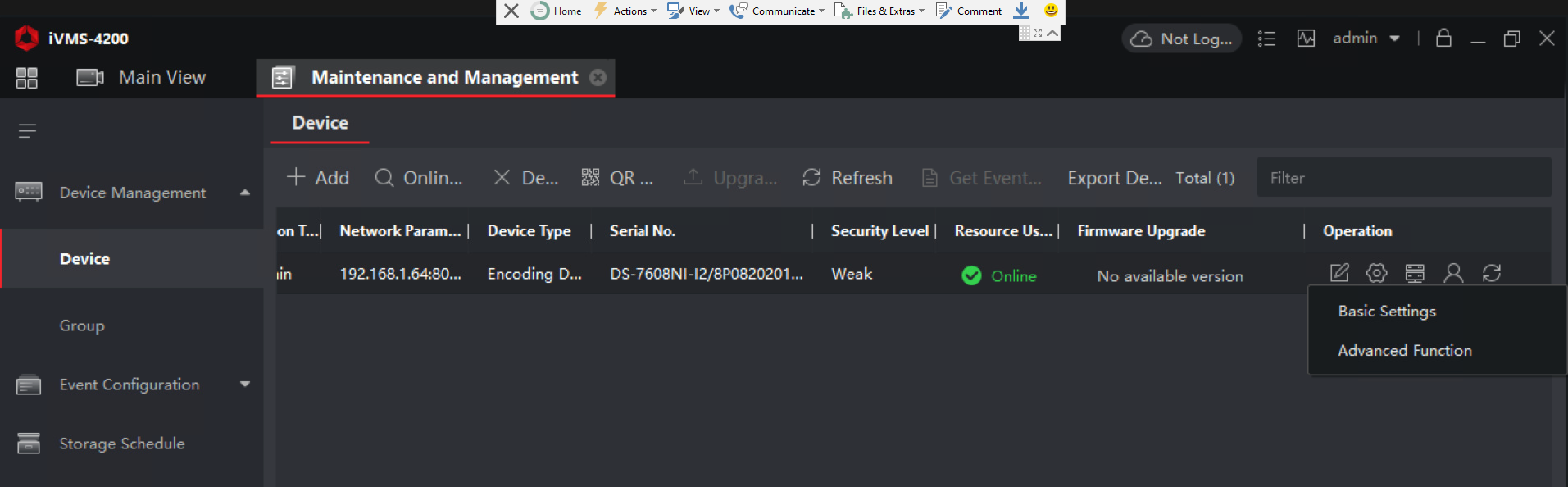

I see where I went wrong, went below my current running.
V4.1.10 build171107 -> NA
V4.1.60 build180717 -> NA
V4.22.005 build191208 - NA
V4.40.017 build 201124 - COMPLETED
V4.51.025 build210927 -PENDING
V4.60.005 build220108 -PENDING
V4.51.025 build210927 -COMPLETED
V4.60.005 build220108 -COMPLETED
V4.61.000_220507 -COMPLETED
V4.61.025 build220905 -COMPLETED

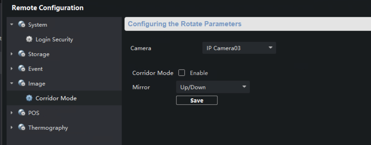

However, I am still not seeing an option to rotate the image.
Found how to do it!!
Settings -> Advanced Functions -> Image -> Corridor Mode -> Mirror Up/Down
