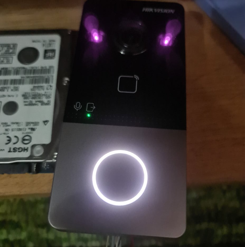

I did manage to restero default settings in web browser tryed another sd card, put it in and power now it is constantly white light is it just wait?
