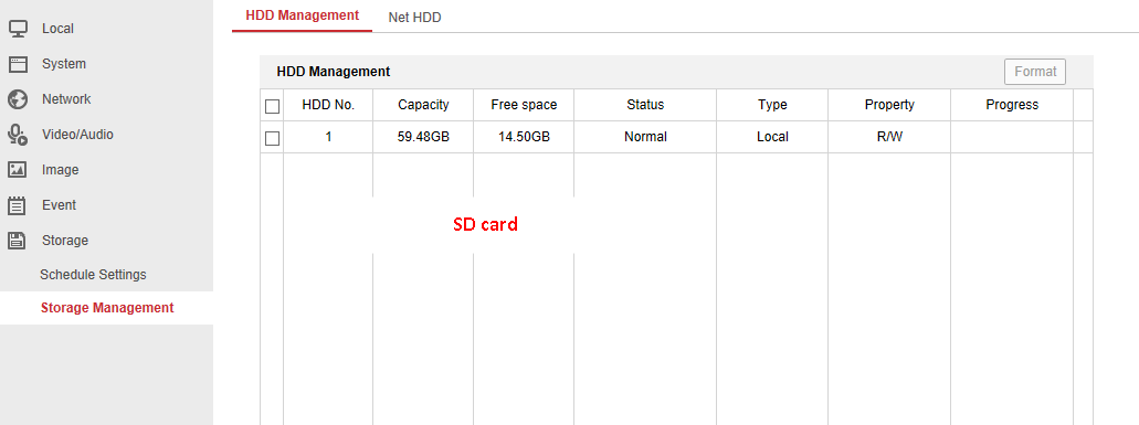

You can set up events and email notifications upon their trigger on your camera, even if they are directly connected to an NVR's PoE ports, but you will need to have microSD cards in each camera for the images to be saved to before they can be sent out.

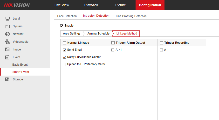

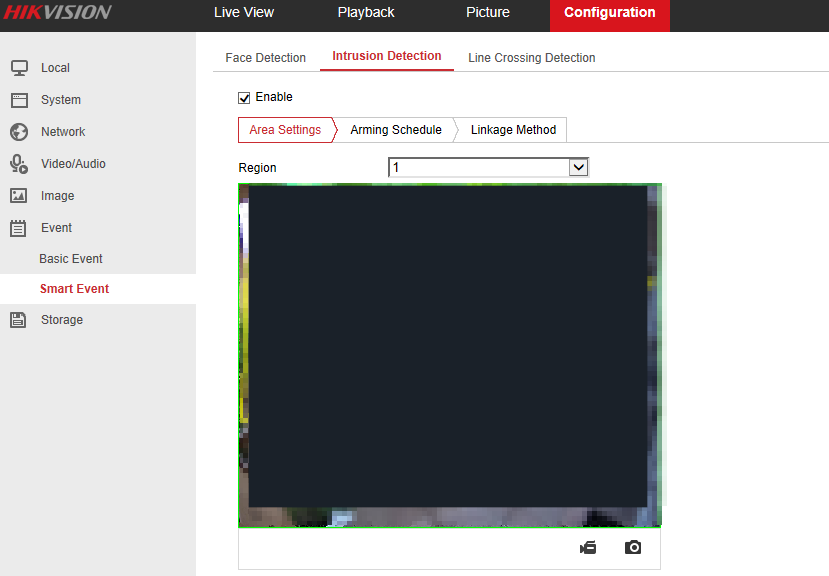

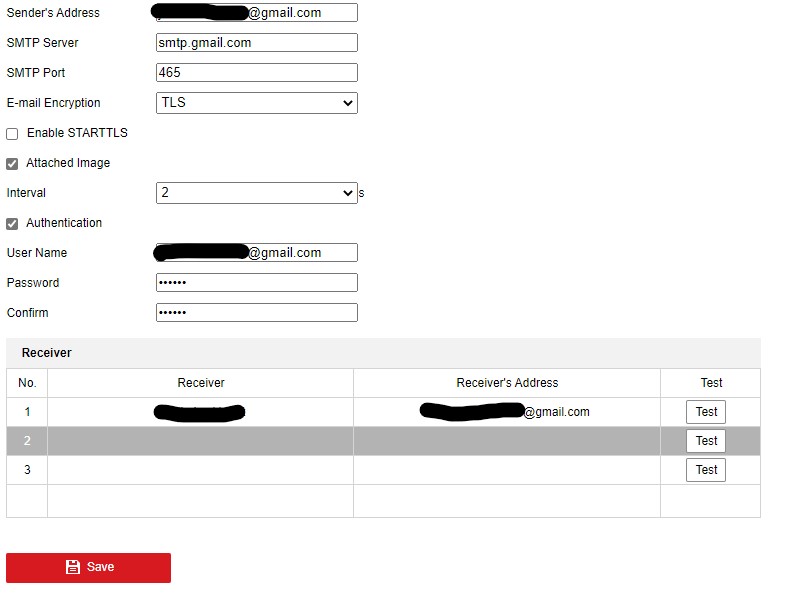

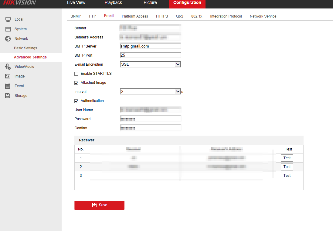

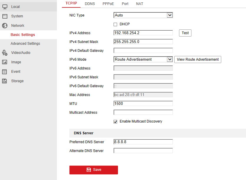

hello @Kyle. Would you be able to provide screenshot on configuring the alerts directly from the camera, as I'm struggling with setting this up. I have enabled NVR's Virtual Host feature and Test emails directly from camera, as it complains about a missing Gateway (error The network gateway is not configured, and this may cause the failure of email sending - sending a test email) . Each time I add the router gateway to the camera it prompts to restart the camera and the gateway setting that was saved disappears. See my config;
Hi
On your email setup, change the SMTP port to 465. Email encryption TLS. And then click TEST. Should work. That is my setup.
As you have a SDCARD installed, on the Intrusion linkage, click Upload to FTP/Memory Card. You can also select Trigger Recording so that a video of the event is also recorded to the SDCARD.
That should be sufficient for you to get emails with a screen capture.
However, there is also options, under Storage/Schedule Settings for capture with a schedule that can be set and for Event Trigger captures which might help.

I have the same problems with the gateway that is deleted again after entering and rebooting. Is there a background why this is so?

Hello Martin, I have entered the SMTP and port correctly, but nothing goes out because the default gateway cannot be specified. Does it work for you and which network settings are necessary?
Not sure where you issue is. I do not specify any default gateway on the email setting page. This is what I have.
Senders address and User Name are the same. Receiver Name/Address is recipient of email.

It does not work for me, so I suspect only the NVR is reached, but no services behind it.
Have NVR "DS-7608NXI-I2/8P/S" with 2 cameras "DS-2CD2686G2-IZS".
Firmware of NVR is "V4.40.416".
Cameras are powered by PoE switch of NVR, get IP over it although Manuel and no DHCP is set in camera network settings. Actually NVR should be gateway for the cameras (i.e. forward packets to the outside) but this does not seem to work.
Do you have your cameras also connected to the NVR switch or are you using something else?
CAM Network
