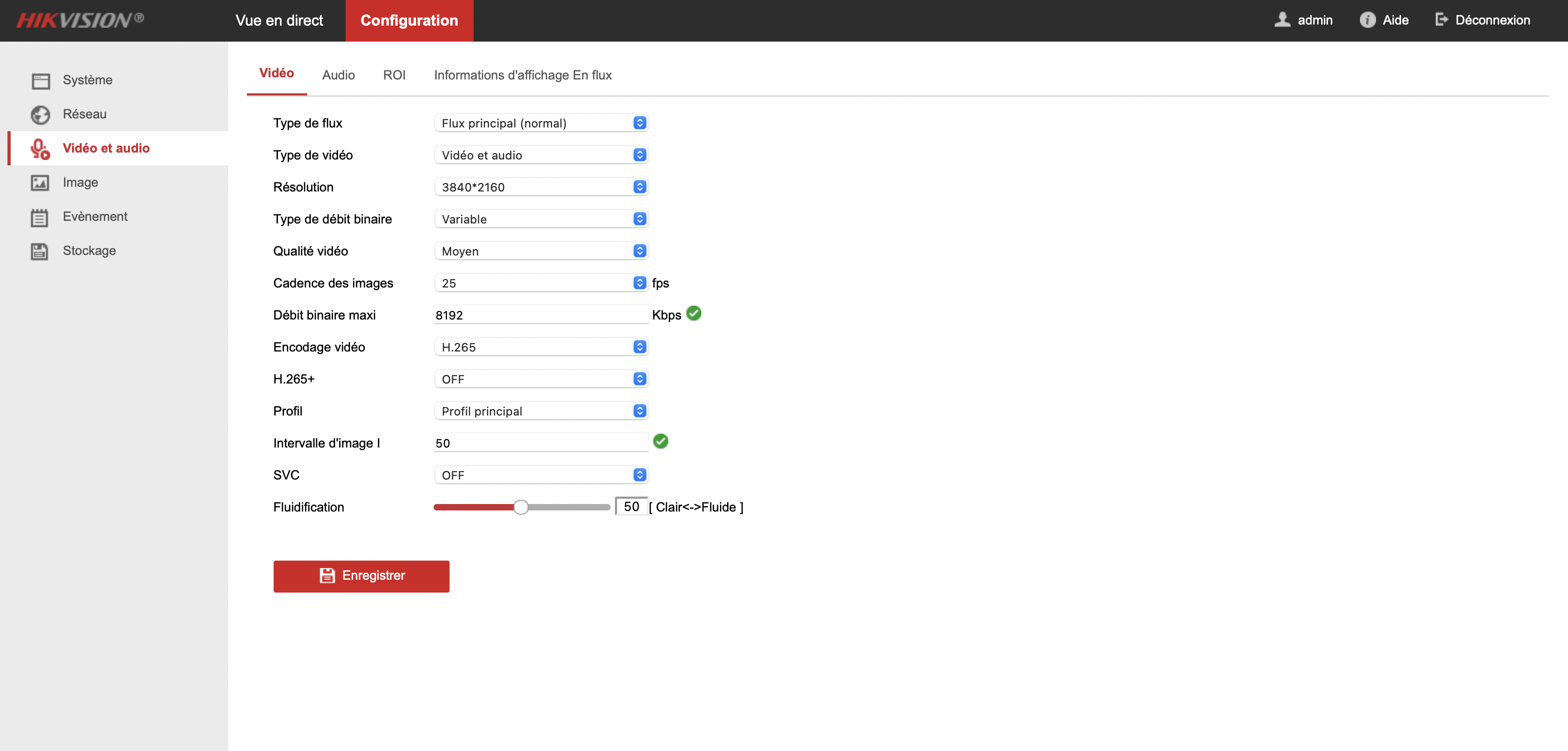

  4. For the affected camera - Encoding (H264/H265 etc), VBR or CBR, Frames per second, Bit rate (easiest just to screenshot the whole page and post it) Shutter Speed.
Hey,
thank you for your reply !
1.The NVR model is DS-7608NI-I2/8P and the firmware is V4.60.005 build 220108.
2. There are 8 cameras on the NVR (3 4K cameras, 5 2K cameras).
3. Affected camera: DS-2CD2686G2-IZSU/SL Affected camera firmware: V5.7.10 build 220830, it is connected to channel 3 of the NVR.
4. See settings screenshot. (Shutter Speed 1/50, HLC:ON 50)
Thanks in advance for your help and advice :)
Julio.

4 - The settings in your screenshot look fine - 8192 is the recommended bit rate for that resolution at H265 and the quality setting of medium will make it less likely to burst excessively above that bit rate. Shutter speed is fine. I would try switching off the HLC completely to see if that effects your issue (HLC, BLC, WDR all require more processing from the camera)

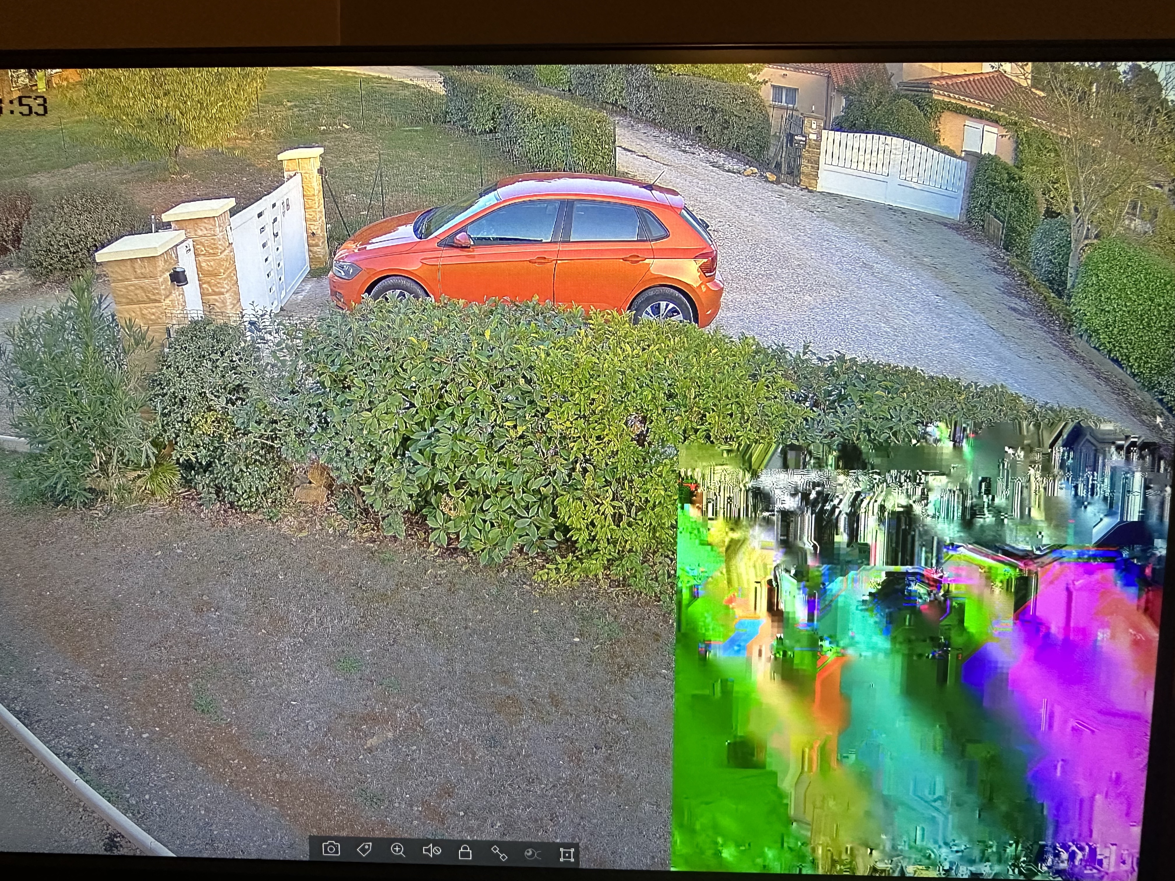

Hey,
I changed this camera a while ago because I needed the Live-Guard function because I have some neighbors who are a little too curious.
And I remember because it was a very short time ago that the front camera didn't have this problem.
So I think there is a problem with this one, and I just noticed a last one today I met you a picture taken of what is happening on the continuous recording image.

Hey, after being able to study the recordings better, guess what?, this actually happens on the 3 4K cameras but not on the others. I am waiting for the hard drive I ordered hoping that it will be better...
