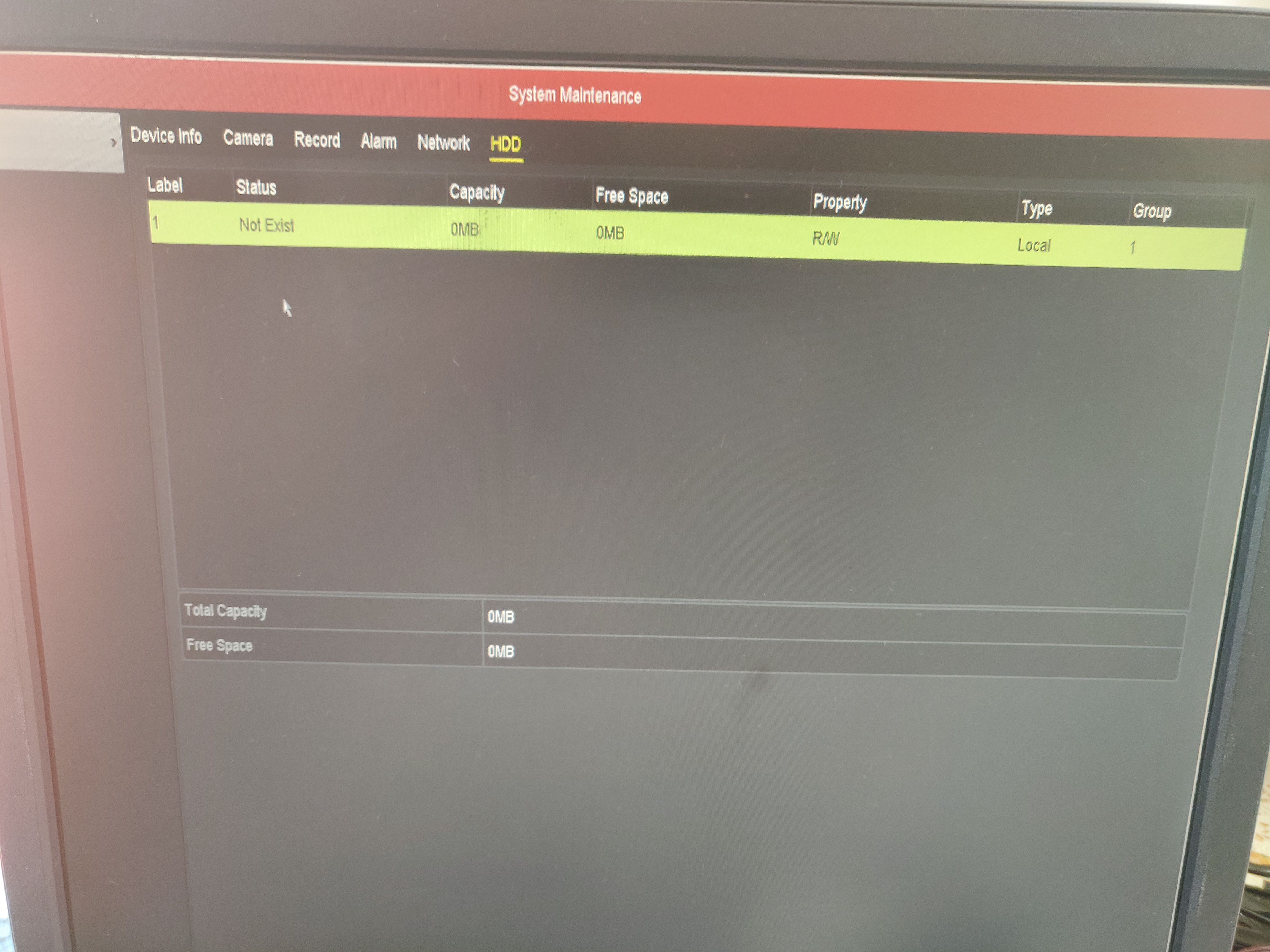

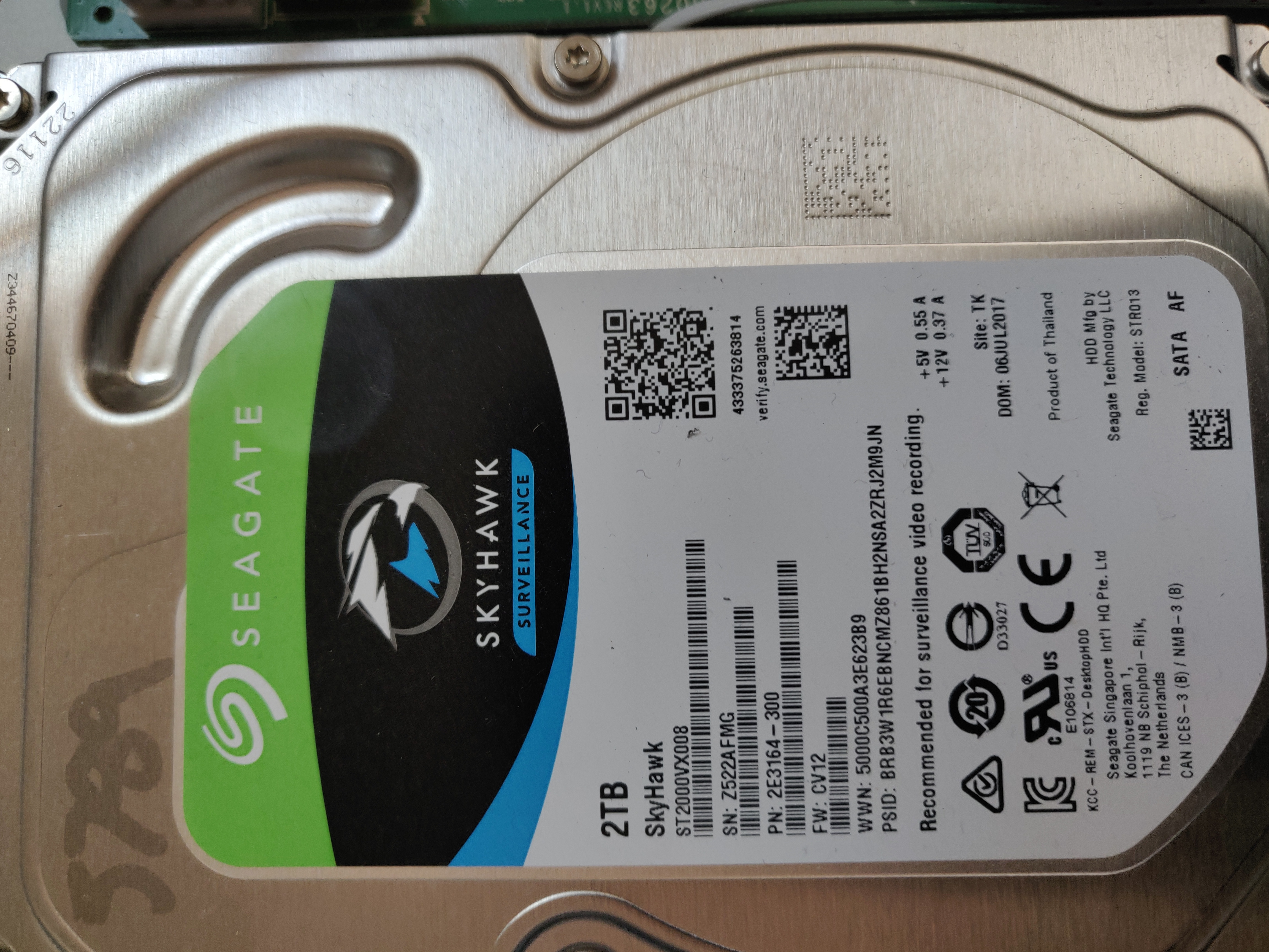

I have a Hikvision NVR with a Seagate 2TB hard drive (Green). I've had this for two years without any issue. However, yesterday I had two power cuts and since then the NVR isn't recording as the HDD is seen as Not Exist. I have tried to format it but it doesn't do anything.
I try to connect this HDD to the laptop although it recognises it, I can't not see the drive for it.

Hi @Fadburty
I would recommend shutting the NVR down, disconnect the HDD, then power the NVR on without the HDD, confirm in the HDD menu that there is no HDD showing. Once you've done that shut it down again and reconnect the HDD before powering it on.
If after doing this the HDD still isn't recognised I would suggest doing a full reset of the NVR and start from scratch to see if the HDD is recognised when first setting the NVR up.
If it still doesn't work after that then it may be that the power cuts and unexpected shutdowns have caused a fault in the HDDs

At the moment I have rebooted the NVR without the HDD init - the Not Exists still appears...
I will give a full reset next...but I'm not feeling brave enough to set it up again

I have spoken to Seagate and the HDD is no longer working must have been due to the power cuts. As it's under warranty they will send out a replacement.

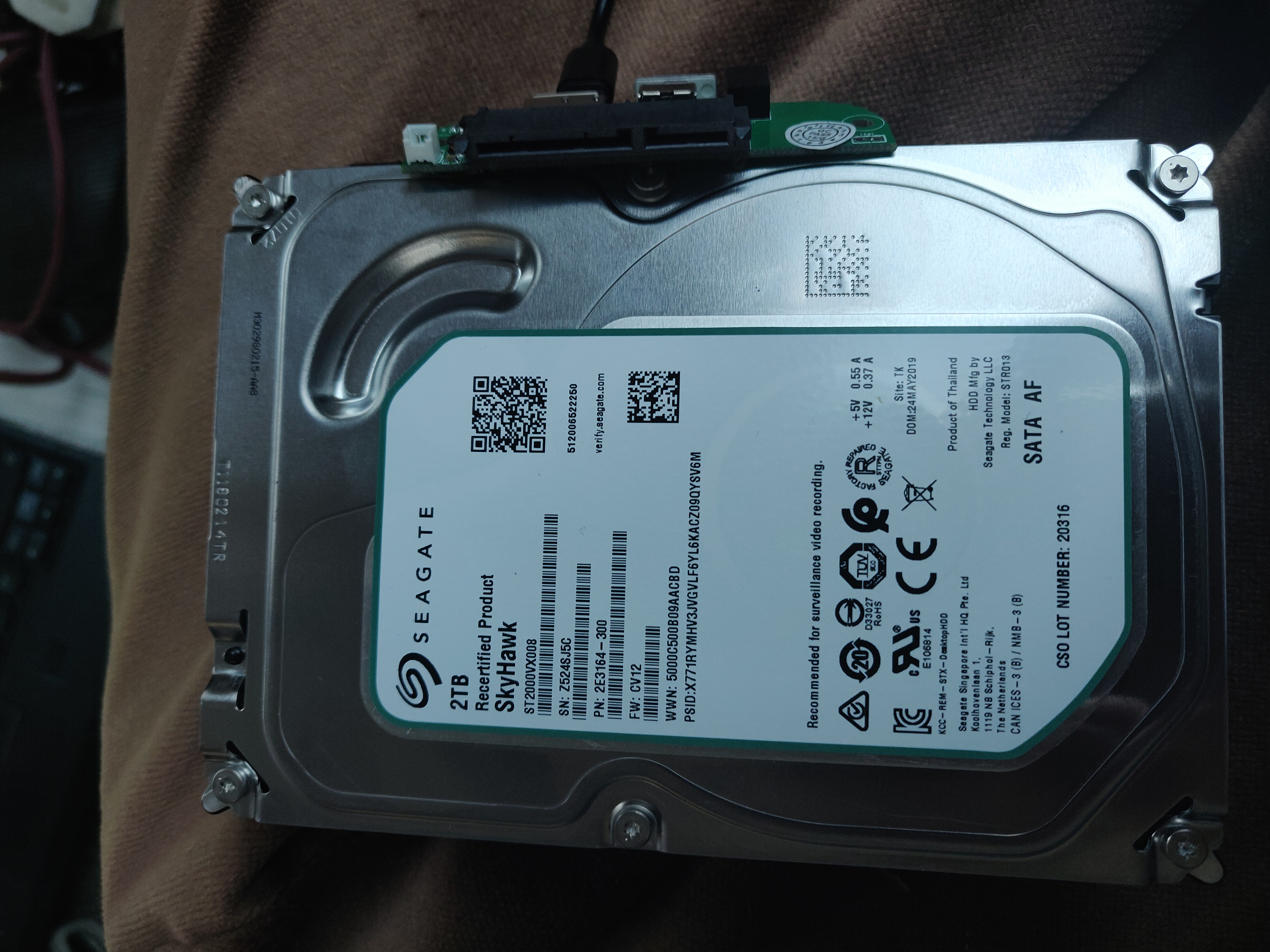

Hi Dan
I received a new hard drive as it was under warranty. However when I connect it to the NVR it's not being recognised. Am I suppose to format the HDD via laptop before installing? Thanks

Hi @Fadburty
No, you shouldn't need to format the HDD before installing. Usually, the NVR will detect the new HDD and then give a continuous audible sequence of beeps until you go into the storage menu and format the HDD, but if it is not being seen at all then it is likely an issue with the HDD.
I see from the picture it is a recertified HDD, this could explain it as refurbished/recertified HDDs may be more prone to issues & failures.
