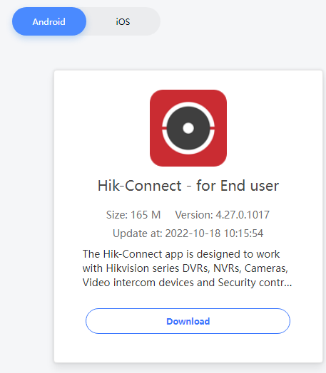

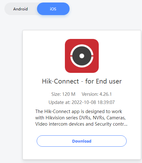

That new App release from yesterday seems to be only for Android?
The IOS release is still 4.26.1 from 10 days ago:
Those are just the hyperlinks from HikVision, apple app store obviously has the 4.27 version, it was released there on the 18th. (perhaps some regional differences are there in the app store, over here in NL it at least updated to 4.27)

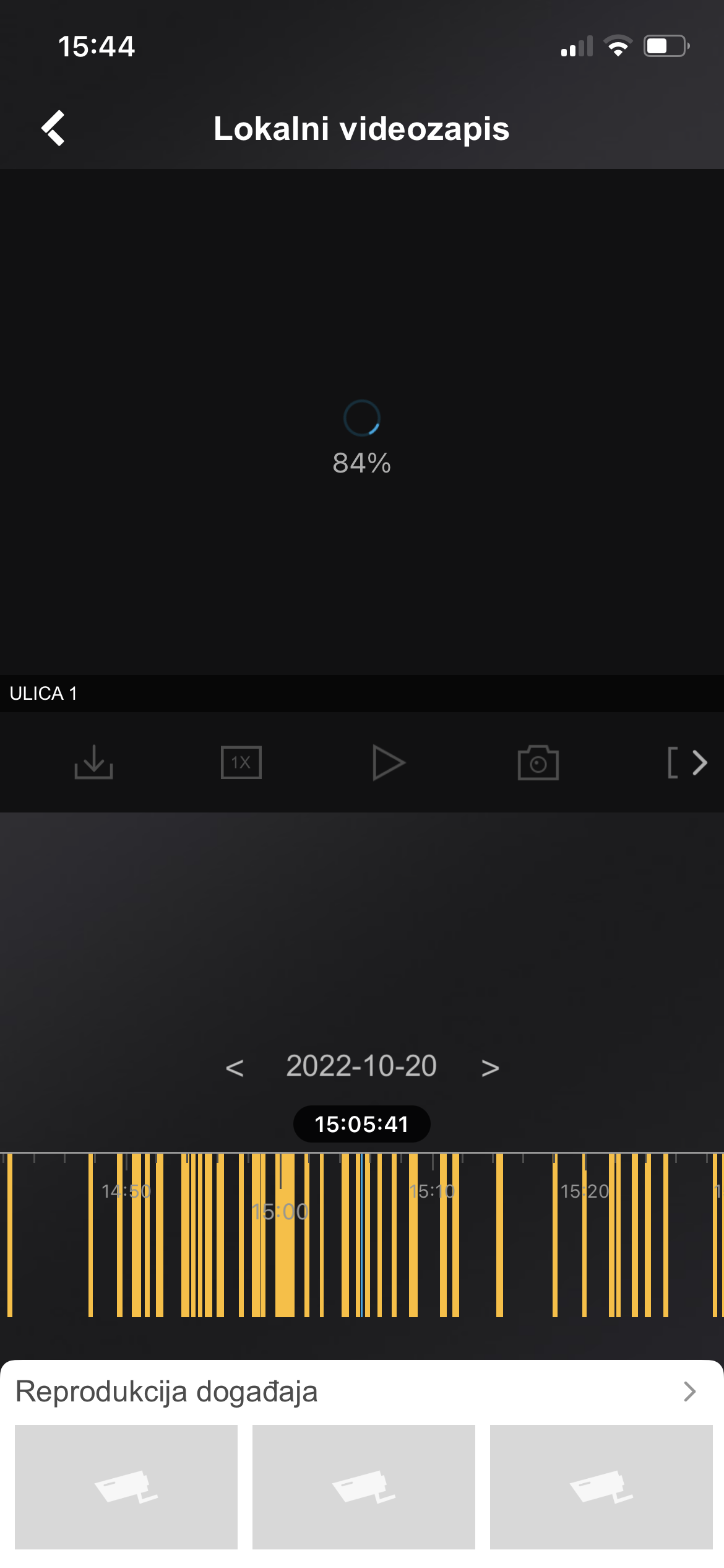

I already mentioned it in another topic, here I will ..
Iphone 12, iOS 16.0.3, version app 4.27.0.
DVR is 7204HUHI-K1, firmware 4.25.001
There is a big bug, I can no longer see anything recorded under playback, although the dvr records properly and I can view it when I connect directly via the ip address. I tried deleting and reinstalling the app, it doesn't help. Are you having problems?

Hi, iPhone 13 (IOS 16.0.3 here / DS-7608NXI-I2 / S) Yes i think i see the same issue. Playback from the dvr indeed no longer provides the ability to playback individual events, just the complete timeline (with selectable blocks on the whole hour) while the previous version had the ability to select individual events. Playback from the app on individual camera's i see as an improvement because of the way you can select events.
TIP: Quickly Install the hilook app while you can. (its the blue version of the hiconnect) its 100% identical but hasn't received the update yet and as such it works like the 4.26 version of hiconnect.
Thx
I Install hilook, there work like hikvision, but before this update.
I added the device via IP address, locally. So the playback device added works perfectly in that way.. maybe it can help solve my problem.
