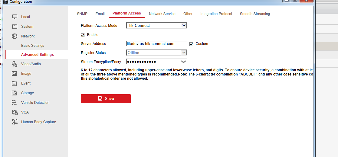

Ive pretty much givin up on getting my NVR on hikconnect
Ive gone through the pinned thread: All seems correct
Ive tried everything
Ive pinged the server dev-hik-connect.com Worked fine
I used telnet, it displayed the blank screen as it should
I just cannot get the Register status to go onto online no matter what i do
Would really appreciate some help
Im sure you guys will want some screenshots, just let me know what you want and im happy to provide
thankyou in advance

ive tried litedev.us.hik-connect.com litedev.hik-connect.com and also dev.hik-connect.com

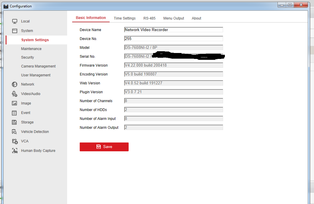

The NVR is a DS-7608NI-I2/8P
Firmware is 4.22.000 Build 200418
Had firmware 4.1.64 Build 190726 before that and same issue
Also to note i am in Australia, in case that changes server address's etc

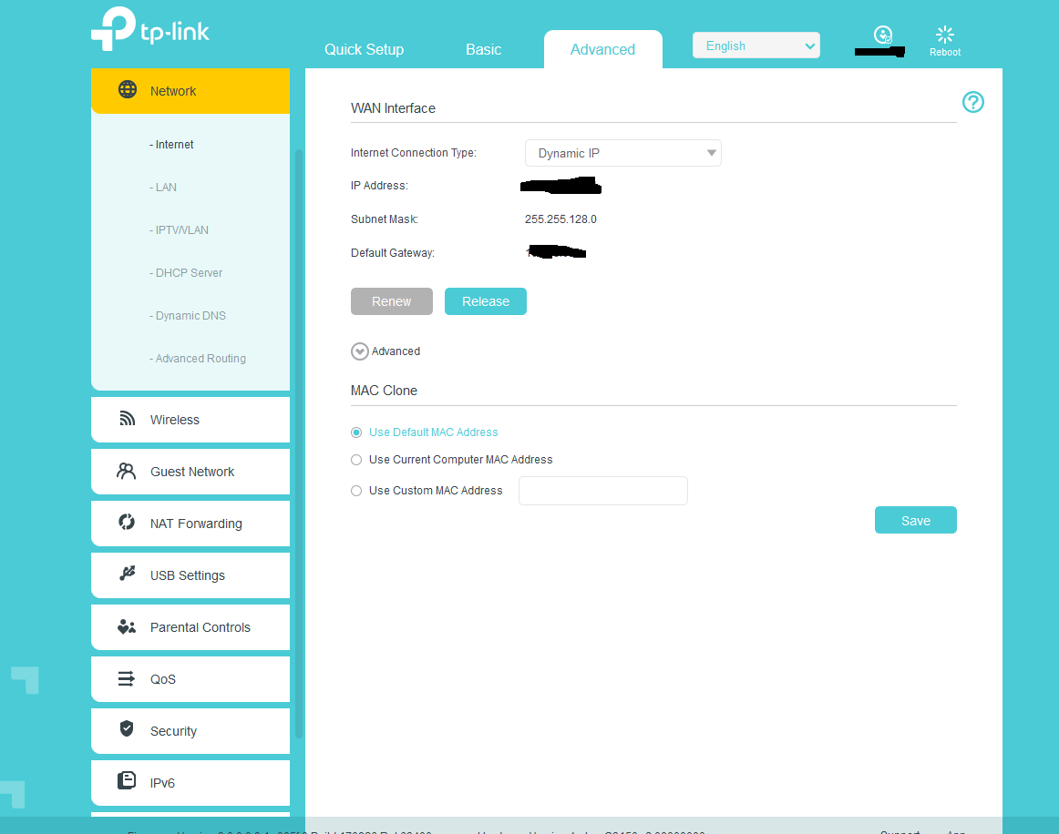

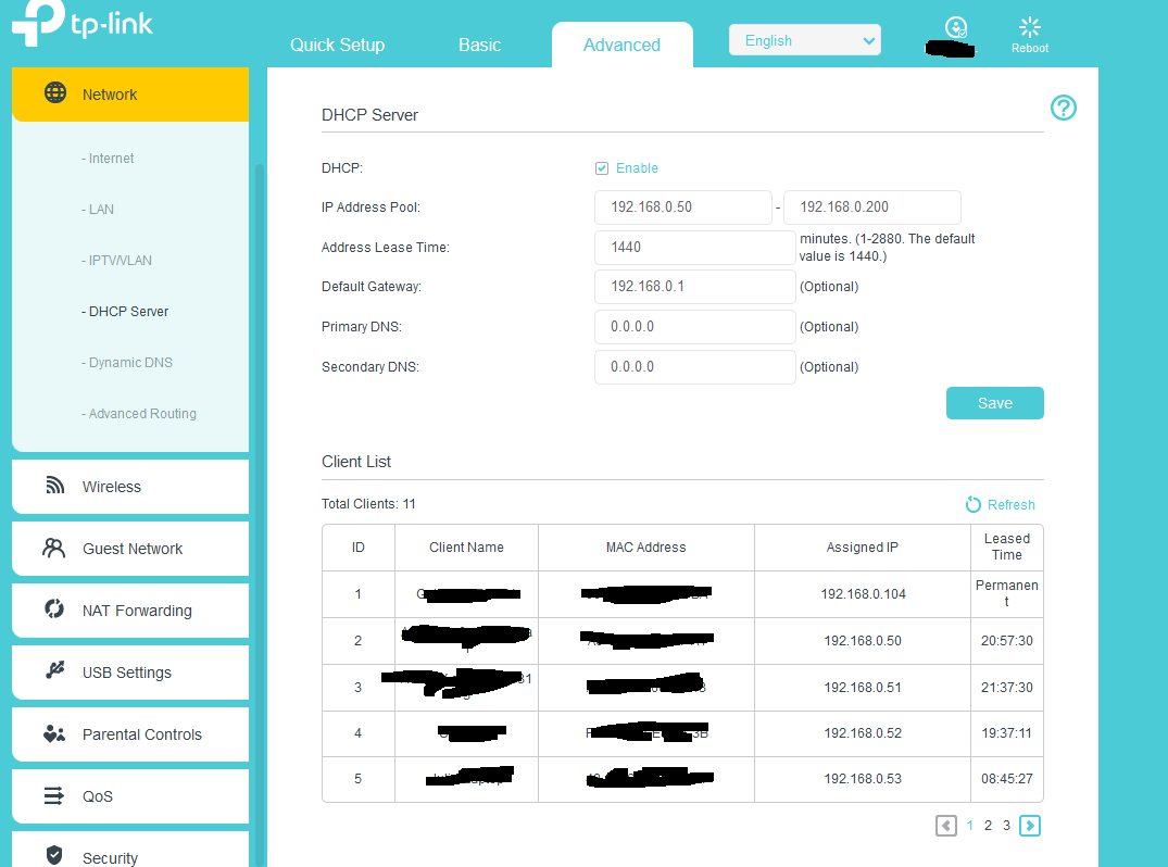

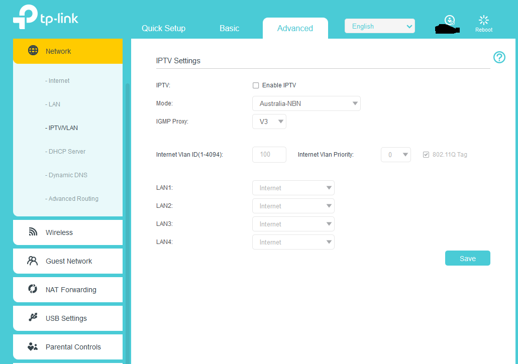

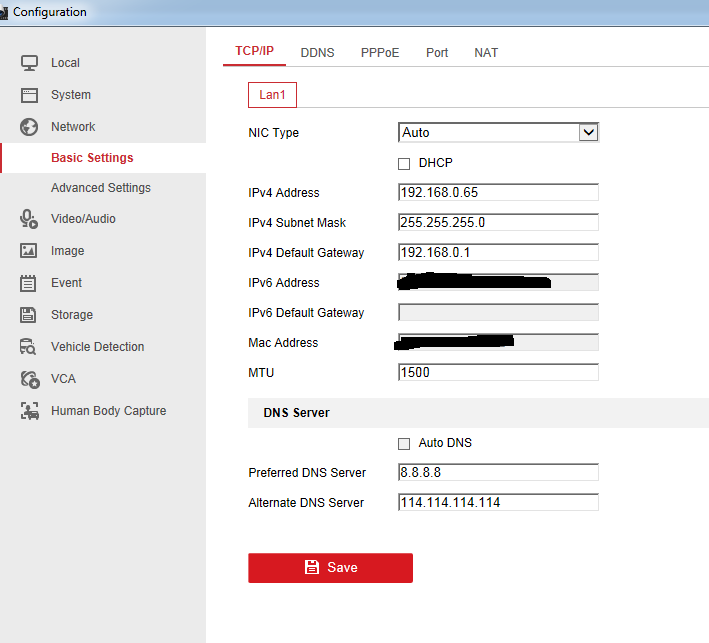

To be honost, i didnt touch any of the settings on the router for the NVR, all i did was give the NVR a reserved ip address....

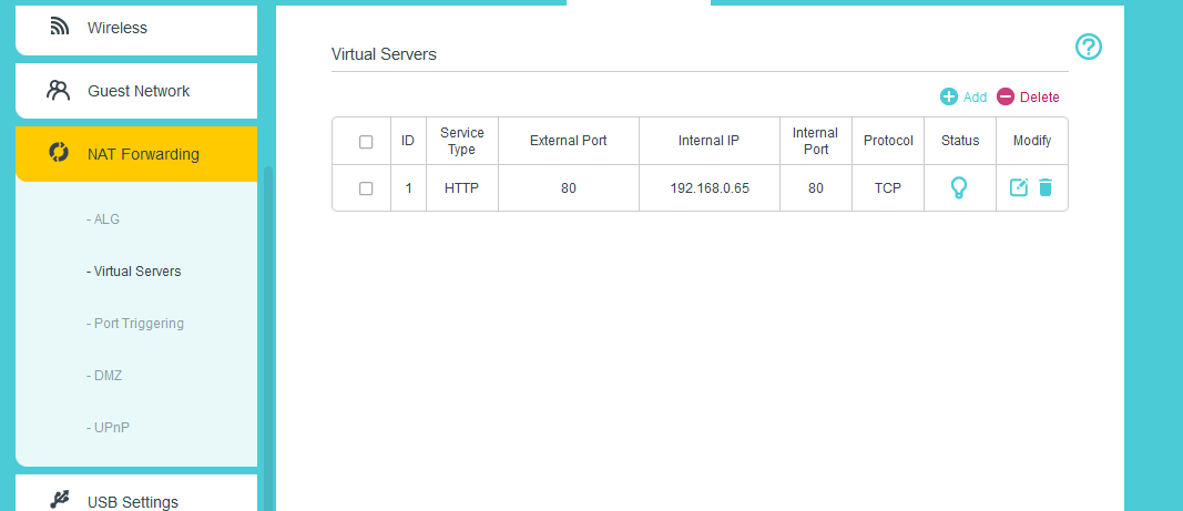

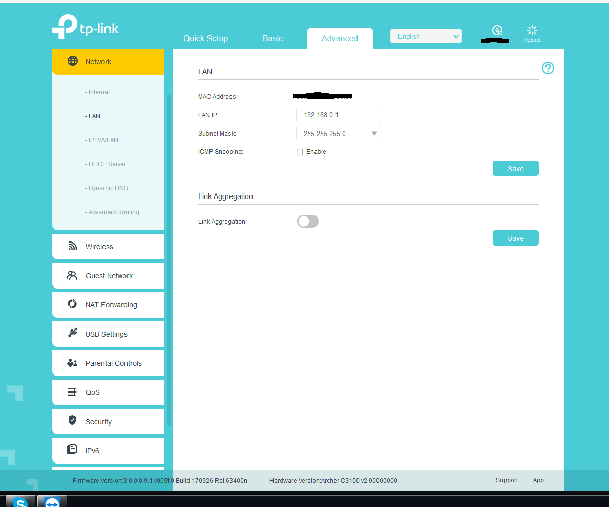

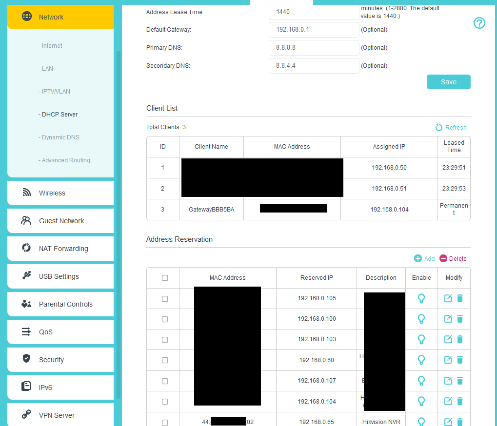

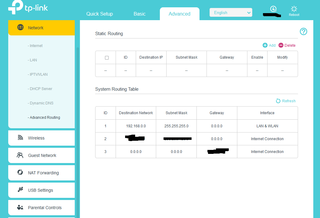

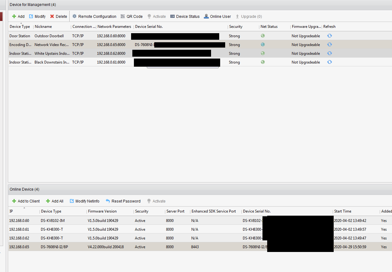

ive got some photos here. I also noticed on the router settings.. none of the dns settings are set, do they need to be set aswell?
Let me know if there is anything else you's need
thankyou

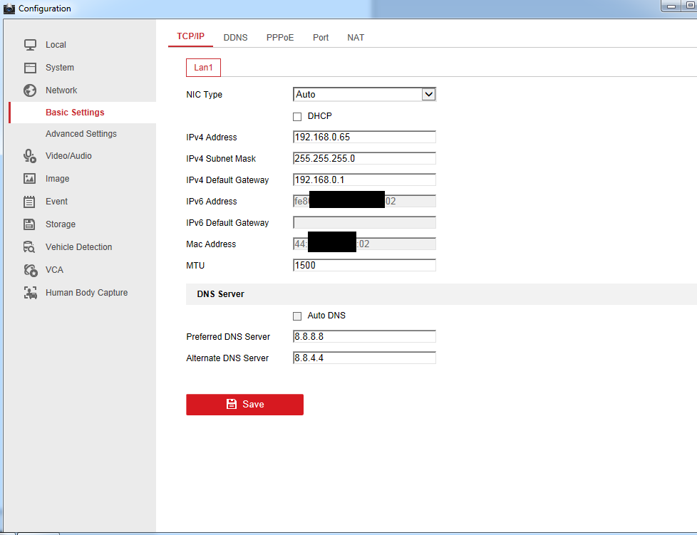

With the dns server settings.. set those settings on the NVR or on the Router settings?

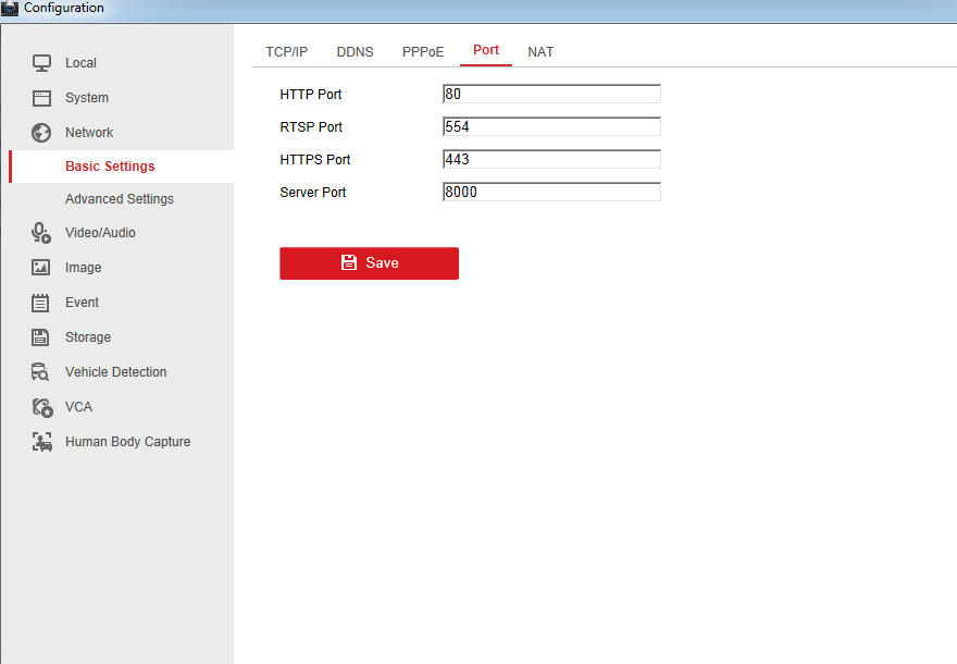

I see it chose port 80 automatically
Does it need the other ports aswell "80, 554, 443, 8000"
Thankyou
No problem at all.
Set them as the same on both, so in the NVRs network settings too. The Mac address you'll need can be seen in your 8th screenshot.
Just 80 on its own should be fine :)

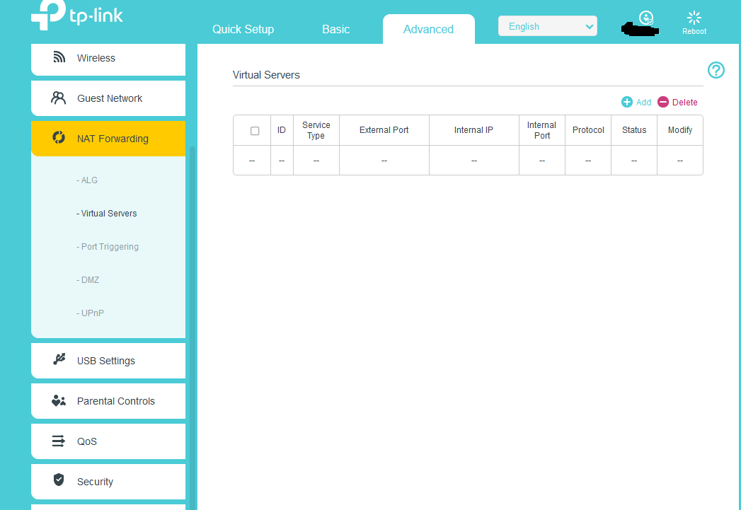

still no luck im afraid.
ive attached updated photos
thanks again
