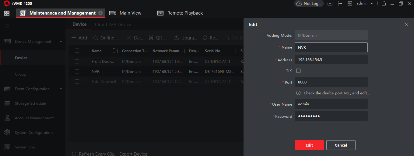

That is odd... if you click on the Edit button for the NVR:
Does everything look correct:
I agree, I don't think your main view or remote playback should work if the NVR shows offline in maintenance and management...

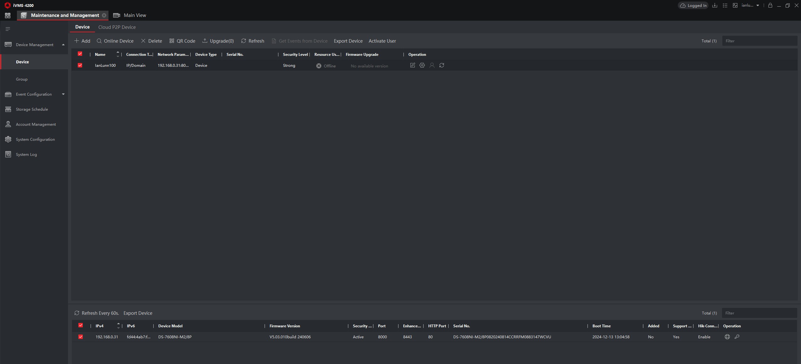

Here is where I am right now..... I have got access to my cameras via IVMS4200 and have logged on/ using my HIK-Connect account details to the GROUP, but cannot access the NVR ( The passwords are the same for both. and IANLUNN100 is my Superuser name... and they ALL share the same passwords (for now)..... I STILL cannot get the NVR to go 'Online@ in the upper area of the programme ( See screenshot )..
Any ideas ?

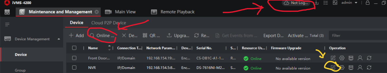

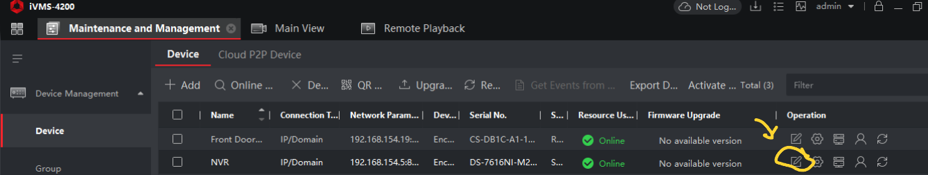

OK, I see a difference... I don't log into Hik-Connect from IVMS-4200 because in my case the computer and the NVR are on the same LAN... I think this is better so there's no extra network traffic back and forth with the Hik-Connect servers...
If the computer you are running IVMS-4200 on and the NVR are on the same LAN, you may want to try setting it up this way... log out of Hik-Connect on IVMS-4200 and then hit the "Online Device" button I have highlighted above... select the NVR from the lower window and hit "Add"... give the NVR a name, enter username and password, and leave "Import to Group" checked...

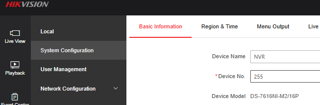

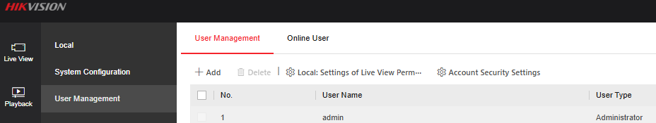

You can confirm these by logging directly into the NVR Web GUI:
