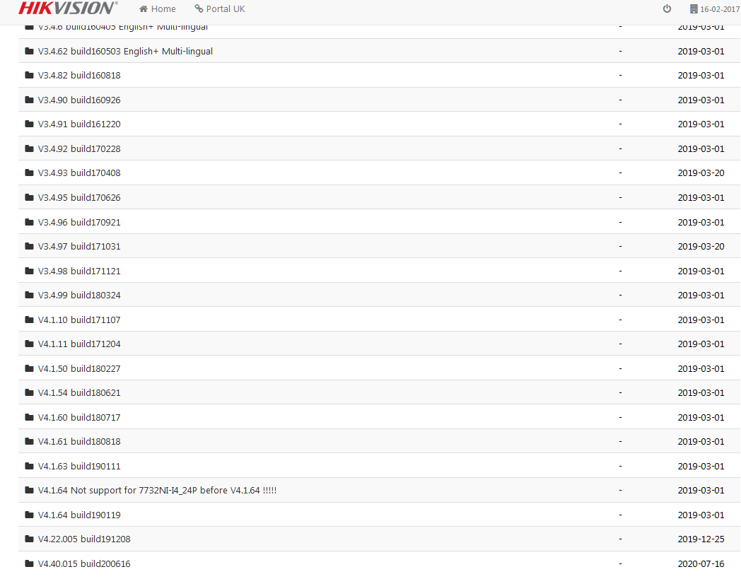

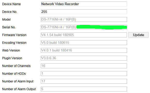

hi just just got a new nvr from the 7604in k1 to a 7716 in i4 (b) with dual hdmi out puts ive tried updating the firmware from the nvr menus and its saying its the latest version so ive looked on the hik vision web site and cannot find the actual firmware thats on the nvr from the hik vision list and there seems to be newer versions of firmware so im a bit puzzled as to what to update to ive attached images of the system details and the hik vision site

Your current firmware is seventh up from the bottom of the list in your second screenshot.
All versions below that are newer.
