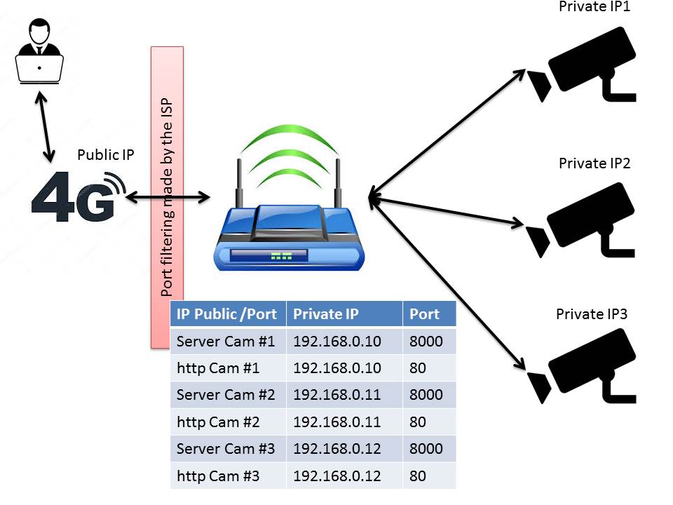

Hi Phil,
not sure to understand.
Let me sum up my situation. All my cameras are connected to a router (D link DWR 953). The router used a 4G connection provided by an ISP who makes port filtering (XL axiata).
My router, based on the emacs of each cameras, gives an private IP to each cams. I also add rules for a virtual server (NAT) which gives for a couple (Public IP: Port) the internal point to access (Private IP: Port).
For instance, the rules are for the cam #1:
For the server port of the cam ==> Public IP:9090 to Internal IP:8000
For the http server port of the cam ==> Public IP:9091 to internal IP:80
So, on my internal network (under the router 192.168.x.x) you can access to each camera by default port (8000, 80, and so...) using the internal IP. The router will make the translation based on Public IP: Port to Private IP: port for external access.
Normally, for instance, I can access to a camera using Public IP:Http port defined for cam #1, the router will translate the request on the public ip adresse to the private ip and port (see attached).
But in my case, the ISP makes port filtering. So I can't use this method.
So I think making my own VPN will not solve my problem (if I understand).
But, maybe, connecting my router to a external VPN access point (which should let me access to some open ports) should resolve my problem no ?
