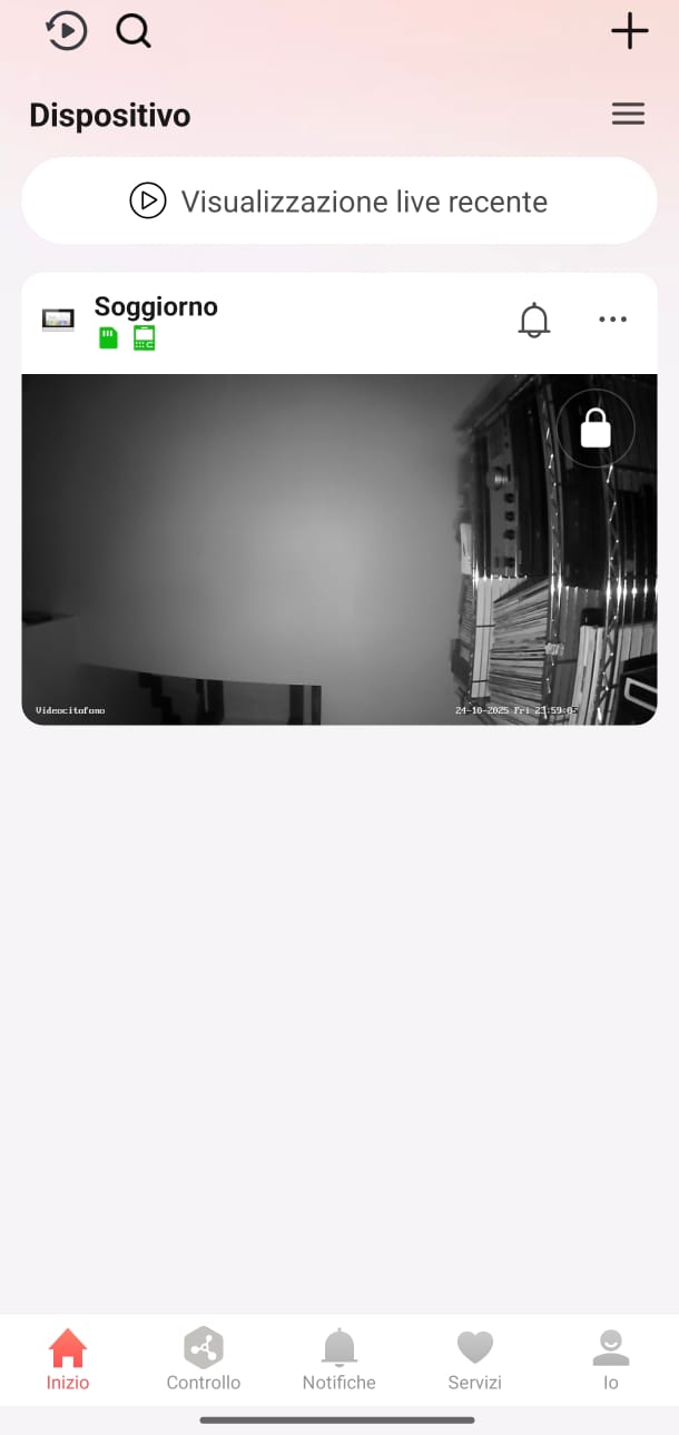

The problem is with the live stream on Hik-Connect without a call. It works perfectly on the indoor units, but it no longer works on Hik-Connect.
I'm sure it worked perfectly before. I updated the indoor units and the outdoor unit to the latest firmware, and I've had this problem ever since.
If I try to remove the DS-KH6320-WTE1 from Hik-connect and plug it back in, it works for a while, but then it stops and tells me that the external unit is offline and can't read the video stream. However, if I go to settings/cameras, it tells me it's online instead.

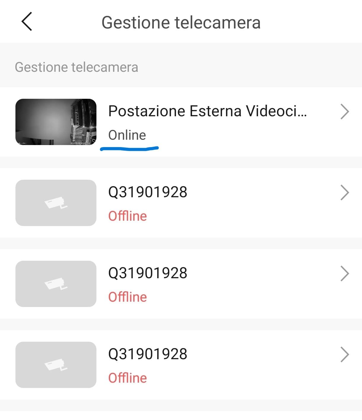

Hik-Connect has connected the main indoor unit, which in turn "sees" the outdoor unit.
If I go to the Hik-Connect main page, like the previous screenshot, it says offline, but if I go to the indoor unit settings (still on Hik-Connect) and then to cameras, it tells me the outdoor unit is online.
And indeed, if someone presses the intercom button, I immediately receive a call and see the live view.

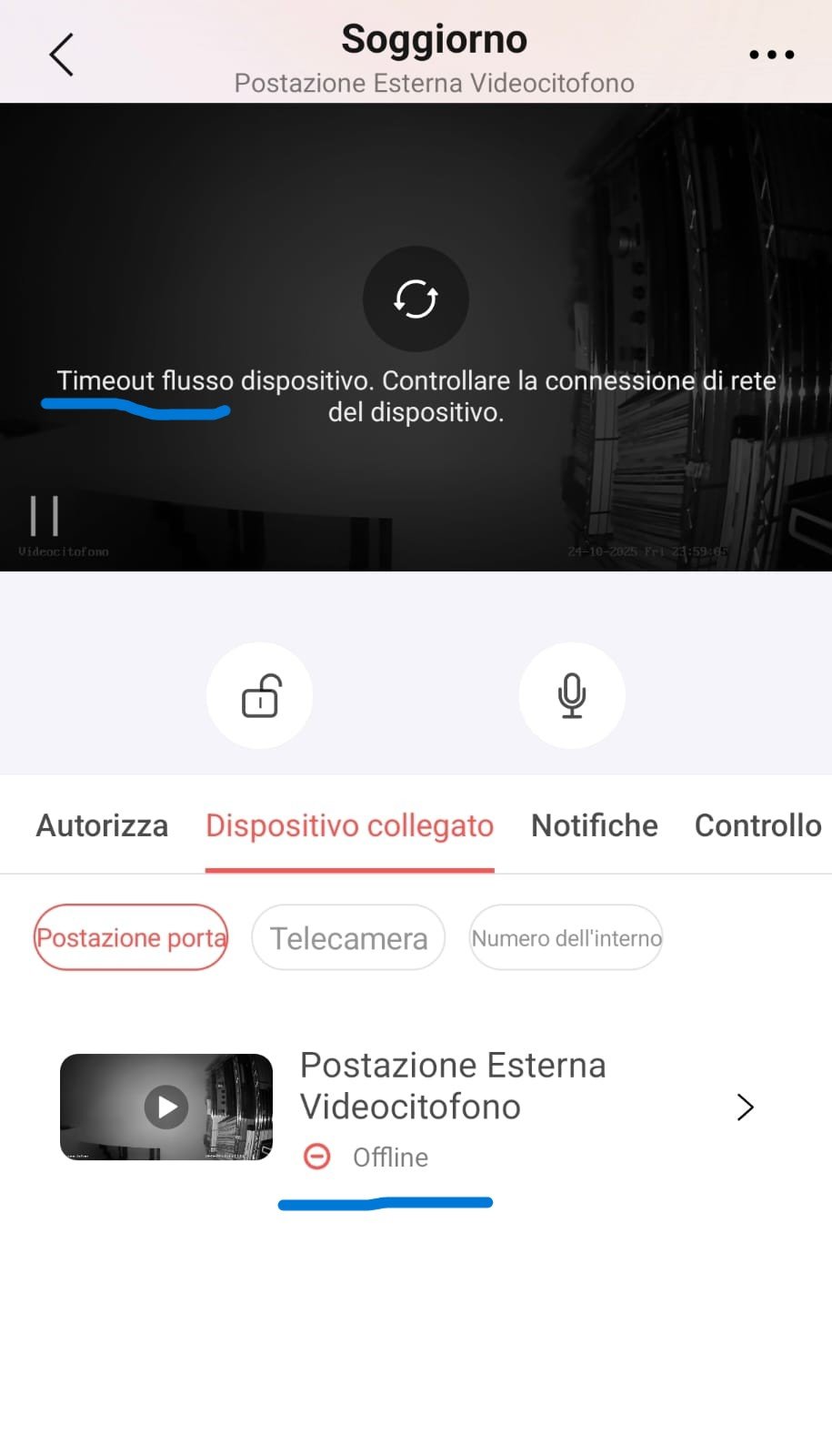

When I want to watch the streaming from Hik-Connect, it thinks for a moment and then tells me it can't get the video stream, that there are network problems, but in reality there are no problems.

It seems the problem is that when I query the DS-KH6320-WTE1 device via hik-connect, it should show live streaming, but instead it times out!!!
