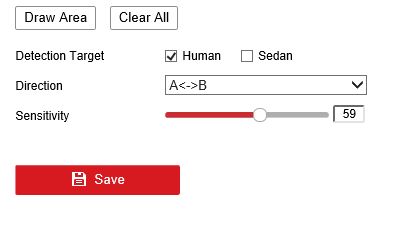

I also have an acusense camera with K series NVR.

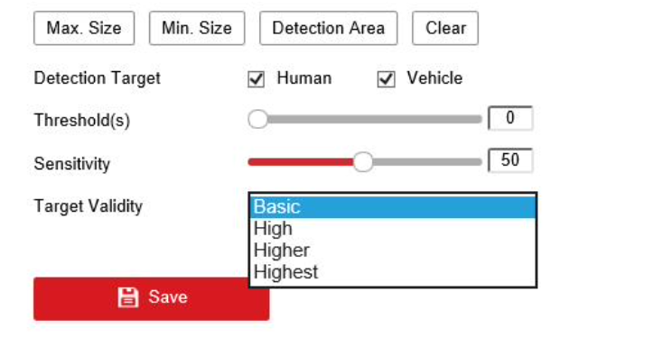

To reduce false alarms by animals, will it work if I enhance the event settings in my camera by introducing min size, and setting the target validity to highest . Will it help or as long as the NVR is K series, I will be getting these false alarm and I upgrade to I series??
Also, how much of false alarm reduction will be done by the I series? Will the animal trigger go away 100% ??
Yes you can enter the additional settings that aren’t available in the NVR menu directly in the camera. Min/max size, target validity etc are not available for motion detection, only line crossing, intrusion and other smart events. I would imagine most false alerts from animal triggers etc are caused by reliance on motion detection rather than line crossing, intrusion.
The AcuSense false alarm filtering is carried out by the camera. Changing a K series to an I series will therefore make no difference whatsoever as the camera does the processing. There are specific models of AcuSense NVR available, however these are for use with non AcuSense cameras and are restrictive regarding the number and resolution of cameras connected.

I tried introducing min size and target validity in the cameras, but still I am getting the false alarms.
The thing with min size is that depending on where the animal is in the camera frame, it might be bigger than the min size.
I can’t make the min size too big, as then the humans at the farthest point becomes smaller than the min size and bypass the alarm.
