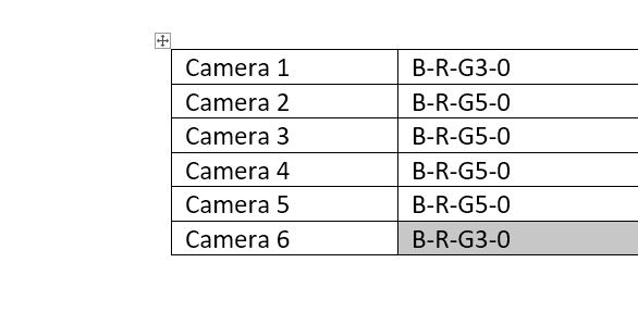

I agree - a G2 model camera that doesn't use G2 firmware (doesn't exist) but instead uses G3 firmware, unless you've got the newer one, that had a tiny C marked on the box label, in which case it uses G5 firmware. How could anyone possibly get it wrong lol.
The best way is always to check in the camera menu > System Settings > Basic Information, where you can see the current version, if you look down to the bottom there's an entry that confirms which firmware platform you need:

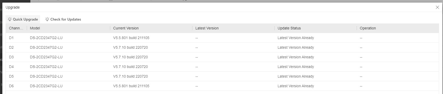

Hey guys,
New here and wondering if you can help as I'm having similar trouble upgrading the firmware for my six "DS-2CD2347G2-LU" s' to the latest version 5.7.10:220720
I downloaded the latest firmware from the Hikvision EU website and successfully applied it to 4 of my 6 cameras, but 2 just won't upgrade give me the same "Upgrading failed" error above.
Could this be because two of the cameras are earlier models? It feels like I've got two different firmware streams to worry about for the same model camera?
Gotta admit, I find this really confusing. Thanks in advance for your kind support.
Hey guys,
@JB1970 cracked it with his tip above; they are different Firmware versions, jeez!
