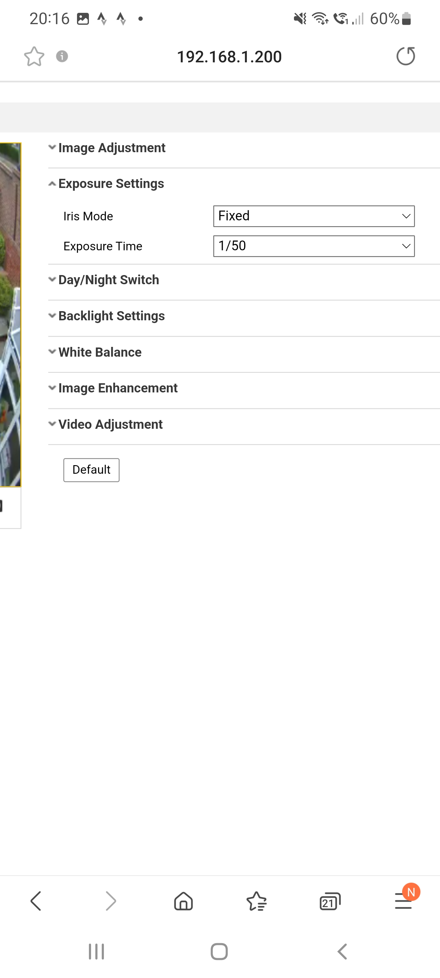

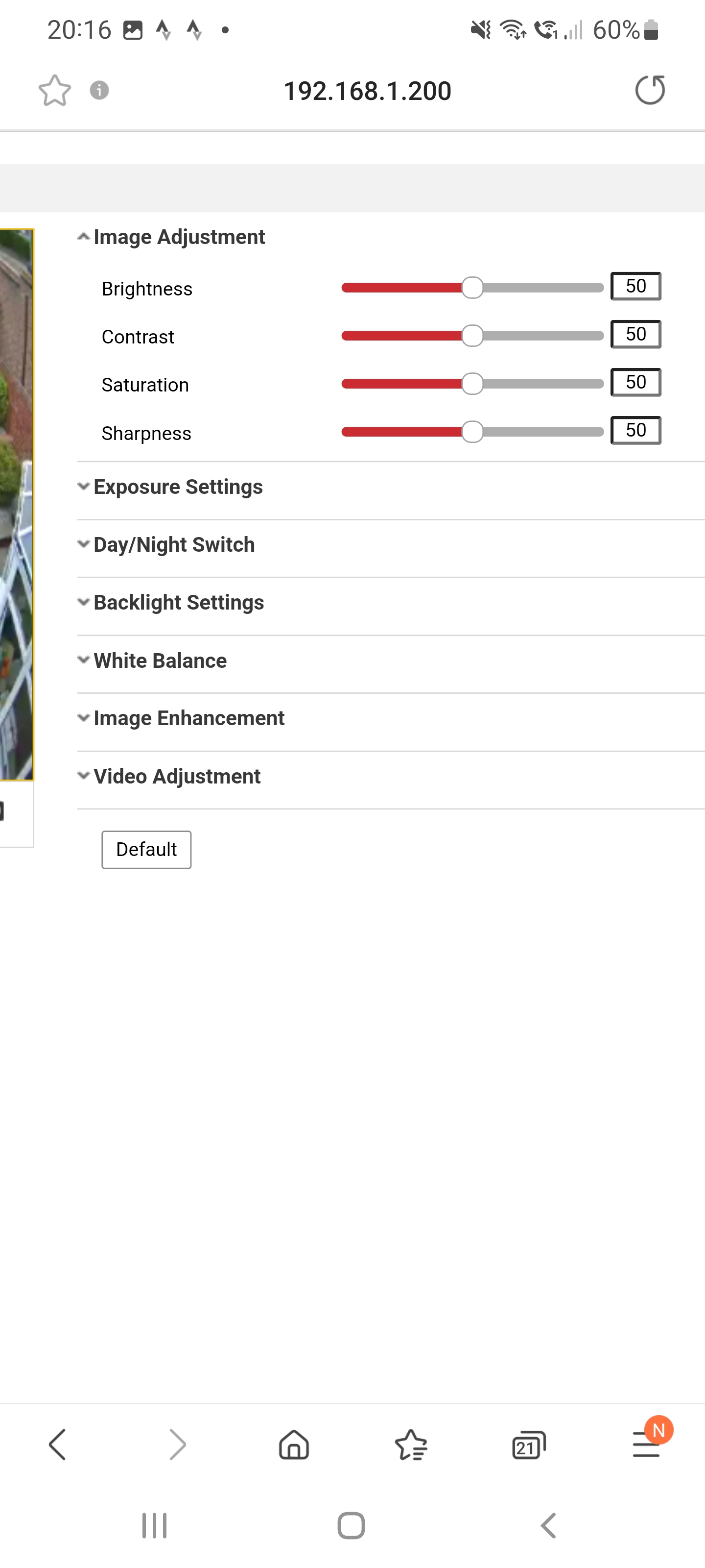

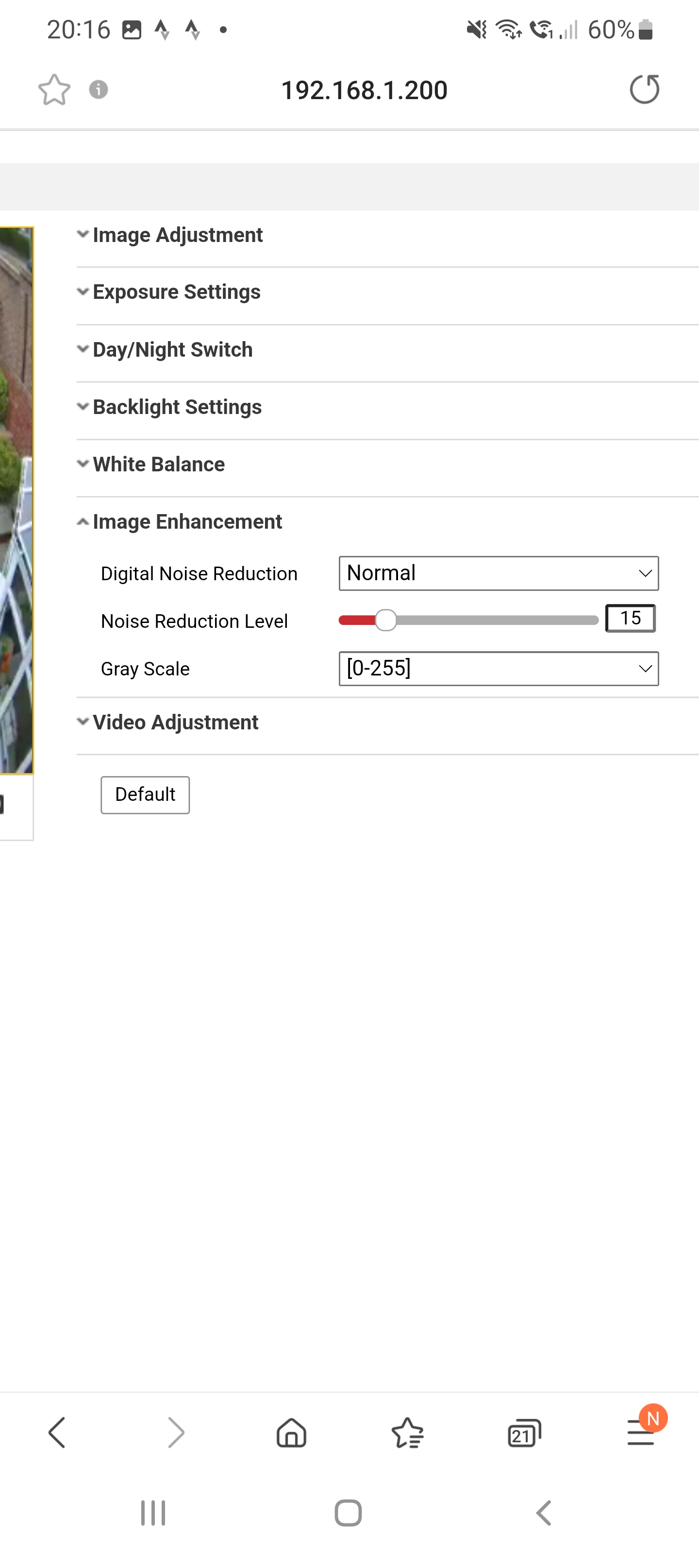

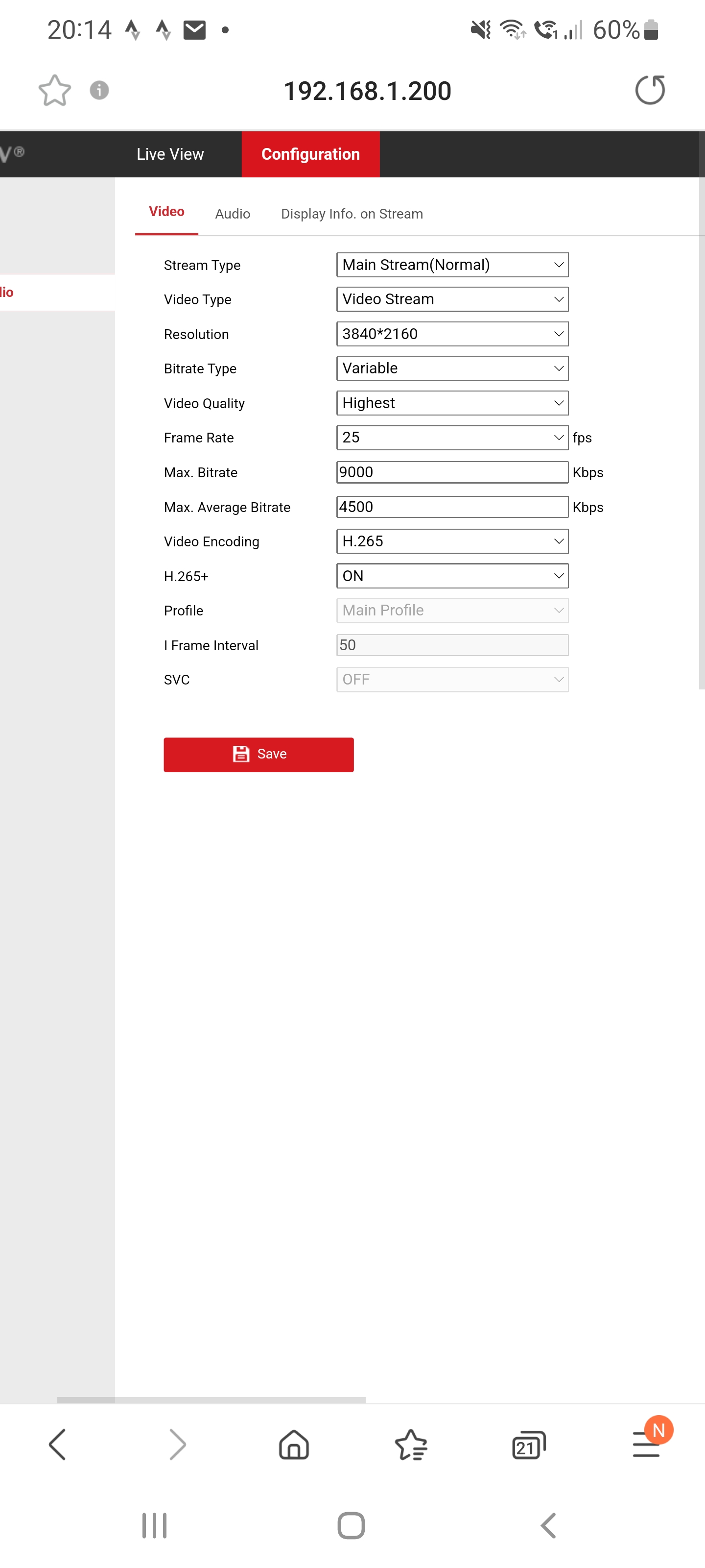

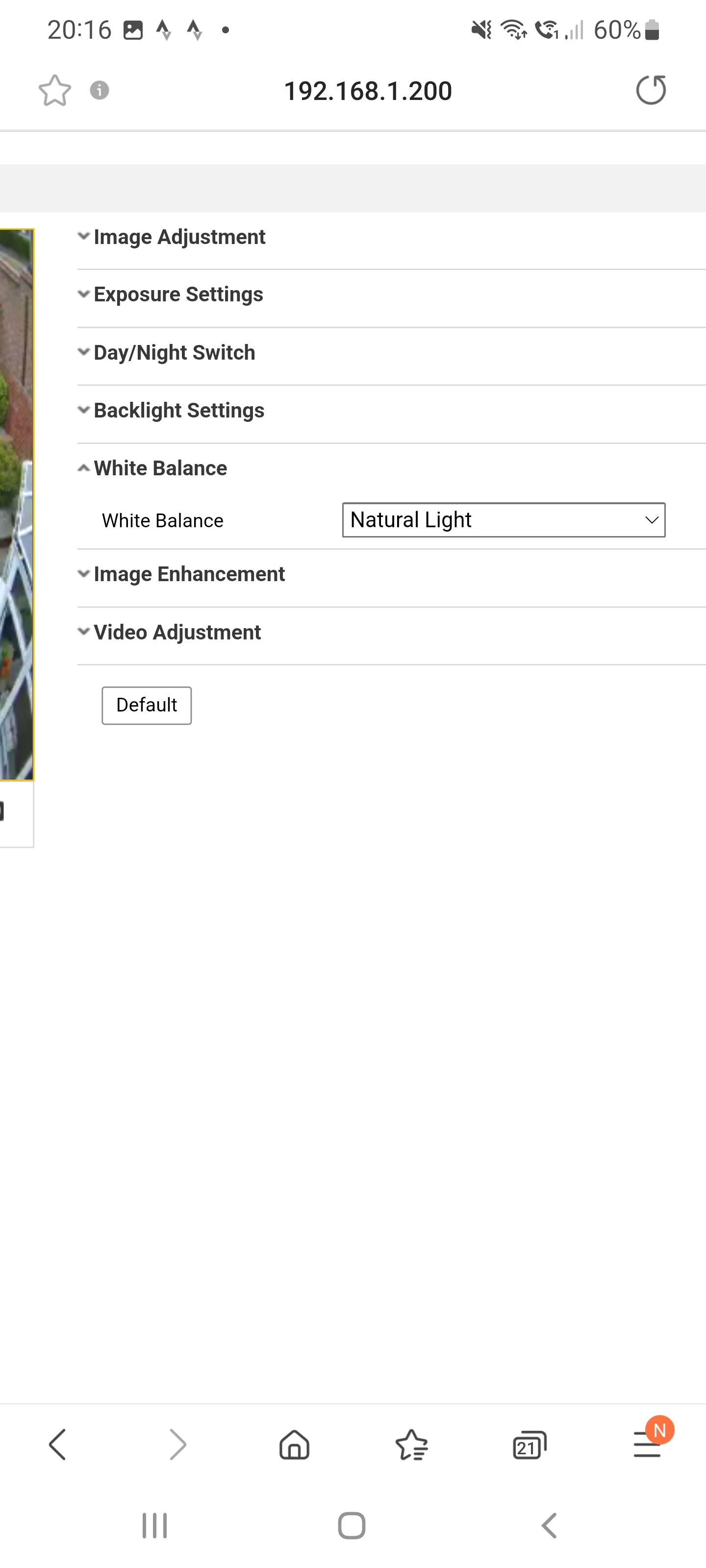

Settings I'm using now

OK so as I said either turn off WDR or set it to manual and 5. Drop the contrast to 45 - that will lighten the image a bit in a pseudo WDR fashion, evening out the exposure a bit. That will sort the washed out daytime picture. White balance can normally be left on AWB. It's fine to use other settings for that but depending on the time of day and weather the light may not always be 'natural' so you may get some strange colour rendition at times as the light changes. AWB is more predictable.

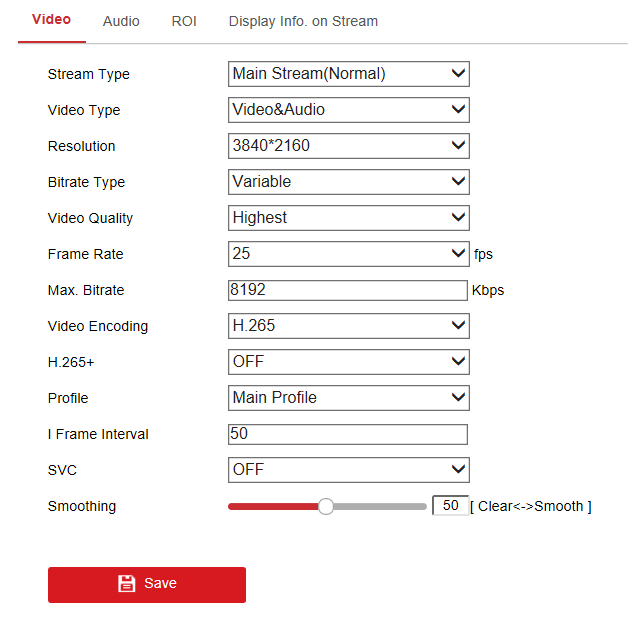

Night time blockiness. You've reduced the the noise reduction from its default of 50 to 15. That's a problem because the noise is increased in low light and the camera is encoding that noise pushing up the required bit rate. At some point the camera is going to struggle to encode 25FPS of video within the bit rate limits set, so will increase compression/drop the quality rather than drop frames. Pop it back to 50.
Turn off H265+ - it can give a poor image and may be contributing to the blockiness. For reference my 4K cameras are set to H265, Highest quality, 25FPS and 12,288 bit rate.

Just changed all setting night very blocky dropped video resolution to 1280*720 so much better

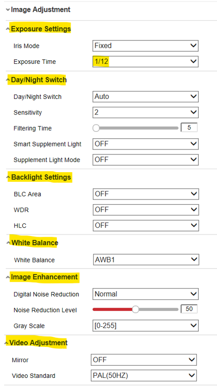

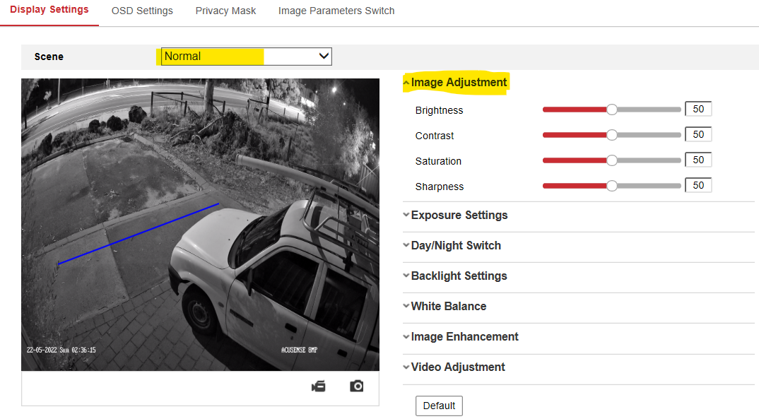

Rarely have i needed to make dramatic adjustments from default settings. if you can default the Video Parameters & Display Settings & try the settings in pics ................... Exposure is the only setting from Default changed
<<EDIT: Set Exposure Time to 1/25>>
