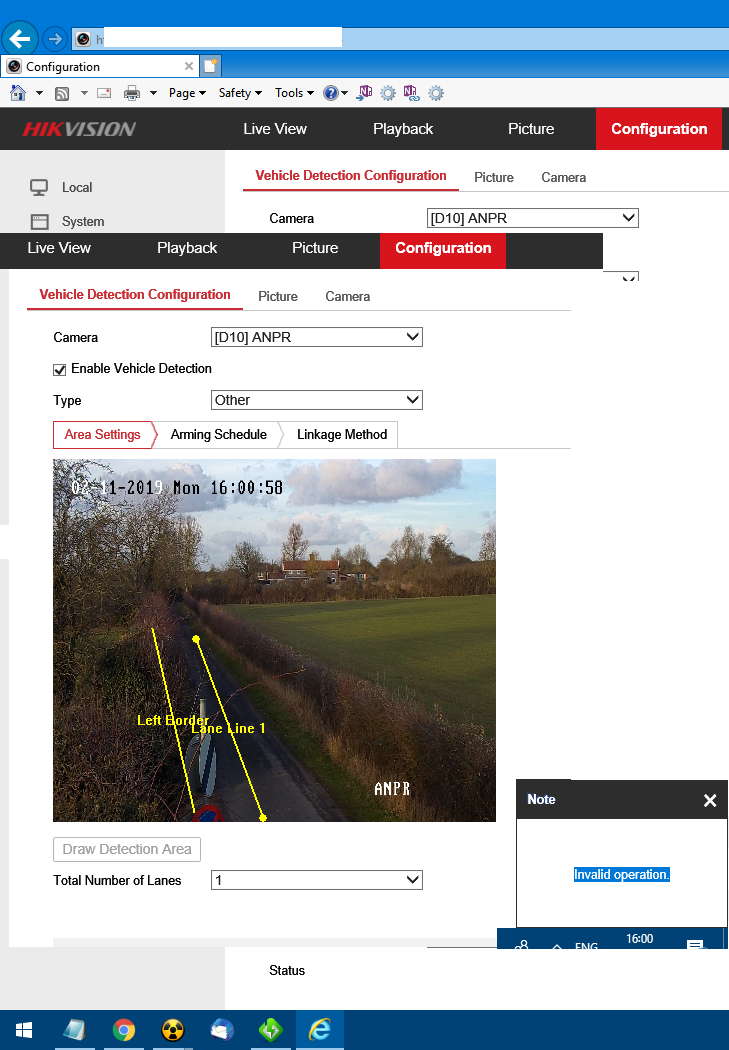

Just updated the firmware on the NVR to 4.1.64.
Using Internet Explorer Please see screen shots.
One is directly connected to the camera and the other is through the NVR

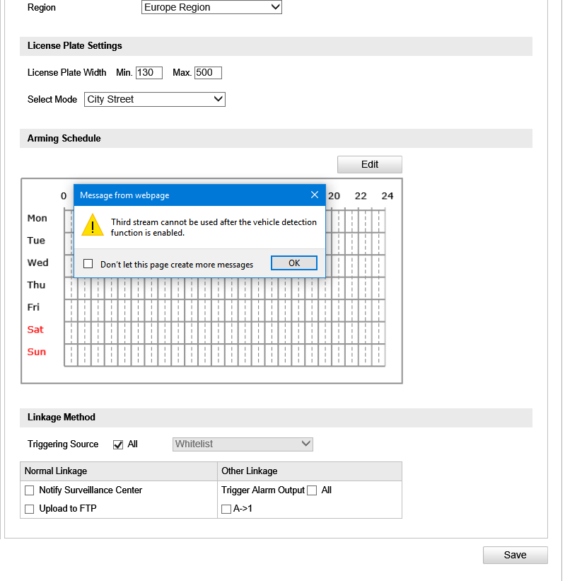

I do notice it says something about Third Stream but i can't find out how to turn that off.
I'm sorry, I'm running out of day now.
A quick look at your scene, and you are not going to get on very well capturing number plates within that scene.
You need to adjust the camera to fill the screen with more of the oncoming vehicles.
Probably angle down and zoom-in:
It's just telling you that if you configure and use its ANPR capability, then you cannot also use a third video stream.
It's just notifying you.
