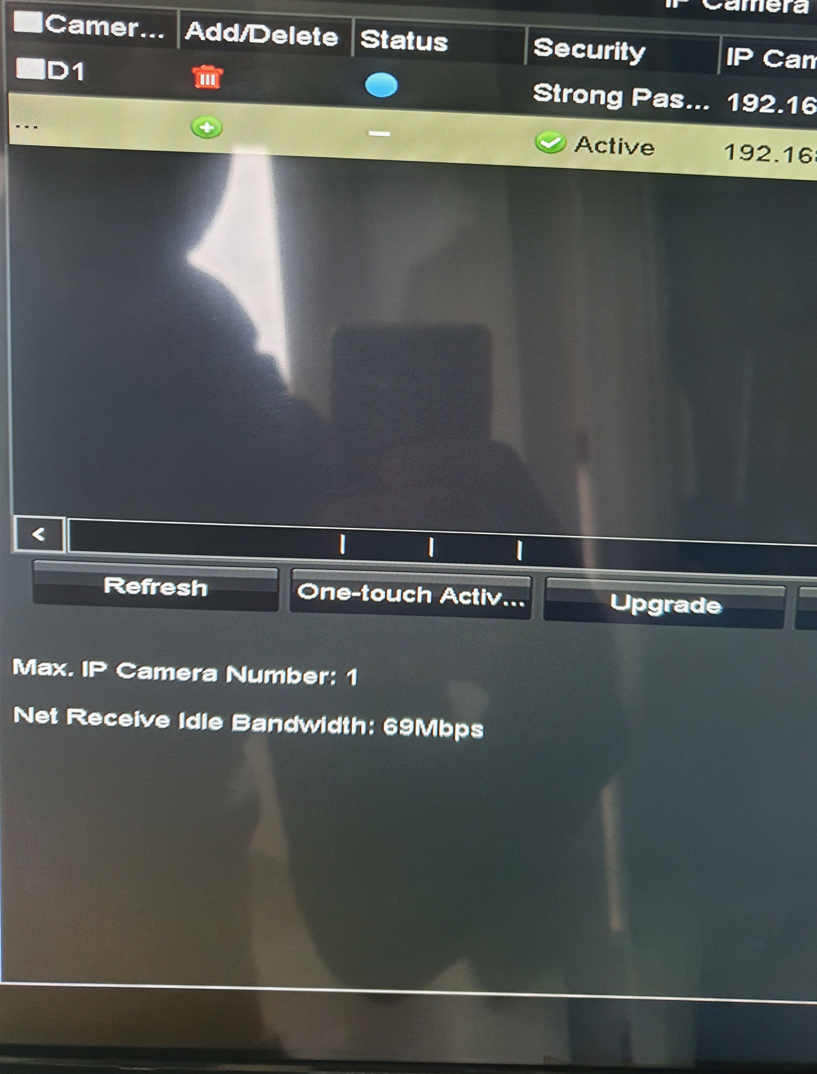

I recently added 1 IP camera using a POE switch to my 4 Channel DVR DS-7204HQHI-F/N setup. Today I have been trying to add more 1 additional IP camera using the POE switch to the current set up but the configuration menu won't allow me to add anymore IP cameras. According to the Hikvision website I'm able to have up to 5 Network cameras. So I can't see where the problem lies!
Any help appreciated.

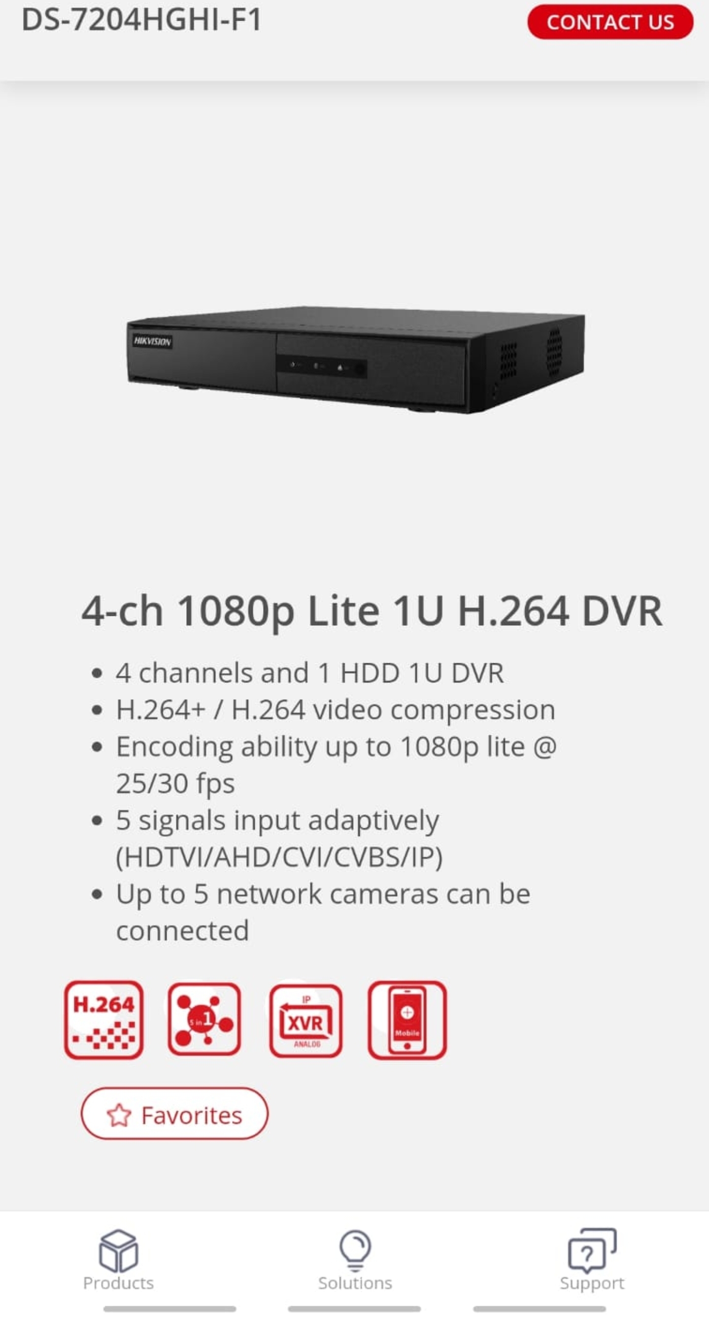

Looking at the Hikvision website screenshot you have shared that is actually a different model. (that is an HGH model and you have HQH)
Searching for your model number on Google I found this datasheet which says it only supports 1 x IP channel up to 1080p (2MP)
So it looks like your DVR model will only support one IP camera.
