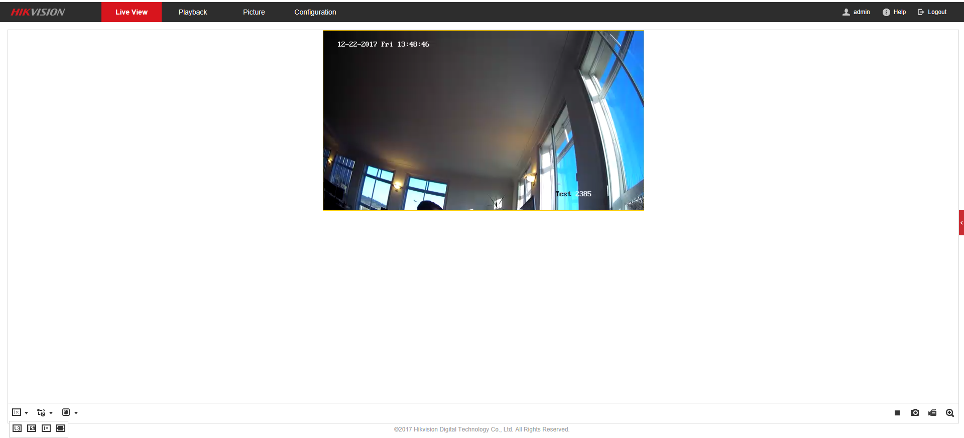

Hi, I'm not seeing this.
You might just be seeing the OSD scaled-up?
Your sub-stream image is probably pretty small by default - select the '1X' full-size view at the bottom left of your screen.

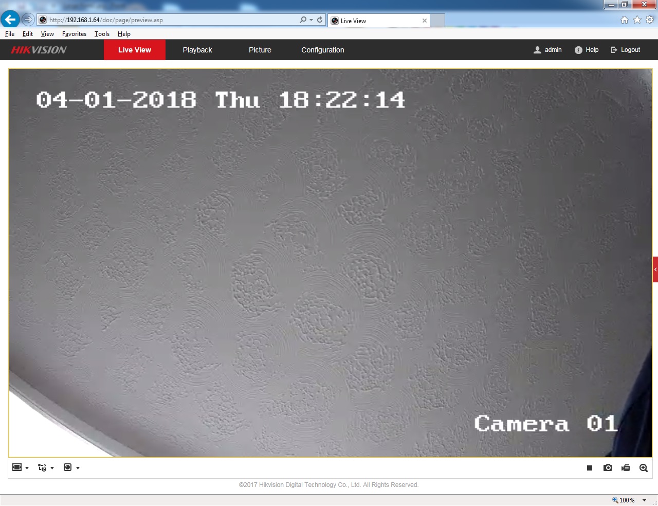

No I don't think this was the cause. The sub stream OSD was massive, the time and date was right across the top of the screen and the name was cut off on the bottom right. I viewed it from the NVR, the iVMS-4500HD android app, Internet Explorer and the iVMS-4200 Client and was the same on all of them. Other cameras on the same NVR using different firmware were unaffected.
Log onto your camera while it is connected to the NVR and change the OSD in the camera menu not from the OSD menu in the NVR and see if it happens for you.

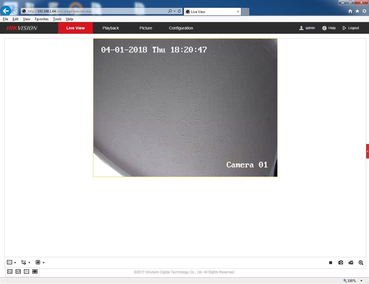

I've tried this on a brand new out of the box camera today. Not connected to an NVR just connecting to the camera directly. As soon as I changed the OSD date format to DD-MM-YY the sub-stream font went big. Even after doing a factory reset (from the menu not the onboard switch) the font remained large. I will have to downgrade to V5.5.0 in order to return the font to original size.

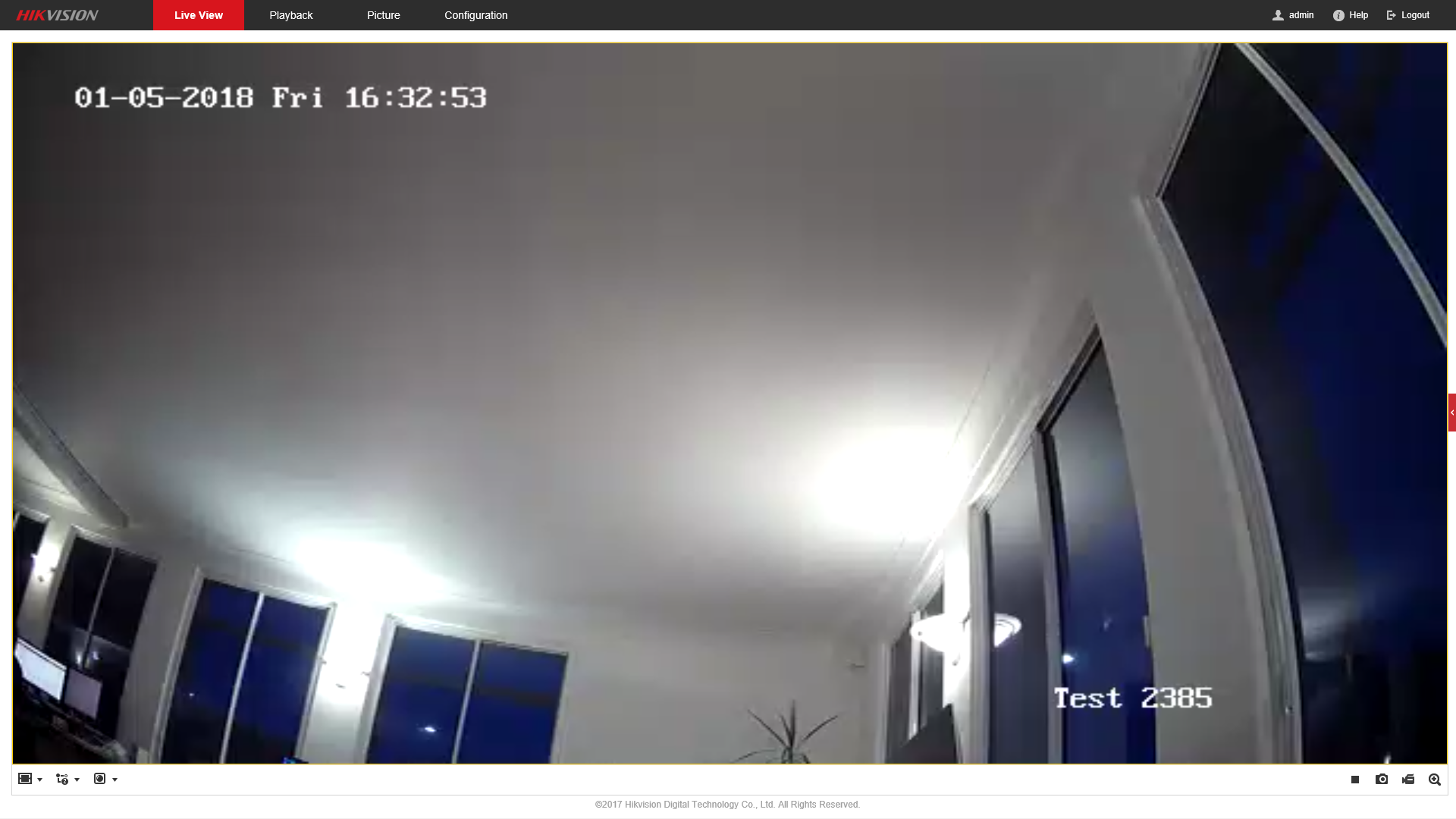

I'm sorry, I can't replicate this.
The below attached is the sub-stream from a 2385 turret running V5.5.3.
