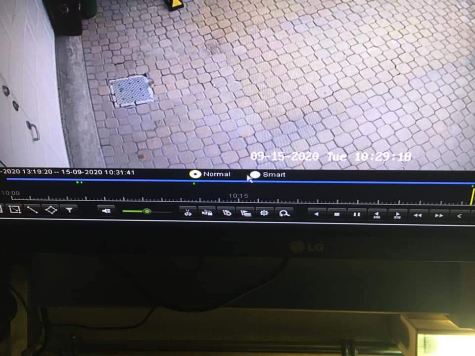

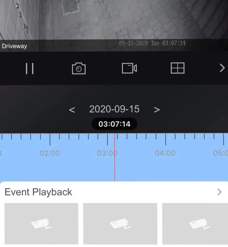

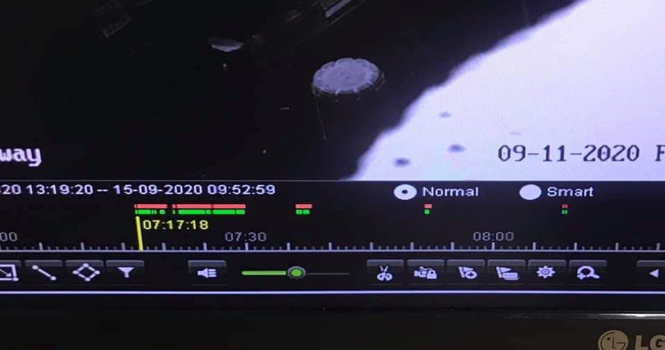

I would like to stop continuous recording and only record motion events (when someone steps on our property) however no matter what I do I can’t get that. First picture shows what I want (orange line). And the second shows what it is at now (blue line).

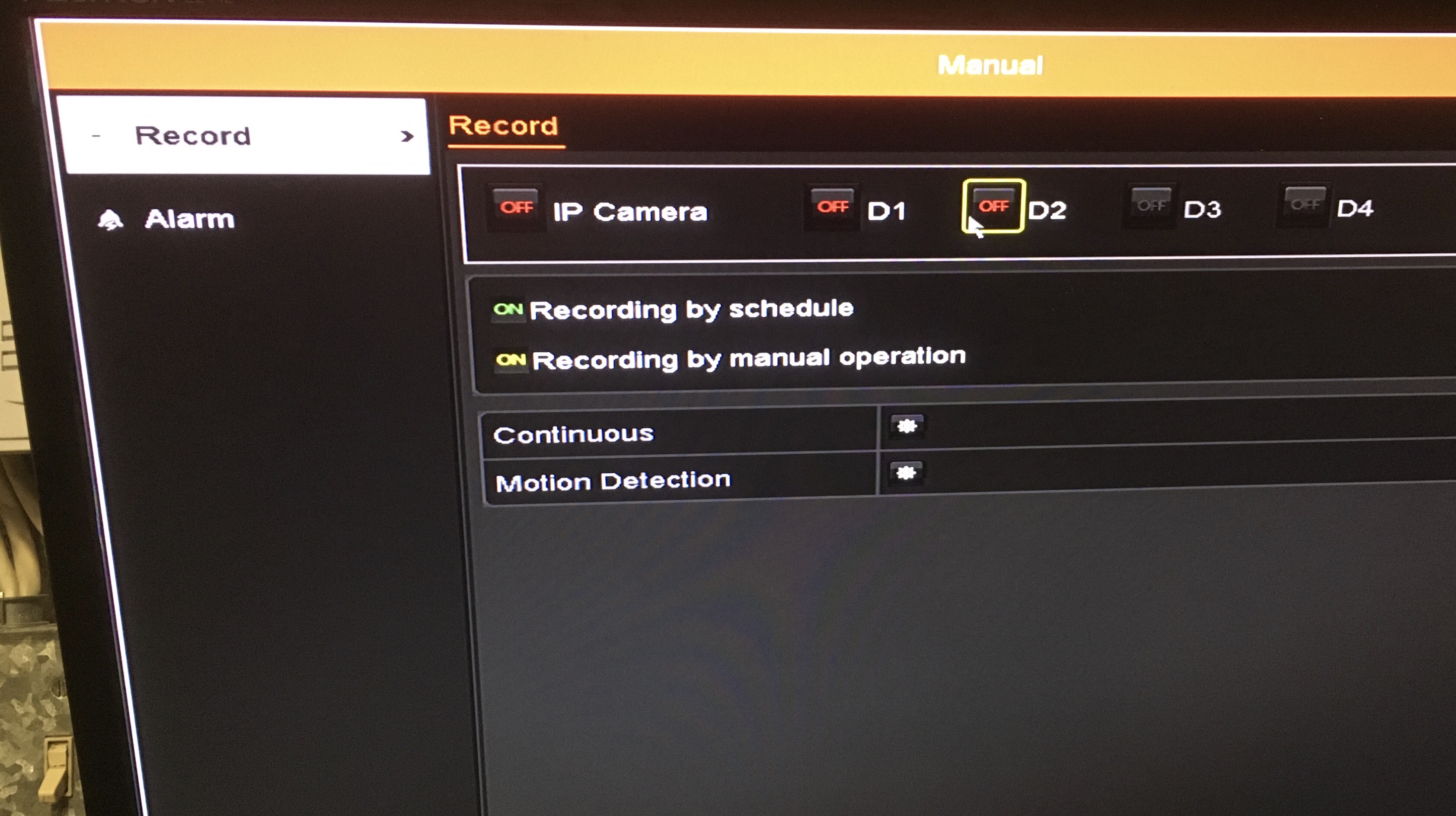

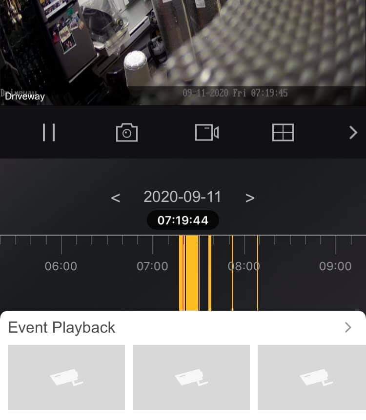

Also in the app, I want to see what is in the third picture and not the fourth.

Thanks for the reply. Late last night we figured out the reason it was not doing motion only. The IP button was on when it should have been off.
