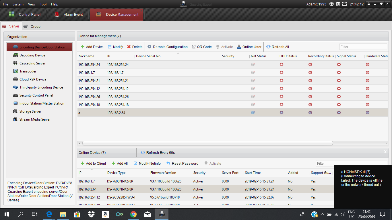

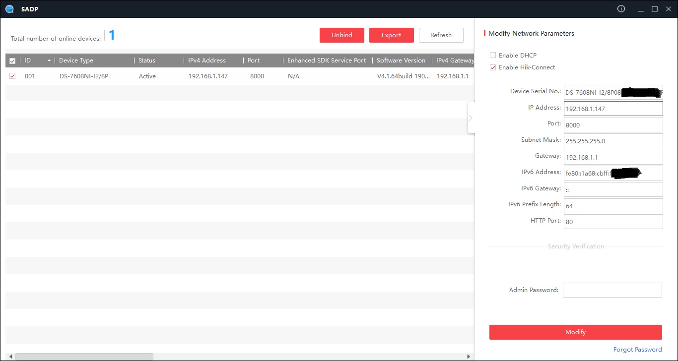

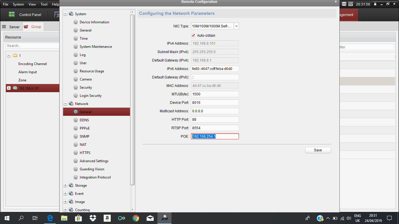

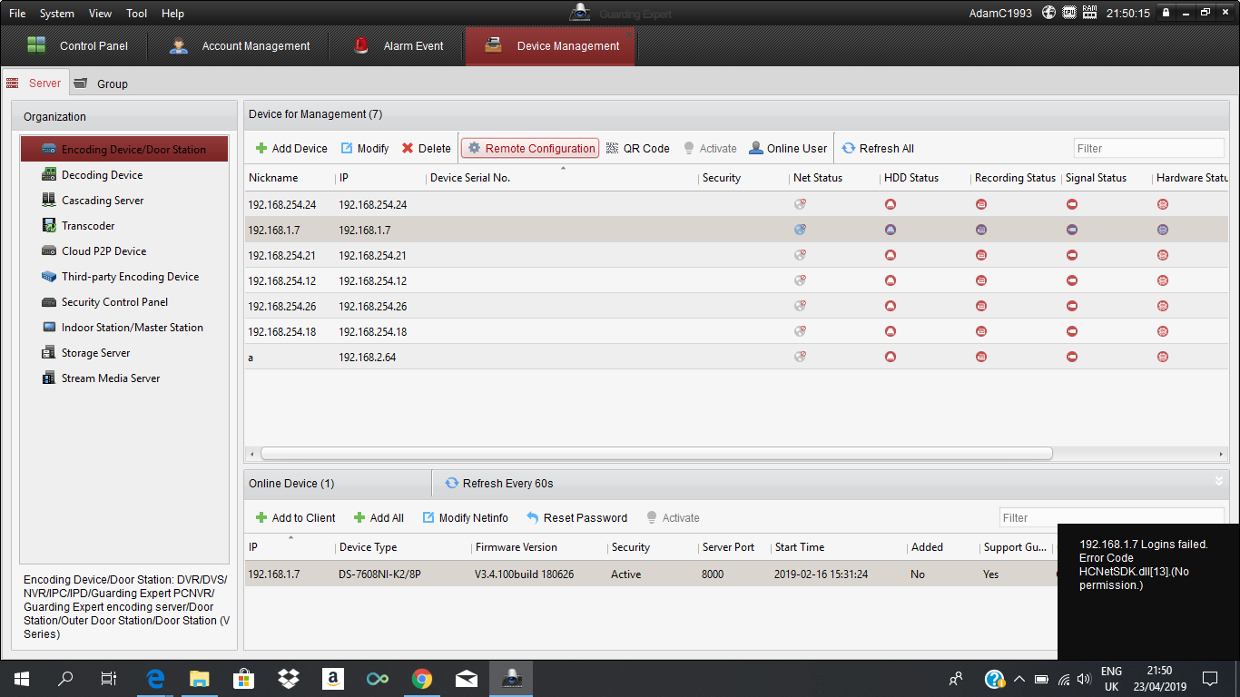

Okay guys I have the 6cameras showing on SADP , also have laptop plug into nvr
When I search any of the ipv4 address into google or IE i get the response from the attach photo below and have tried each camera address.
And when i search hik connect login on google and enter user and password it says "admin login prohibited "
What would you guys suggest here ?

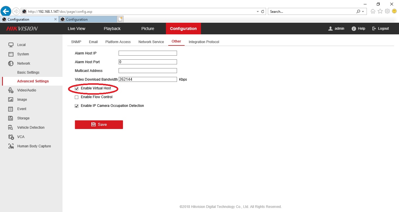

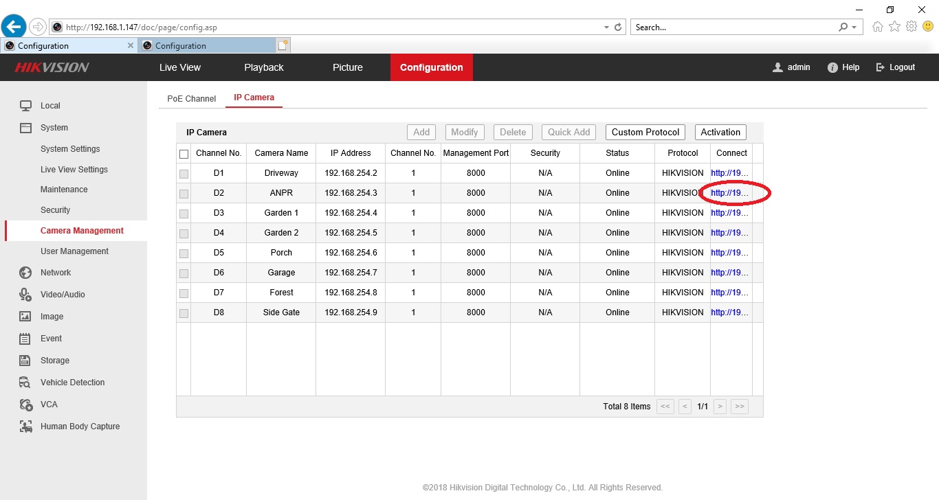

Please connect your laptop to your general LAN - not a camera port on the NVR.
Use the Internet Explorer browser (the icon is a blue e with a gold flash over it), in your screenshot above you have used Microsoft's Edge browser, which will not work.
Using the IE browser login to the Configuration section of your NVR.
Then following this tutorial for enabling Virtual Host:
[Tutorial] Using a Hikvision NVR's "Virtual Host" Feature
Once that is enabled you will see links at the right in the 'Camera Management' section within the NVR's Config area which allow you to open a new browser tab for each camera.
Those tabs are effectively direct to the camera (even though it is plugged into the NVR).
Via the link/tab for your ANPR camera you can access its additional settings.

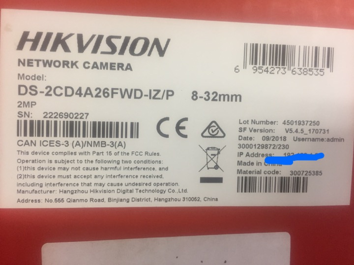

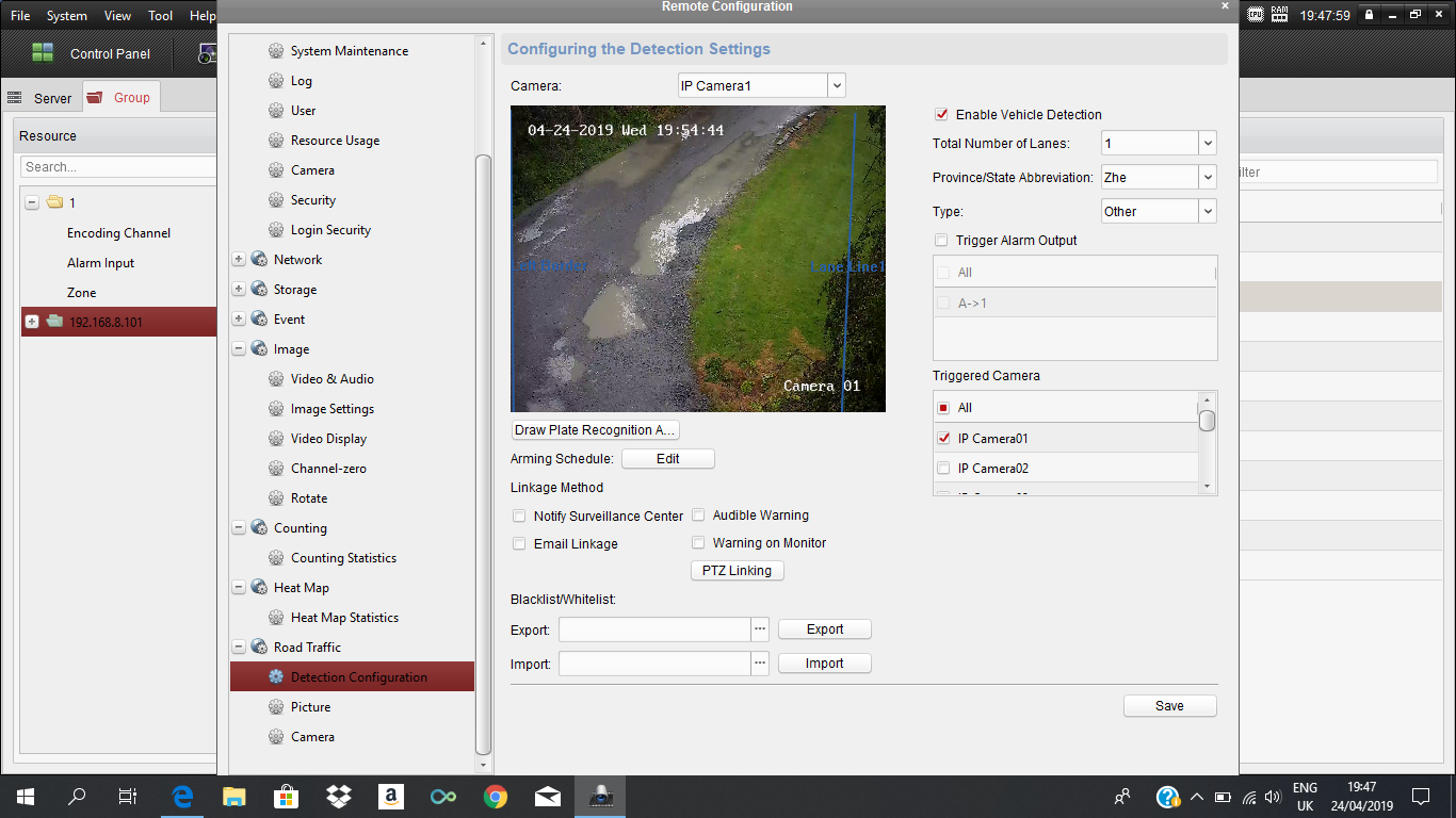

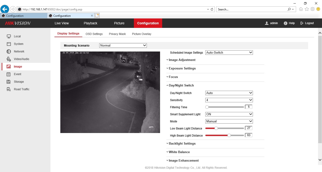

Okay guys I finally managed to login to cameras/nvr via laptop and after selecting anpr camera there does not seem to be the options to configure settings as other members have configured , I am totally lost at this stage ! Attached photos of the configure menu and also photo of the anpr serial number but I have been told I should be able to configure these settings via web

Looking at your screenshots you are not logged in directly to the camera's WebGui, you are in fact logged into the AVR which is why you are not getting the full settings.
To get advanced settings you must log into the Camera's WebGui :(
Take a look at my screenshots and you'll see the difference.

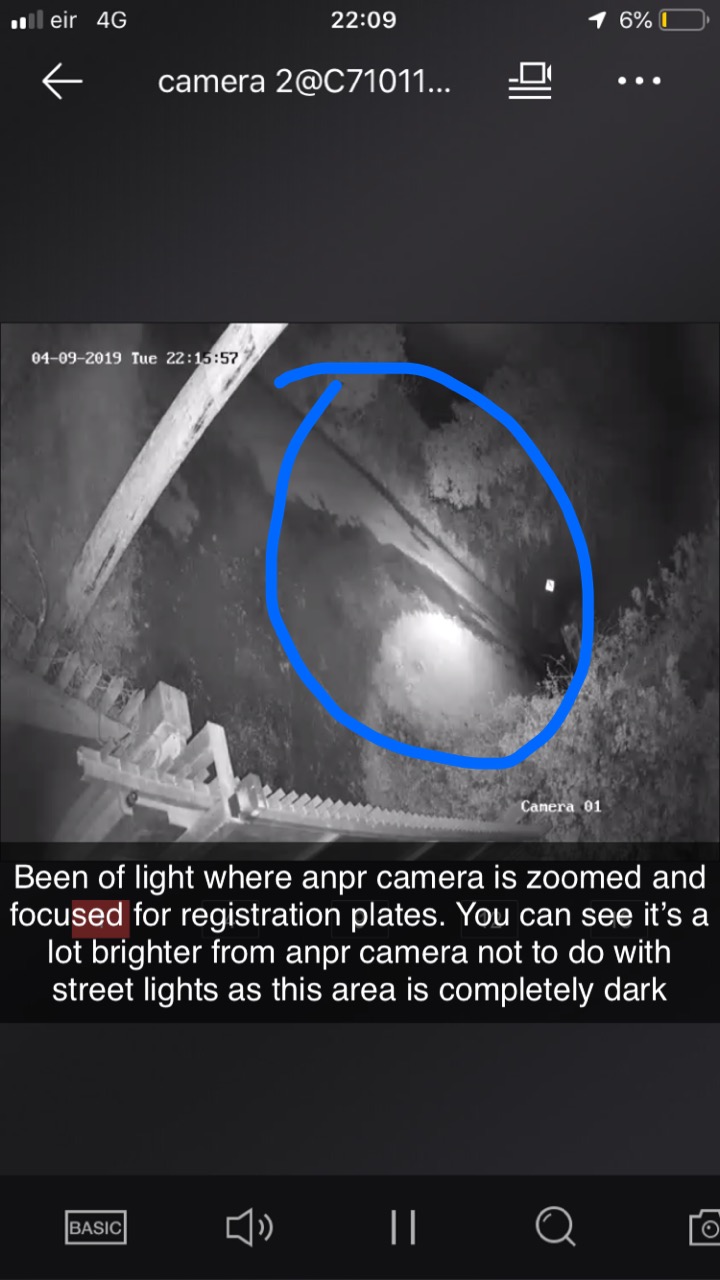

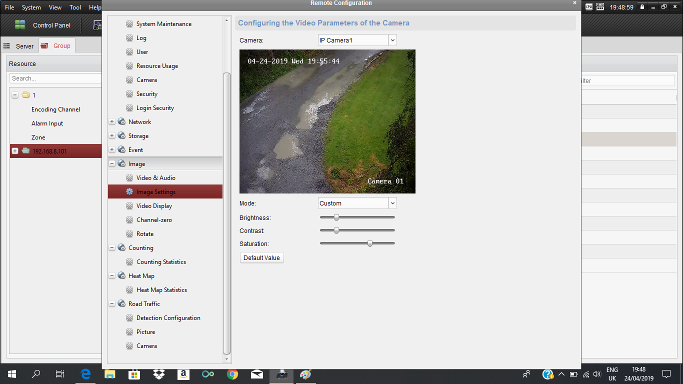

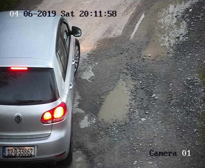

Thanks Malford, i tried your settings but it didn’t work for me at night at all, image was clear but no readings, Maybe because im monitoring a main road with fast moving cars (30-40mph). However i have managed to get the picture quite better by doing some tweaks in the image adjustment based on your settings see picture attached
My current settings are below which reads 99% plates accurately at night.

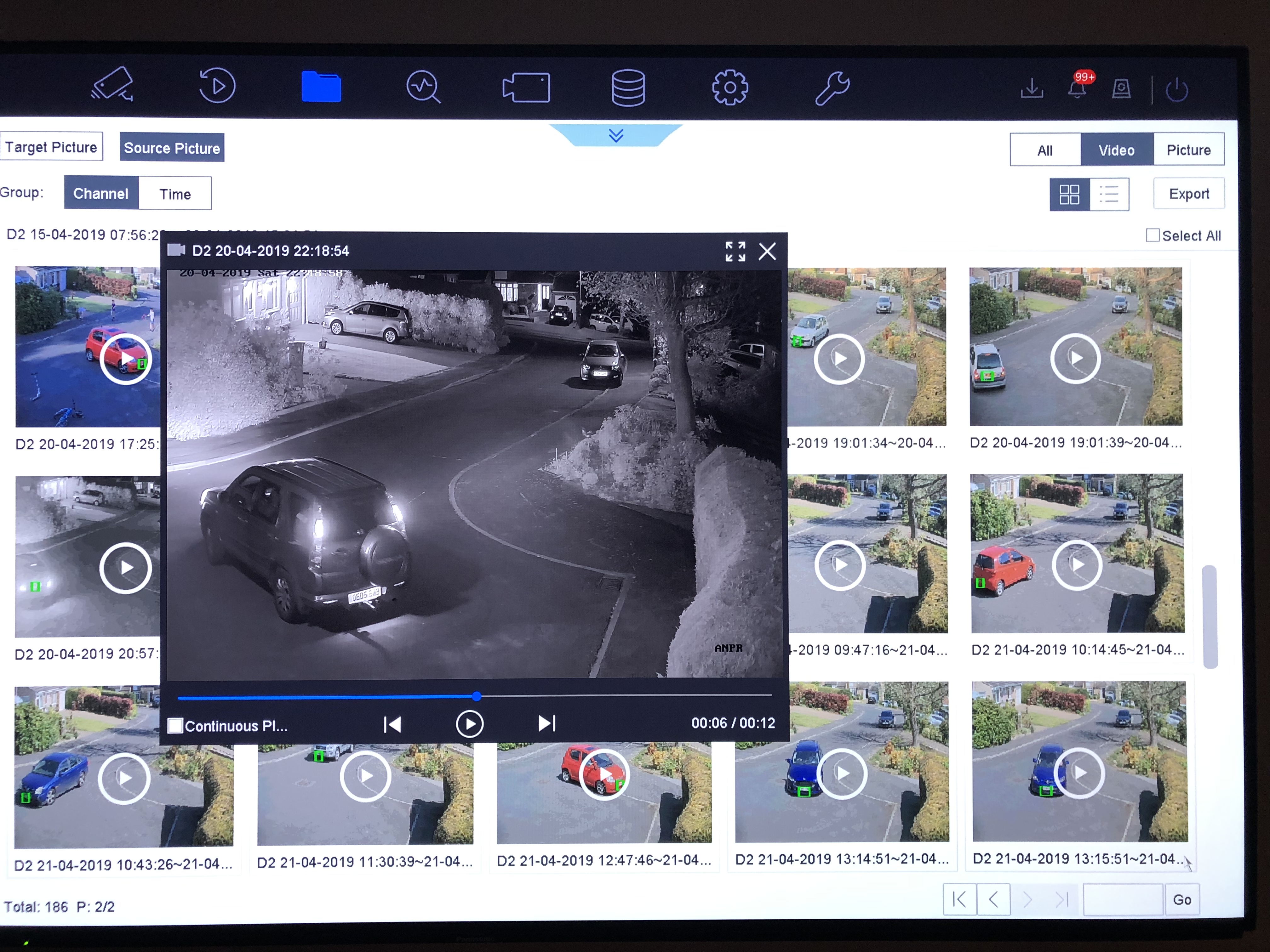

I have no issues with high beams. Its reading all plates right now. Expect for the odd one where it will show a clear picture of the number but will list it incorrectly. i.e 11 together (two ones), will leave it on these settings for now. I doubt I will get a clearer image as ive been through most settings now.
