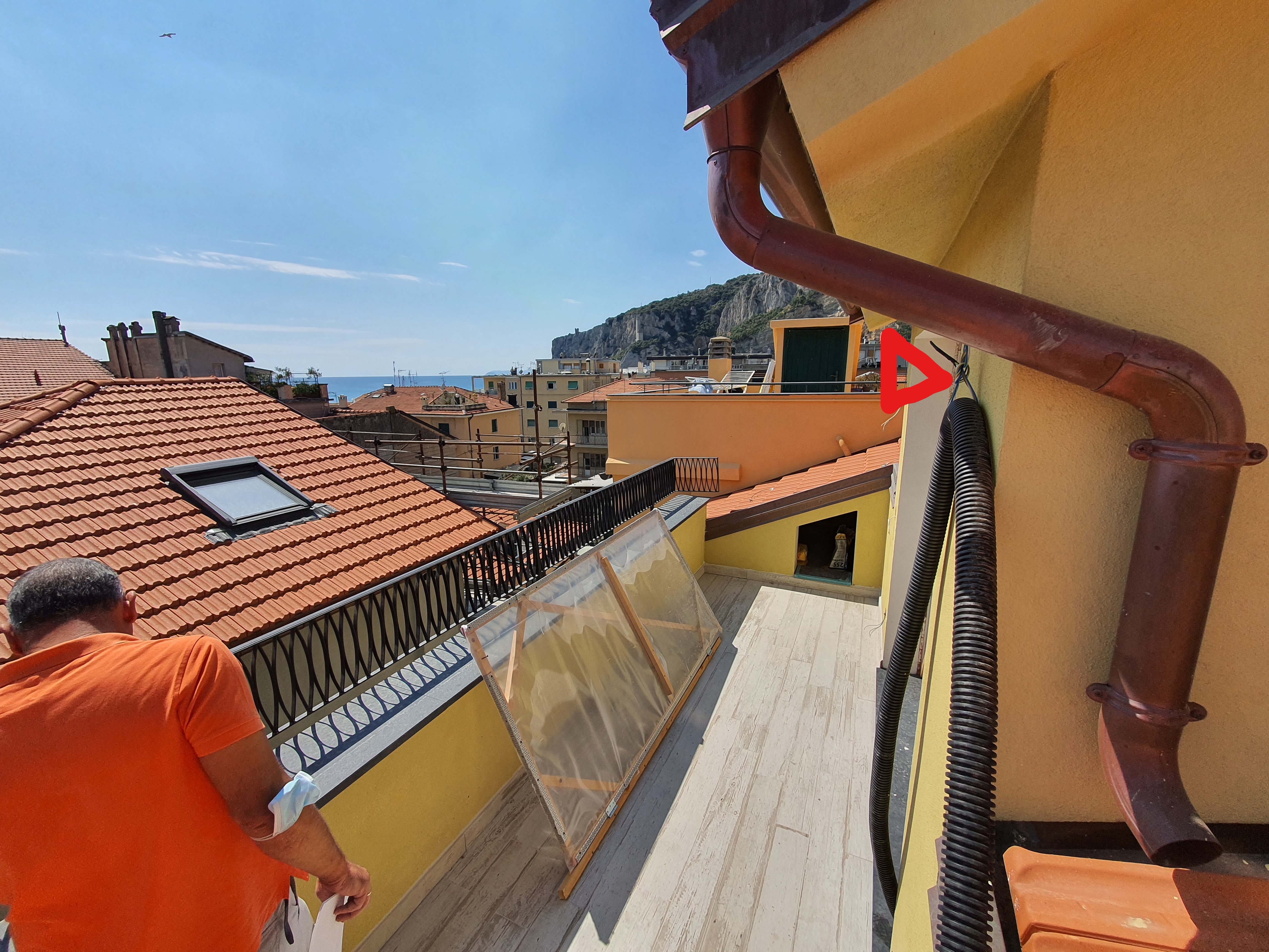

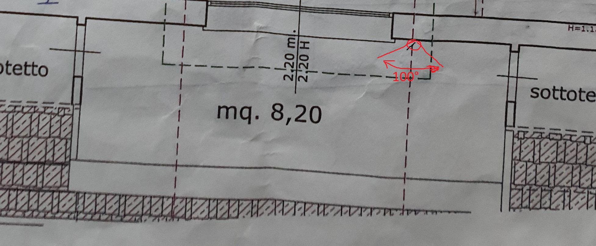

I have selected a 2.8 Degreee because the balcony is 5x1,6 m and with an angle of 100 degrees I should see more or less the whole balcony. ( I attach the pic to show where the camera is supposed to be installed).

VCA is a general bracket term for all the camera's smart functions, for the purpose you describe you would probably be fine just to use intrusion detection or line crossing with minimum & maximum detection sizes set, this means the camera can be set to only trigger on objects that are larger than a cat so as to avoid false triggers.
If the balcony is the primary area you want to cover then yes a 2.8mm lens is the best option to cover that space.
