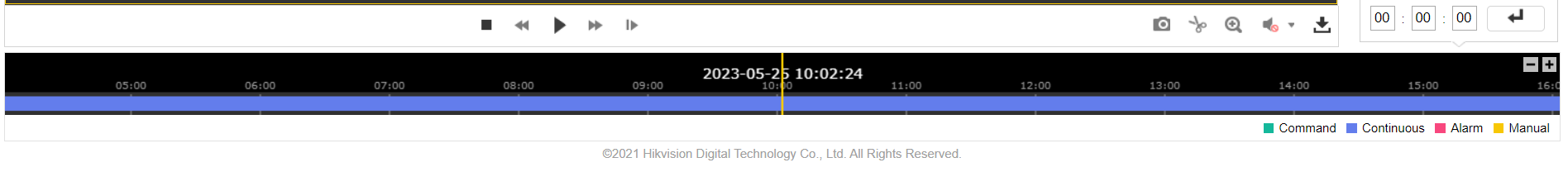

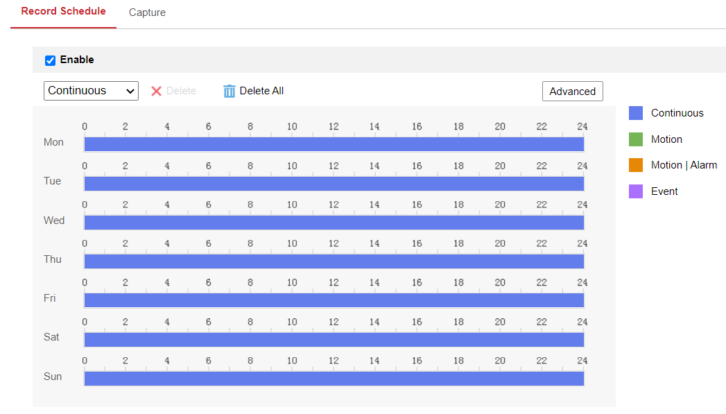

How do I get smart event / alarms to show up on the playback timeline in camera?

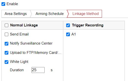

I have a DS-2CD2347G2-LU setup with smart event intrusion detection. It's linked to HikConnect and I receive smart event alerts and recording on the Android app. No NVR.
But when I look at the playback time it's just a solid blue bar, no event markings. Which means I can't find any events unless I match the time with my app.
There must be a way of getting events / alarms to be marked on the playback timeline?

Hi @montydon
I'm afraid that it isn't possible to get the event markers without an NVR, as these only show on an NVR's local interface.
The closest thing available to a standalone is the event playback feature within iVMS-4200, it should all be explained in this post:
